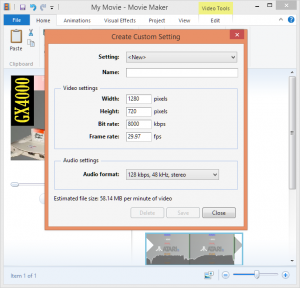

craiganderson Posted March 6, 2014 Author Posted March 6, 2014 ok..almost got it all figured out able to record 60 fps , split/edit and maintain 60fps . but i do not have a way to add AUDIO fade in /fade out without the program decreasing to 30 FPS windows movie maker has a great fade in out option but decrease to 30 fps any ideas? craig http://craigandersonthemes.weebly.com/

craiganderson Posted March 6, 2014 Author Posted March 6, 2014 Actually figured it out. Windows movie maker has.a 60fps option Good to go http://craigandersonthemes.weebly.com/

gigapig Posted March 6, 2014 Posted March 6, 2014 I use Bandicam to capture my guides, but previously used Camstudio which is free. You can also try Afterburner. For my guides I edit with Movie Maker, which is very simple. But for video snaps the resulting video comes out stretched so I switched to Adobe Premiere which has more export options. Like Polemicist says, try to avoid editing.

craiganderson Posted March 6, 2014 Author Posted March 6, 2014 I use Bandicam to capture my guides, but previously used Camstudio which is free. You can also try Afterburner. For my guides I edit with Movie Maker, which is very simple. But for video snaps the resulting video comes out stretched so I switched to Adobe Premiere which has more export options. Like Polemicist says, try to avoid editing. It comes out "stretched" even though you can set the height and width variables? thanks http://craigandersonthemes.weebly.com/

gigapig Posted March 6, 2014 Posted March 6, 2014 It comes out "stretched" even though you can set the height and width variables? thanks That's exactly why I used Premiere. Have you tried changing the project to 4:3, under the project tab?
