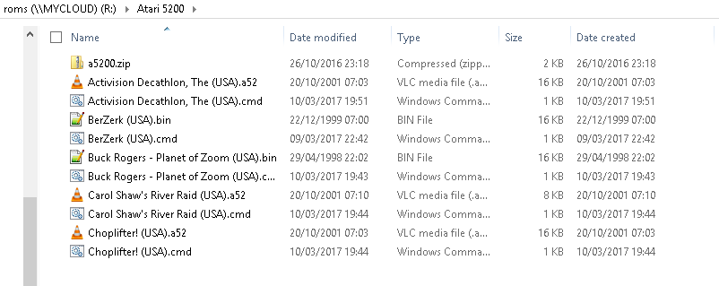

thatman84 Posted March 9, 2017 Posted March 9, 2017 WOOOOOOOP!!!!!!!!! I just loaded an Atari 5200 game with MAME (Arcade) RA core from Hyperspin that is named as per the official Hyperspin xml. NOT using software lists or hash files. In a rom folder named Atari 5200. BUT its 11pm and I got work at 6am so gotta sleep. Its not all good news as this method requires a bunch of text files to be created. I expect someone will come up with a little script easy enough for that. Until I have tested more it could be nothing but I dont think it is. Hyperspin 2.0 Latest Download Hyperspin 2.0 Documentation -------Pre Hyperspin 2.0 Below---------- HS Android Overview & Install HS Android Base Pack Download My Tutorials

thatman84 Posted March 11, 2017 Author Posted March 11, 2017 4 hours ago, sanchezmike01 said: Lemme know what the text file needs and I'll see if I can make a script for it... Tested 5 5200 games last night and all worked. so I expect this is going to work well across the board. (Unzipped roms tested only) the script I could do with would need to do this. 1. Create a text file for every rom in a folder. 1 for each rom 2. The text file needs to be named as the rom name 3. Inside the text file needs to be the name of the rom with the extension inside of quotations. I can then inject the rompath with notepad++ and the system specific MAME command (a5200 -cart) i should be able to do the rest with notepad++ and bulk rename utility. Although I'm not sure how to inject the rompath at a specific point. Bulk rename can change the extension easily for Atari 5200 the format is this inside the text file (specific to my rompath) a5200 -cart "/storage/MYCLOUD/roms/Atari 5200/GAMENAME.EXT" over and above that if the batch could add the rompath and change the extension to .cmd that would be awesome. But it needs to be easily configurable to use for other people's rompaths. the a5200 -cart part will be different for other systems and I would need to find that stuff out but the RocketLauncher MAME.ahk will help there. Hyperspin 2.0 Latest Download Hyperspin 2.0 Documentation -------Pre Hyperspin 2.0 Below---------- HS Android Overview & Install HS Android Base Pack Download My Tutorials
sanchezmike01 Posted March 11, 2017 Posted March 11, 2017 Honestly idk if it's even possible to 2....not only do u need multiple copies of the file (which can be done with a batch script) but u need the files named a certain way and u also need the info in each file different depending on each game.....seems like alot of work will need to be done...for me it's easier 2 rename them according to the xml
thatman84 Posted March 11, 2017 Author Posted March 11, 2017 manually is easier this way than renaming 4 sets of media imho. You also get the benefit of adding other mame commands to lauch with, your not confined to using MAME romsets and finally there is no need for a custom XML. You can use official databases with all the metadata Hyperspin 2.0 Latest Download Hyperspin 2.0 Documentation -------Pre Hyperspin 2.0 Below---------- HS Android Overview & Install HS Android Base Pack Download My Tutorials
sanchezmike01 Posted March 11, 2017 Posted March 11, 2017 When u have time can u link an example file?...would like to test on my phone and how 2 use it...such as when I load core then load content, do I load the text file or the rom I will be testing with... it's a text file not a rom or bios so I beleive it stays within forum rules
thatman84 Posted March 11, 2017 Author Posted March 11, 2017 rom folder structure (CMD files can be anywhere) a5200.zip bios needs to be with roms Command files zipped just extract Atari 5200.zip my ini file. Please use as reference as its customised Atari 5200.ini use the hyperlist xml or any other stndard one Hyperspin 2.0 Latest Download Hyperspin 2.0 Documentation -------Pre Hyperspin 2.0 Below---------- HS Android Overview & Install HS Android Base Pack Download My Tutorials
