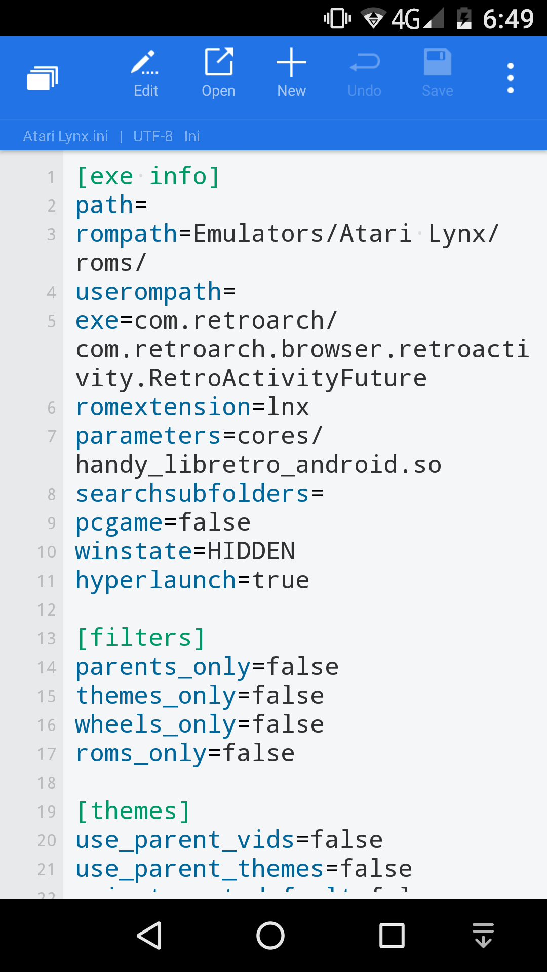

Jawbraeka Posted August 15, 2017 Author Posted August 15, 2017 OK.. So far I am up to configuring ini files.. With the rompath, its says 'please adjust your rompath in any settings files to suit YOUR setup locations. I am changing the rompath to the full hyperspin ROM path, which is /sdcard/hyperspin/emulators/Atari lynx/roms Just a quick question. Do I need to alter the 'path=' setting at all?
