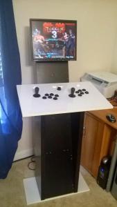

aarondr Posted May 21, 2014 Posted May 21, 2014 I decided to build a cabinet, but I had very little budget for tools and parts. So I took my jig saw, and some spare parts from a desk hutch. Old 17" monitor, cheap ebay controls/encoder (buttons are branded happ, but joysticks are 'happ competition style'), Pentium G3220 + ASRock mobo + 4GB of RAM, old HD, USB powered amplifier (http://www.amazon.com/gp/product/B00C4N410G/ref=oh_details_o02_s00_i00?ie=UTF8&psc=1) powering drivers recycled from $1 garage sale HK computer speakers, Vesa mount (http://www.amazon.com/gp/product/B003O1UYHG/ref=oh_details_o04_s00_i00?ie=UTF8&psc=1), and had to buy a melamine shelf as the base. Someday I might do a nice cabinet, but I wanted to actually play something first. This is space conscience and was fun to recycle parts to a desk hutch that was just going to be thrown out. I don't get a lot of 'shop' hours so this was put together in a very short amount of time. I may fill in some of the shelf holes. The control panel is made from the integrated whiteboard which is metal backed by fiber board. The legs/center piece are hollowed fiberboard, so the entire cabinet is about 50lbs. https://plus.google.com/photos/114555912323326795972/albums/6015958575856443281 I did this first, and had a buddy with a real wood shop do the cuts so it turned out much nicer: https://plus.google.com/photos/114555912323326795972/albums/5998064004391455249?hl=en_US Purists please be gentle - it was a fun project with leftovers :-)

aarondr Posted May 22, 2014 Author Posted May 22, 2014 I love the button layout for p1. I have always been fascinated with button layout since I saw my first candy cab. How does yours play vs the standard? IE it seems skewed, but I don't know how the controller is rotated... It's pretty good. I like the curved layout. The joystick itself is rotated at a slight angle (I think 15 degrees) - so as to have 2 players inside a 24" box and not have both people shoulder fighting while playing.

aarondr Posted May 22, 2014 Author Posted May 22, 2014 I think it looks pretty cool in and of itself.....just like it is.Maybe dress it up a little as u go.....if u want....don't have to I would prefer a slightly larger monitor screen.....but that's just me..... And remember this advice is from someone who has built zero cabs in his life........ Sent from my Droid Mini. Yeah I'd like to find a 19" or larger 4:3/5:4 LCD someday. I have a 23" 16:10 LCD that I might mount up there. I need to get longer screws for the mount though. I have a 2x4 behind the particle board that I screwed the VESA mount into (painted black) but the stud mount screws that the mount came with only made it a tiny amount into the 2x4 (since the particle board piece is about 3x thicker than drywall). I'd feel better about a 12lb monitor on there if I had a bit more bite into the wood.
