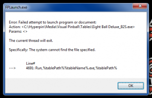

dondon42 Posted July 2, 2012 Posted July 2, 2012 (edited) How do you get B2S tables to exit right, when i added B2S to the end i got this error in Hyperpin: What do I do???? Edited July 2, 2012 by dondon42

blur Posted July 3, 2012 Posted July 3, 2012 How do you get B2S tables to exit right, when i added B2S to the end i got this error in Hyperpin:[ATTACH=CONFIG]17604[/ATTACH] What do I do???? As you already know from FPLaunch manual: Warning: To use B2S tables with FPLaunch you have to let FPLaunch start and close the backglass. To do this change table name so that it ends with B2S and rename B2S exe to the same name. Also edit every B2S table and change launch backglass to false in table script. And from the message I would say that you don't have that exe file, fplaunch is trying to launch. My paper cab core.vbs with better nudge FPLaunch with exit menu, instructions, flyer VP with support for analog nudge and plunger with any gamepad www.submania.hr www.phoenixmarine.hr rent-a-boat-rab.com bootsvermietung-rab.com
