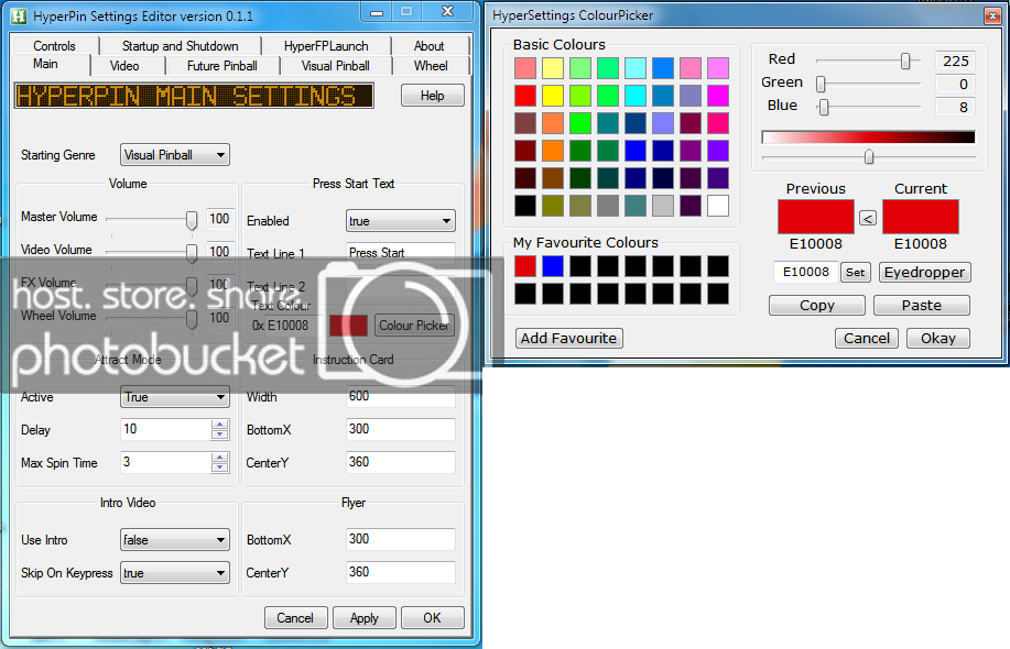

I have noticed that if you click on the tab controls and press set a key,the key number is not there so when you click apply it saves it and there is no key for that key now..
I bet this is known about already or is it just doing it to me..?
Pic so you know what i am taking about..
