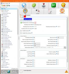

Bootleg Posted August 2, 2016 Posted August 2, 2016 my ahk file shows up red in the module table i think i broke it am i doing something wrong i was told in the rocket launcher ui tab u can update it but it doesnt seem to be working for me never mind thanks i figured it out i didnt see the update icon at the top of the rocket launcher tab lol
gigapig Posted August 2, 2016 Posted August 2, 2016 my ahk file shows up red in the module table i think i broke it am i doing something wrong i was told in the rocket launcher ui tab u can update it but it doesnt seem to be working for me It will show up with an exclamation if you have edited the module or you have a duplicate module in the folder. If you want to use the module you have modified then you can remove the exclamation. If you want to acquire a fresh copy of the module, remove the old one from the folder (I recommend moving it instead of deleting until you get the new one) fire up RLUI and if it doesn't do it automatically the do it manually by clicking the button as shown below.
