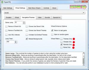

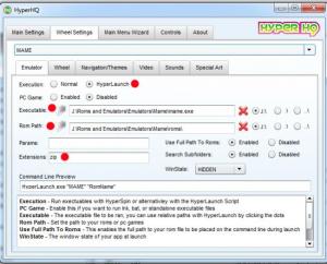

gigapig Posted June 25, 2014 Posted June 25, 2014 In hyperspin as soon as I pick Mame it crashes hyperspin, no mame loading up. That may be a HyperHQ issue, if you've not added something correctly. Here's a screen shot of mine with areas of interest marked. And here, perhaps start off with no check boxes checked, these filter the wheel, so if you have Roms Only checked and you haven't put the path to your Roms in (see above screen) then Hyperspin will fail. Remember HyperHQ is the GUI for Hyperspin and Hyperlaunch HQ is the GUI for Hyperlaunch.
seph Posted June 25, 2014 Author Posted June 25, 2014 Thank you, you are right. I did not set up the rom path correctly.
