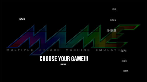

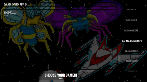

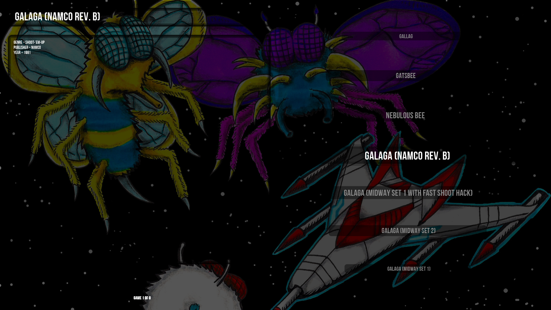

Creezz67 Posted December 14, 2022 Posted December 14, 2022 23 minutes ago, r0man0 said: Yes Creezz67 , that's interesting me , but how can i show the real title of the rom (description) instead of the Mame rom name into clone menu selection , does the ini need another entry ? Thank you for subscribtion , for the moment no more vids , just updating mame xml full lists into my website , I have to update handheld package , but i 'm waiting for an update of artworks from progetto snaps , ... so wait and see Like this you mean ?

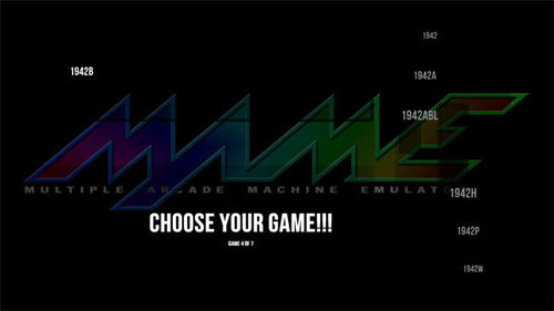

Creezz67 Posted December 14, 2022 Posted December 14, 2022 1 minute ago, r0man0 said: Yes , like this You say you use split MAME set ? Above image is using split set, but I just tried merged set and it only shows 1942a, 1942p etc
r0man0 Posted December 14, 2022 Posted December 14, 2022 5 minutes ago, Creezz67 said: You say you use split MAME set ? Above image is using split set, but I just tried merged set and it only shows 1942a, 1942p etc Yes i use Split set, and it shows like you in merged set : 1942a,1942p etc... That's may be an option or something like that,but i don't see witch one

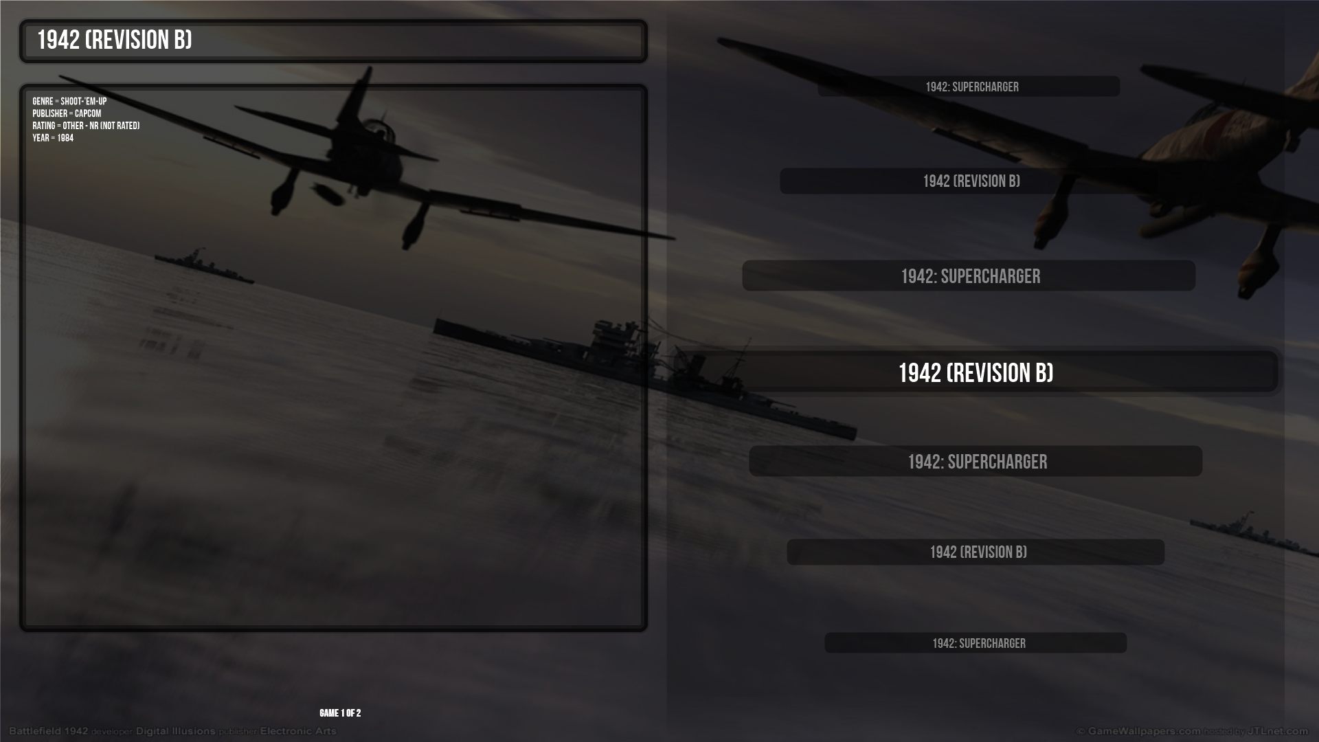

Creezz67 Posted December 14, 2022 Posted December 14, 2022 49 minutes ago, r0man0 said: Yes i use Split set, and it shows like you in merged set : 1942a,1942p etc... That's may be an option or something like that,but i don't see witch one I have your xml working now, but I needed to download the MAME merged set to get it to work and also show the names correctly. It now shows ALL the clones rather than just 1 or 2 for each game. Also the column width needs to be widened in Rocketlauncher rom mapping settings to show full name Do you have a full MAME 0.250 xml without clones on it ? SEE MAME SETTINGS BELOW USING MERGED ROMSET 0.250

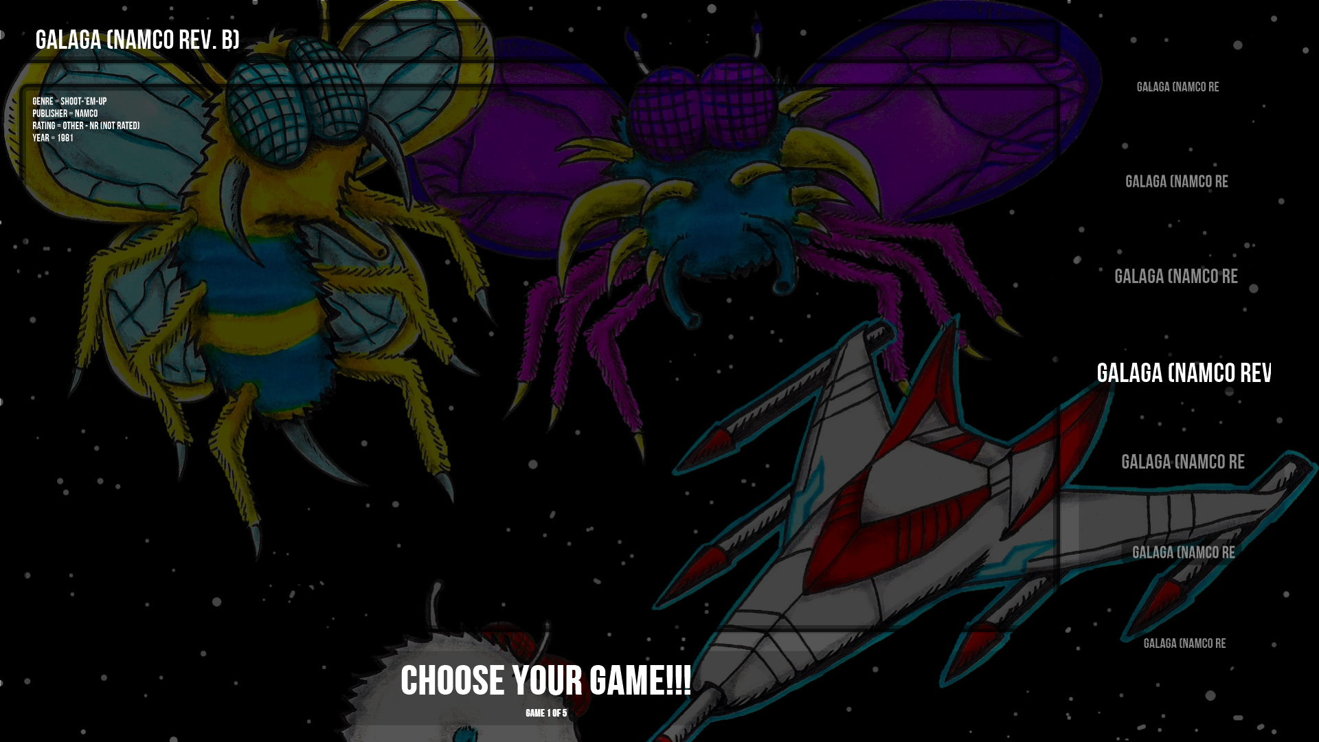

r0man0 Posted December 14, 2022 Posted December 14, 2022 I've an full 0.250 mame list with clones xml, i've tryied to set Menu width from 400 to 800 but still showing the rom name instead of rom description

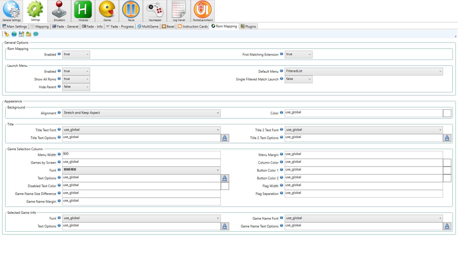

Creezz67 Posted December 14, 2022 Posted December 14, 2022 20 hours ago, r0man0 said: I've an full 0.250 mame list with clones xml, i've tryied to set Menu width from 400 to 800 but still showing the rom name instead of rom description Did you see my settings above ?
r0man0 Posted December 14, 2022 Posted December 14, 2022 20 minutes ago, Creezz67 said: Did you see my settings above ? I've set as yours rom mapping settings but same thing : no title with description , i've tryied with the original module , but same thing !
Creezz67 Posted December 14, 2022 Posted December 14, 2022 19 hours ago, r0man0 said: I've set as yours rom mapping settings but same thing : no title with description , i've tryied with the original module , but same thing ! are you using merged romset ? replace your split set 1942.zip with this merged 1942.zip rom just to test and see if names show correctly. PS, Set you skip checks to rom extension for the test in Rocketlauncher
r0man0 Posted December 14, 2022 Posted December 14, 2022 I've tryied you're 1942.zip instead of my set, and still no description ,the games runs well but my rom mapping menu is not very interesting... maybe if somebody have the same issue and have solve the problem , tell me how ?

Creezz67 Posted December 14, 2022 Posted December 14, 2022 18 hours ago, r0man0 said: Yes RL & Hyperspin in admin Here is my global settings, just in case some of your global settings for MAME are different
r0man0 Posted December 14, 2022 Posted December 14, 2022 I've set exactly as yours , (global & mame rom mapping settings) , but exept size and columns , nothing change (no description)
Creezz67 Posted December 14, 2022 Posted December 14, 2022 3 minutes ago, r0man0 said: I've set exactly as yours , (global & mame rom mapping settings) , but exept size and columns , nothing change (no description) post your main settings screen ?
