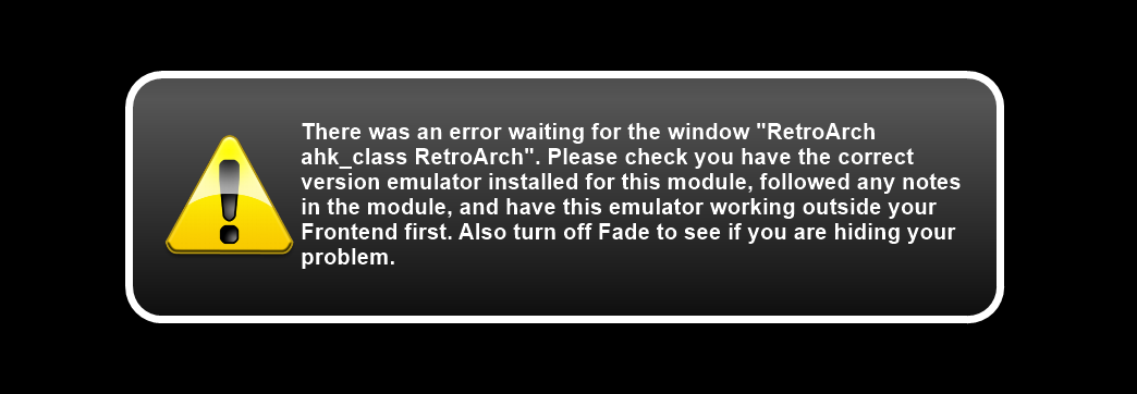

floatingyeti Posted December 23, 2022 Author Posted December 23, 2022 2 minutes ago, Creezz67 said: Just so I know if I am doing something wrong, can you load up alienfnt using this rom mapping ? when I try it throws an error. Thanks Was using the outdated xml from hyperlist to test for Romano. Someone probably uploaded a better one. The one I'm using has all the clones removed and is a cropped list of only RetroArch (Flycast compatible) games.
Creezz67 Posted December 23, 2022 Posted December 23, 2022 9 minutes ago, floatingyeti said: thats true for 25pacman because its a bad dump 25pacmano is the working clone kof2000, burnforc, and alexkidd are all parents (and a more resent version or set) than those clone versions Since all three of those only have one older version clone, i suggest getting the non-merged version of them They will load with no issue. just replace only those three and you can keep using your merged set. Thanks, I just tested a non merged version and as you say it loads fine. I have gone from spending 10 years only using a split set of roms, to merged ..... and now it looks like I am going to go to non merged !!!! I think just for updating in future it will be better for me just to replace my entire merged set with non merged. Thanks for info

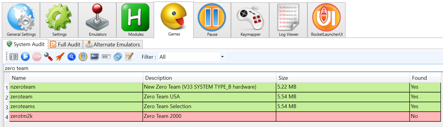

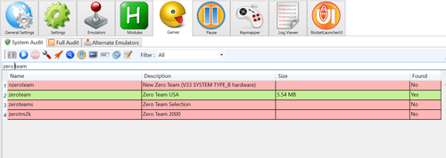

floatingyeti Posted December 23, 2022 Author Posted December 23, 2022 14 hours ago, Creezz67 said: FYI, Non merged set do NOT work with Roman0's rom mapping ini files. I have now tried 6 different systems and all of them just bring up one single rom, instead of all the clones. When they are switched back to merged roms all working again. Only a MERGED MAME romset will work with his ini files. There is nothing wrong with Romanos ini or the app that generates them. This is more an issue with Rocketlauncher and it not having the versatility (Rom Mapping) required to make this process user-friendly I have tested on merged/nonmerged/split and it works I am attempting to replicate the issue you are encountering (using non-merged) but I'm unable to. There will only be an issue (with any romset option) if clones are not present within the parent rom (merged) or individually (split or non-merged) Let's look at Zeroteam for example Using Romanos ini and non-merged set: All non-merged parent/clones are present and the list is generated (all games launch) here are my RM settings: This will work with "First Matching Extension" set to "True" or "False" So Non-merged (in this scenario) works Obviously, I can't dismiss the issues you are experiencing so let's go over a scenario where non-merged rom mapping doesn't work. Here's what happens if non-merged zeroteam is present, but the non-merged clones are removed: It crashes! Using MAME 0.250 it never gets past the Fade screen. I waited 5 minutes and there wasn't even an eventual error message. I couldn't even "end process". Using RetroArch (MAME 0.250) it at least crashed to an error message and didn't completely lockup my PC. It has nothing to do with the database or Romano's ini file (it is correct). This behavior or (Rocket Launcher) bug will occur with non-merged or split set if all clones are not present. It's not so much an issue with the split set because most people would have the entire set in their rom folder I do think it's a flaw (that should be fix by RL devs) for the non-merged set. One of the best features of the non-merged set is that all roms are "portable" and you can have a functional incomplete romset if you choose. But there still is some versatility. Rom Mapping will work (non-merged) if it can find at least one listed clone. Let's look at zeroteam again with one clone removed from roms folder: And it does work (with one less clone displayed) Creezz67 were you testing only the non-merged parent rom without the non-merged clones in your rom folder? I do think you should continue using the merged set because it is working for you, and you prefer it. Sorry for the long explanation, I just didn't want anyone reading the thread to think that non-merged doesn't work with Rom Mapping. I can't say it's the "best" option (it's purely subjective), but I do feel the need to document it as a usable option.

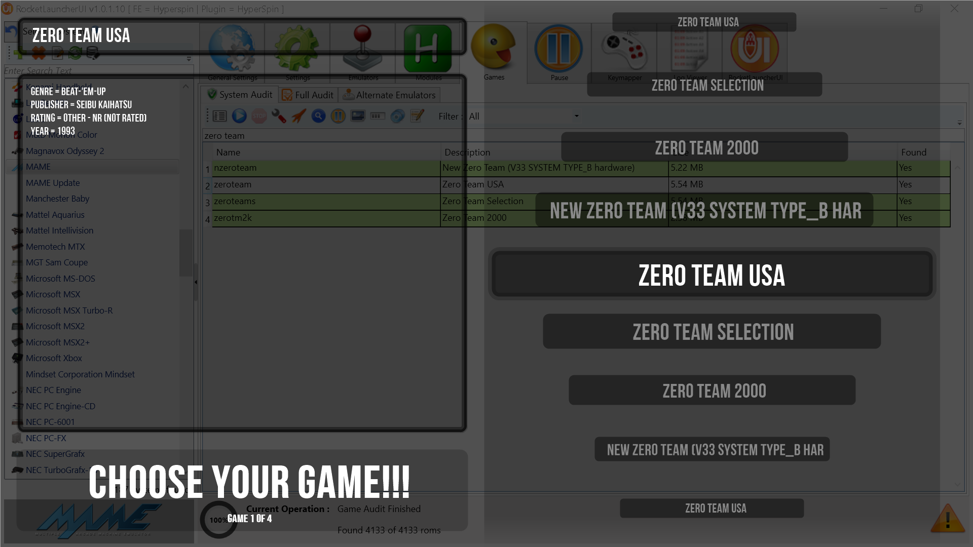

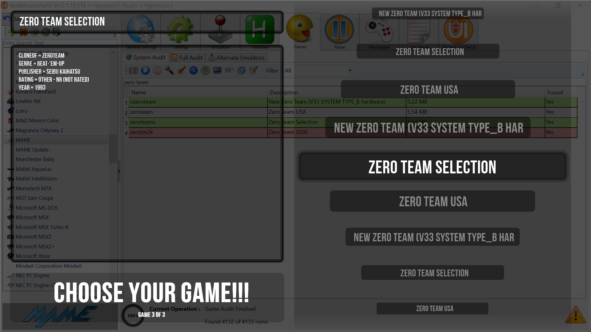

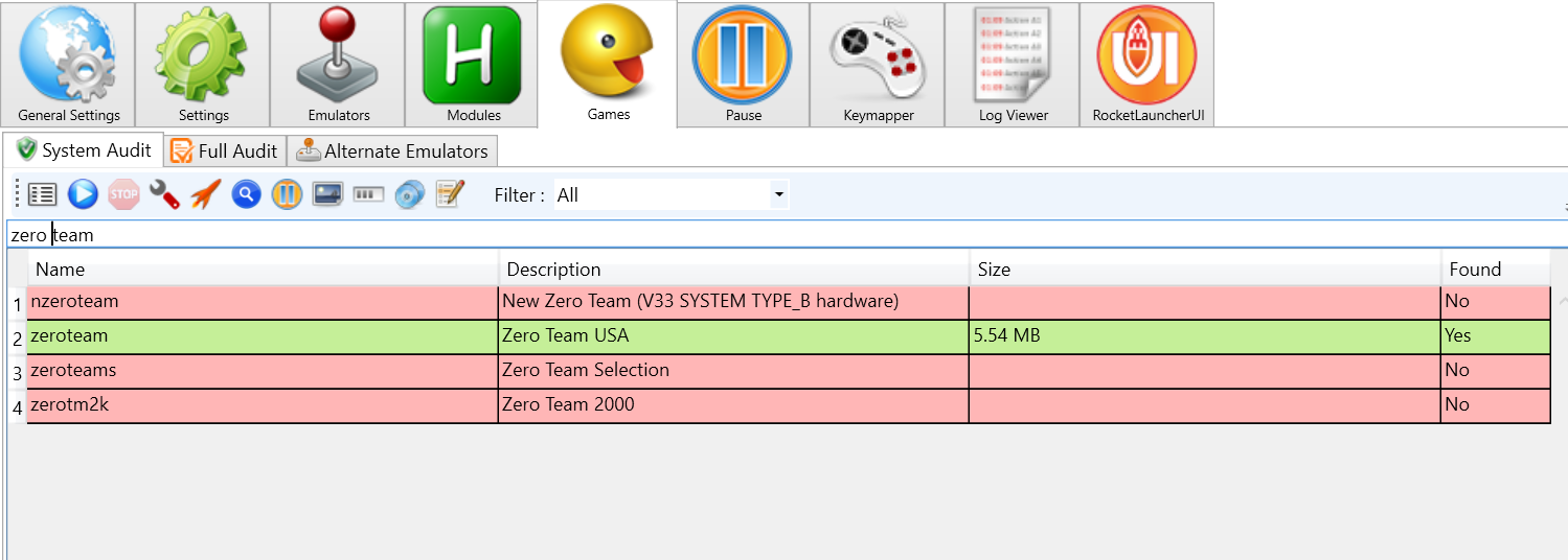

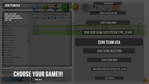

floatingyeti Posted December 24, 2022 Author Posted December 24, 2022 Has anyone else reading this thread tried Rom Mapping with MAME? I know Creezz67 and Romano have successful used it? Romano's ini tool has made it more accessible and I'm sure Creez67's enthusiasm (and screenshots with artwork) have convinced someone to try RM. I don't expect everyone to use it, but I would like to know if it's reaching more people.

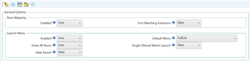

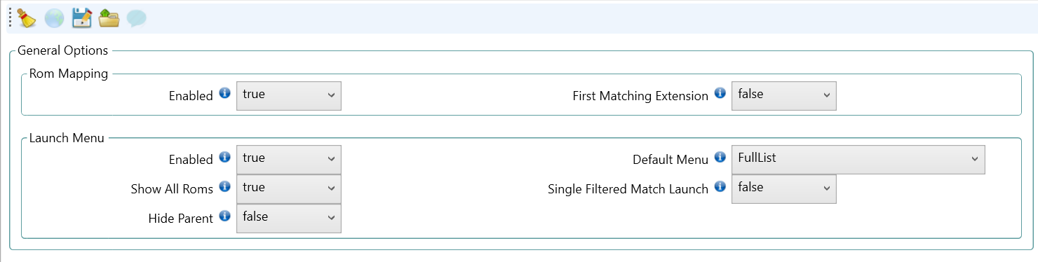

Creezz67 Posted December 24, 2022 Posted December 24, 2022 17 hours ago, floatingyeti said: There is nothing wrong with Romanos ini or the app that generates them. This is more an issue with Rocketlauncher and it not having the versatility (Rom Mapping) required to make this process user-friendly I have tested on merged/nonmerged/split and it works I am attempting to replicate the issue you are encountering (using non-merged) but I'm unable to. There will only be an issue (with any romset option) if clones are not present within the parent rom (merged) or individually (split or non-merged) Let's look at Zeroteam for example Using Romanos ini and non-merged set: All non-merged parent/clones are present and the list is generated (all games launch) here are my RM settings: This will work with "First Matching Extension" set to "True" or "False" So Non-merged (in this scenario) works Obviously, I can't dismiss the issues you are experiencing so let's go over a scenario where non-merged rom mapping doesn't work. Here's what happens if non-merged zeroteam is present, but the non-merged clones are removed: It crashes! Using MAME 0.250 it never gets past the Fade screen. I waited 5 minutes and there wasn't even an eventual error message. I couldn't even "end process". Using RetroArch (MAME 0.250) it at least crashed to an error message and didn't completely lockup my PC. It has nothing to do with the database or Romano's ini file (it is correct). This behavior or (Rocket Launcher) bug will occur with non-merged or split set if all clones are not present. It's not so much an issue with the split set because most people would have the entire set in their rom folder I do think it's a flaw (that should be fix by RL devs) for the non-merged set. One of the best features of the non-merged set is that all roms are "portable" and you can have a functional incomplete romset if you choose. But there still is some versatility. Rom Mapping will work (non-merged) if it can find at least one listed clone. Let's look at zeroteam again with one clone removed from roms folder: And it does work (with one less clone displayed) Creezz67 were you testing only the non-merged parent rom without the non-merged clones in your rom folder? I do think you should continue using the merged set because it is working for you, and you prefer it. Sorry for the long explanation, I just didn't want anyone reading the thread to think that non-merged doesn't work with Rom Mapping. I can't say it's the "best" option (it's purely subjective), but I do feel the need to document it as a usable option. This is what I get using non merged romset and Romano's ini, with your settings: As you can see I have a full 0.250 non merged set with bios files and all zeroteam clones are present.
Creezz67 Posted December 24, 2022 Posted December 24, 2022 17 hours ago, floatingyeti said: There is nothing wrong with Romanos ini or the app that generates them. This is more an issue with Rocketlauncher and it not having the versatility (Rom Mapping) required to make this process user-friendly I have tested on merged/nonmerged/split and it works I am attempting to replicate the issue you are encountering (using non-merged) but I'm unable to. There will only be an issue (with any romset option) if clones are not present within the parent rom (merged) or individually (split or non-merged) Let's look at Zeroteam for example Using Romanos ini and non-merged set: All non-merged parent/clones are present and the list is generated (all games launch) here are my RM settings: This will work with "First Matching Extension" set to "True" or "False" So Non-merged (in this scenario) works Obviously, I can't dismiss the issues you are experiencing so let's go over a scenario where non-merged rom mapping doesn't work. Here's what happens if non-merged zeroteam is present, but the non-merged clones are removed: It crashes! Using MAME 0.250 it never gets past the Fade screen. I waited 5 minutes and there wasn't even an eventual error message. I couldn't even "end process". Using RetroArch (MAME 0.250) it at least crashed to an error message and didn't completely lockup my PC. It has nothing to do with the database or Romano's ini file (it is correct). This behavior or (Rocket Launcher) bug will occur with non-merged or split set if all clones are not present. It's not so much an issue with the split set because most people would have the entire set in their rom folder I do think it's a flaw (that should be fix by RL devs) for the non-merged set. One of the best features of the non-merged set is that all roms are "portable" and you can have a functional incomplete romset if you choose. But there still is some versatility. Rom Mapping will work (non-merged) if it can find at least one listed clone. Let's look at zeroteam again with one clone removed from roms folder: And it does work (with one less clone displayed) Creezz67 were you testing only the non-merged parent rom without the non-merged clones in your rom folder? I do think you should continue using the merged set because it is working for you, and you prefer it. Sorry for the long explanation, I just didn't want anyone reading the thread to think that non-merged doesn't work with Rom Mapping. I can't say it's the "best" option (it's purely subjective), but I do feel the need to document it as a usable option. Now I have found something else. When using all your settings and exactly the same non merged romset, if the game ONLY has 1 clone it shows up correctly (see 3stooges below) and works. If there is more than 1 it will not work for me and shows a list of all the same roms like above. Strangely, on my merged set, every game that has MORE than 1 clone works fine, but any that has just 1 doesn't work unless I manually create a clone for it.
floatingyeti Posted December 24, 2022 Author Posted December 24, 2022 10 minutes ago, Creezz67 said: This is what I get using non merged romset and Romano's ini, with your settings: Are you using a database that only contains the parent and not the clones? Rocketlauncher launcher has to pull clone description info from a database. I don't know if it pulls info from the database in Hyperspin/Database or RocketlauncherUI database while HS is running (probably HS since it us active plugin) I always keep identical databases in both folders. I know it will use RocketlauncherUI database info because it will also work without Hyperspin running.
