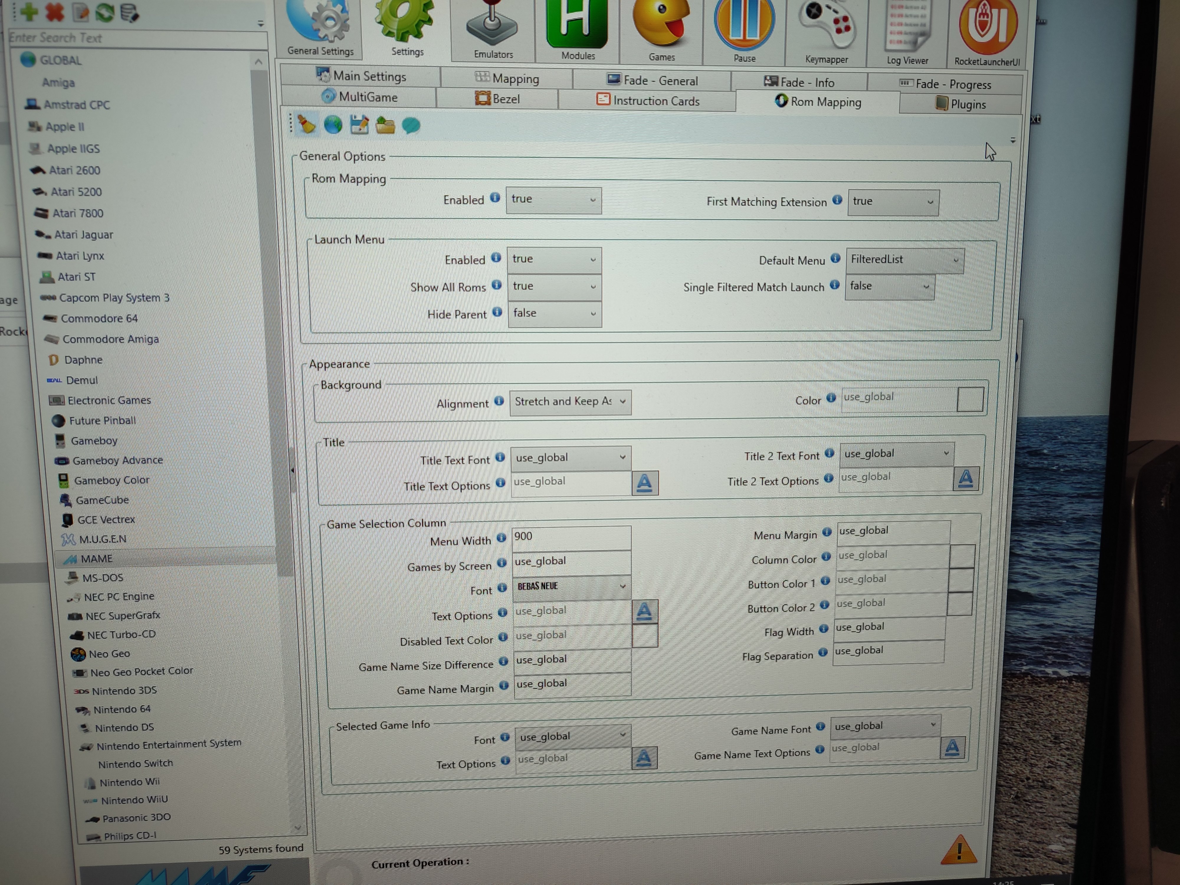

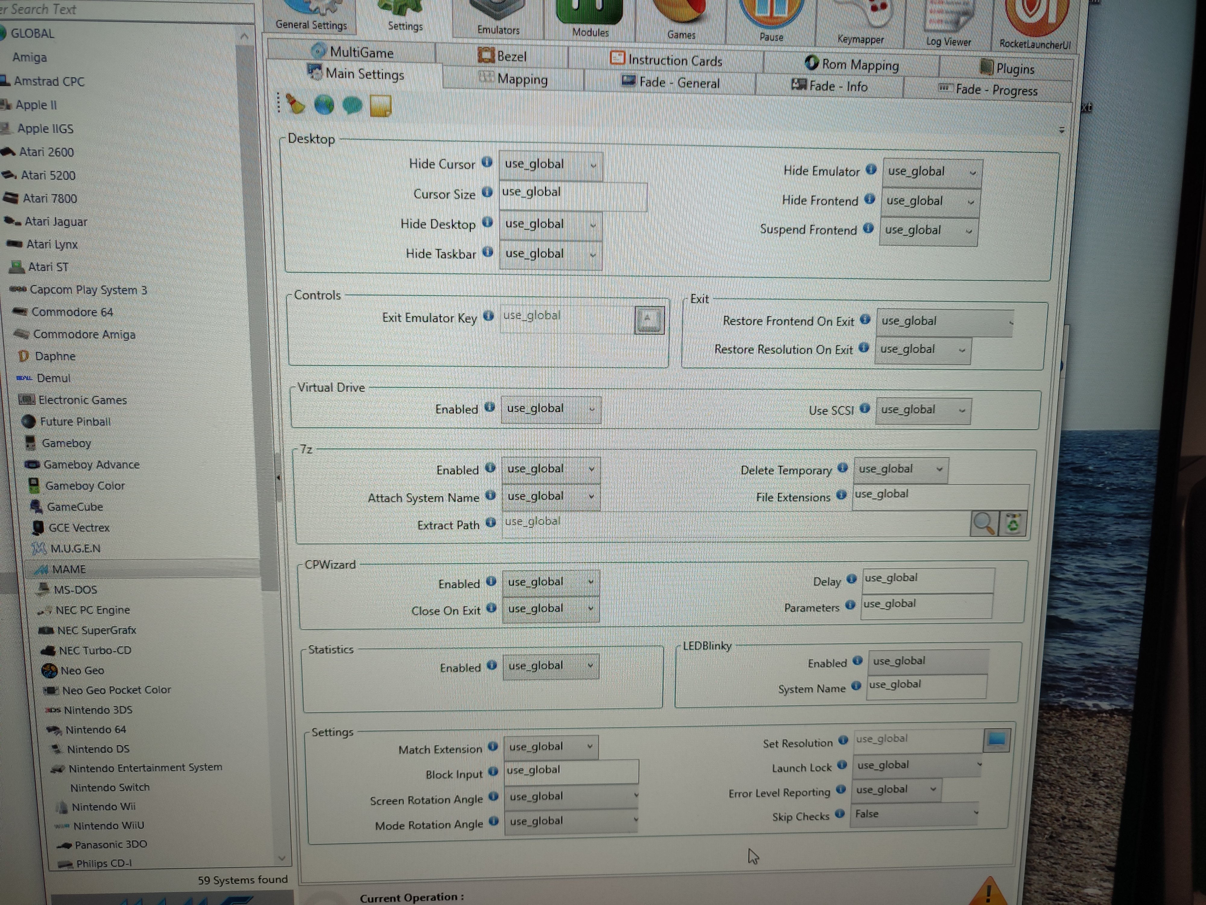

Creezz67 Posted December 14, 2022 Posted December 14, 2022 18 hours ago, Creezz67 said: post your main settings screen ? 18 hours ago, r0man0 said: I've set exactly as yours , (global & mame rom mapping settings) , but exept size and columns , nothing change (no description)
r0man0 Posted December 14, 2022 Posted December 14, 2022 Main settings for mame Rom mapping settings for mame :
Creezz67 Posted December 14, 2022 Posted December 14, 2022 18 hours ago, r0man0 said: Main settings for mame Rom mapping settings for mame :

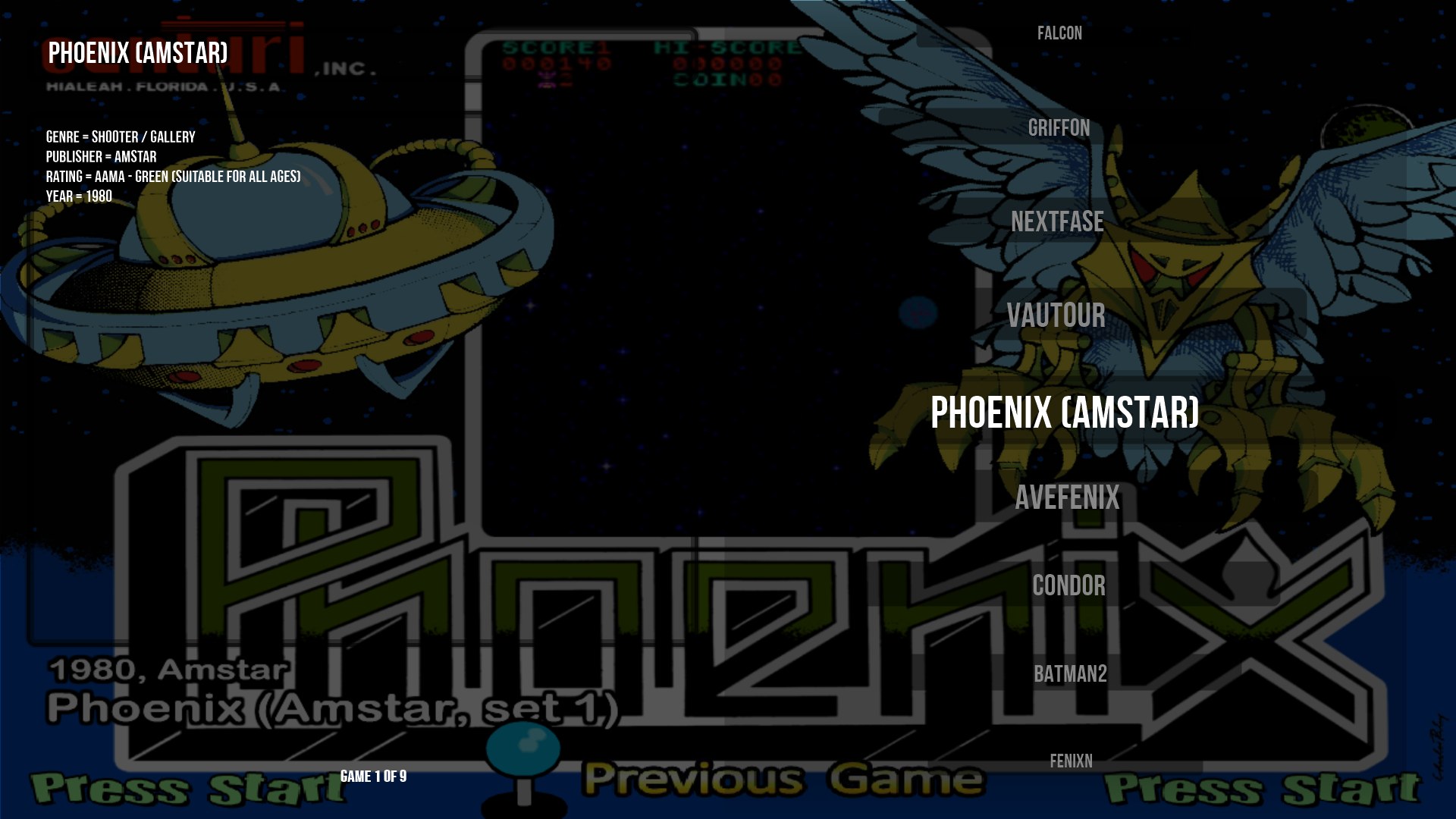

r0man0 Posted December 14, 2022 Posted December 14, 2022 47 minutes ago, floatingyeti said: Sorry but that feature is not in the Rom Mapping yet. All you can do is display a background. It is frustrating because wheel support and full (clone) description info should be implemented. For me it doesn't works of course , but i want to know why Creez67 have this rom mapping menu : There is the description , genre , year and not rom name for its rom mapping menu so How is it possible , that's my question !
floatingyeti Posted December 14, 2022 Author Posted December 14, 2022 4 minutes ago, r0man0 said: There is the description , genre , year and not rom name for its rom mapping menu so How is it possible , that's my question ! It's the current limitation of Rom Mapping menu. The description, genre, and year with only show on the parent rom. We can't "fix" this.

floatingyeti Posted December 15, 2022 Author Posted December 15, 2022 41 minutes ago, Creezz67 said: No, I am using your MAME clones 0.250.ini I fixed my ini file and uploaded a new version. It only displays the filtered list of "worthwhile" clones that Milansoft and I have researched. r0man0's ini is also functional and I appreciate it (I requested it). I thought that the ini file would only display the clones found in my database but r0man0's ini will display every clone in the mame romset.
Creezz67 Posted December 15, 2022 Posted December 15, 2022 5 minutes ago, floatingyeti said: I fixed my ini file and uploaded a new version. It only displays the filtered list of "worthwhile" clones that Milansoft and I have researched. r0man0's ini displays every clone in the mame romset. Hi, I will try you new ini as the previous one was not working on many games, or just showing 1 clone maximum on games even when there were say 10.
floatingyeti Posted December 15, 2022 Author Posted December 15, 2022 15 minutes ago, Creezz67 said: I will try you new ini as the previous one was not working on many games, or just showing 1 clone maximum on games even when there were say 10. I fixed the games that wouldn't launch the rom mapping menu. You might want to keep using r0man0's ini to see the maximum amount of clones. It just comes down to personal preference. I wanted to explain the difference between the two inis. I can maintain/update both ini files each month to provide the option of RM complete or filtered clone set.

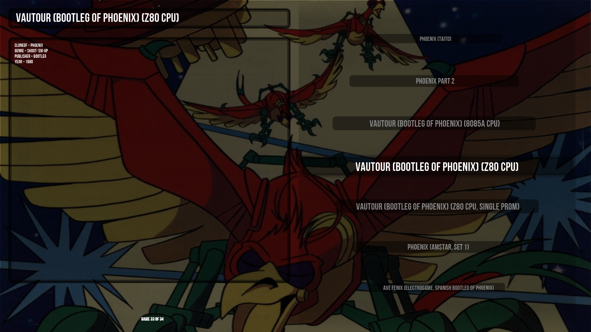

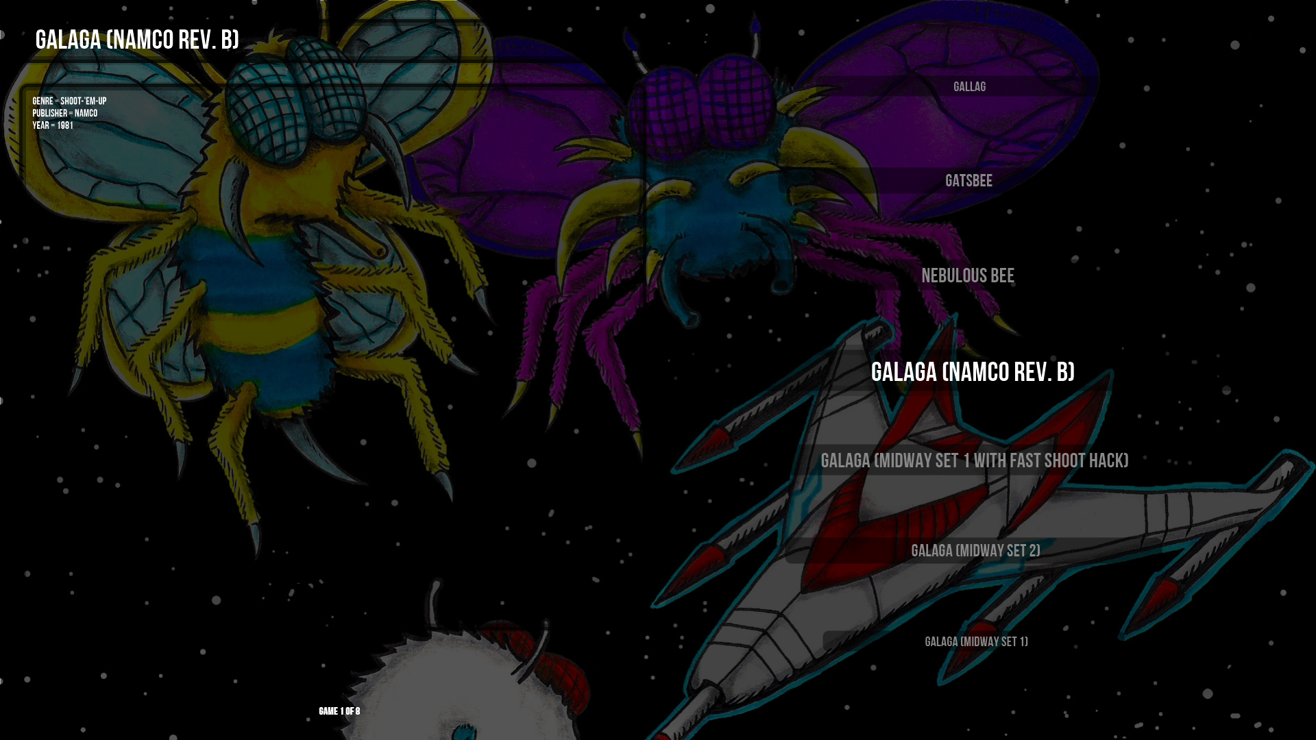

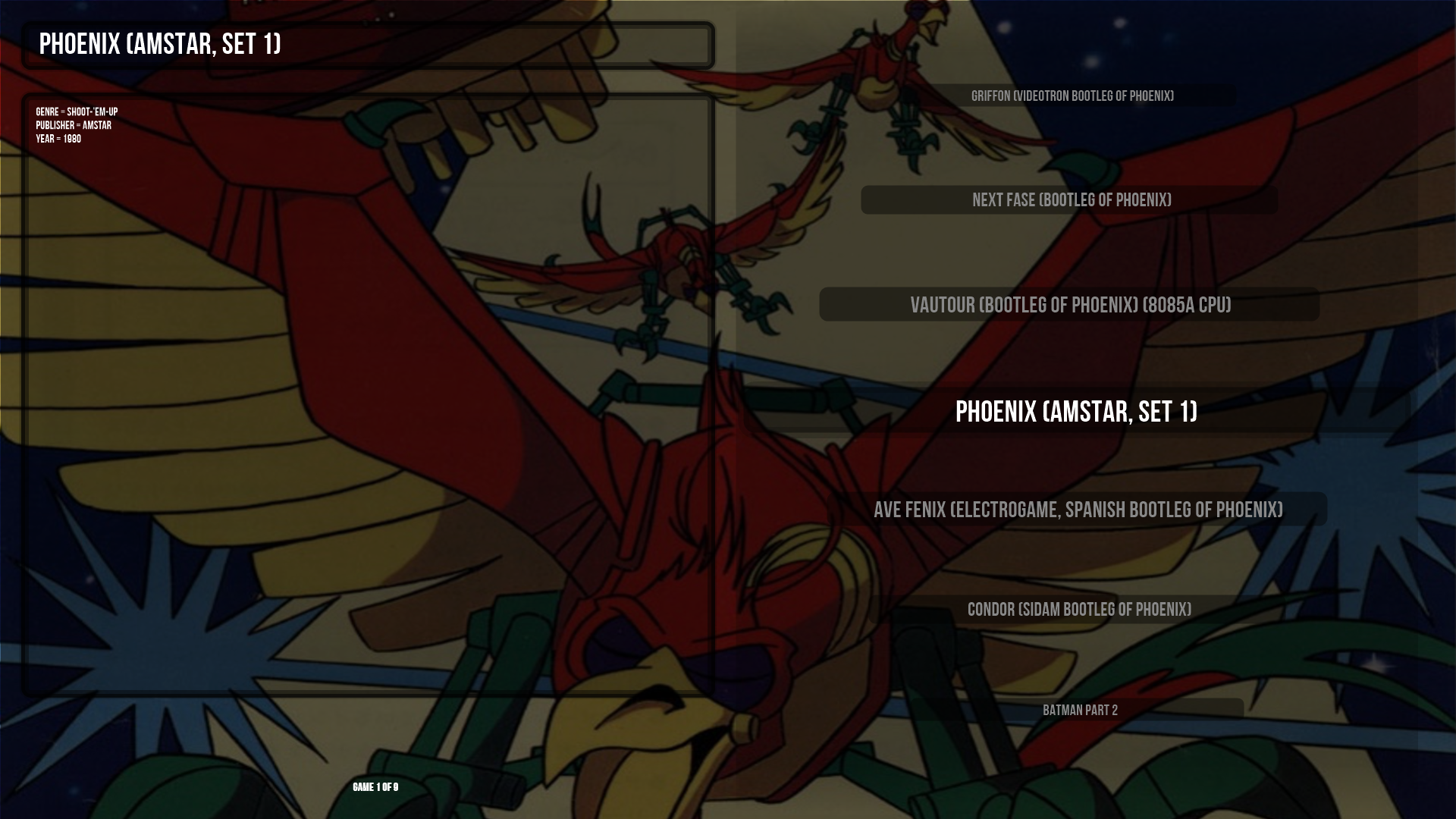

Creezz67 Posted December 15, 2022 Posted December 15, 2022 23 minutes ago, floatingyeti said: I fixed my ini file and uploaded a new version. It only displays the filtered list of "worthwhile" clones that Milansoft and I have researched. r0man0's ini displays every clone in the mame romset. Your ini file works fine now, but it will not show the clone names correctly with the xml you are using. see attached to see what I mean (top one is using my xml, bottom is using yours)
Creezz67 Posted December 15, 2022 Posted December 15, 2022 5 minutes ago, floatingyeti said: I fixed the games that wouldn't launch the rom mapping menu. You might want to keep using r0man0's ini to see the maximum amount of clones. It just comes down to personal preference. I wanted to explain the difference between the two inis. It's not the ini that's the problem, it's the xml. Try using a FULL xml (all games) for 0.250 from Romano and it will show all game clone names rather than the rom names. The xml is irrelevant to your setup as you are using wheels only and parents only etc
floatingyeti Posted December 15, 2022 Author Posted December 15, 2022 Interesting, and confusing, because I am using a modified version of r0man0's 0.249 database. Can you upload the xml you are using? I will compare them and see what the difference is.
Creezz67 Posted December 15, 2022 Posted December 15, 2022 8 minutes ago, floatingyeti said: Interesting, and confusing, because I am using a modified version of r0man0's 0.249 database. Can you upload the xml you are using? I will compare them and see what the difference is. This is the FULL MAME.xml that includes ALL games, not just working games. This will be fine though for this setup because you are using wheels only so it will only ever look for the working games you ask it to, plus it will give you the names of all the clones. MAME full games 0.250.xml
Creezz67 Posted December 15, 2022 Posted December 15, 2022 28 minutes ago, floatingyeti said: Interesting, and confusing, because I am using a modified version of r0man0's 0.249 database. Can you upload the xml you are using? I will compare them and see what the difference is. Also see Phoenix for example using full clone list Romano sent (34 clones instead of 9) Keep in mind I am using a merged set to get 34 clones.
floatingyeti Posted December 15, 2022 Author Posted December 15, 2022 2 minutes ago, Creezz67 said: All see Phoenix for example using full clone list Romano sent (34 clones instead of 9) Yes Romano's will display every clone. My ini will only show a filtered list of "worthy" clones. Both are correct. I was trying to point out that my ini file is filtered. It matches my database of parents and worthy clones (The purpose of my project) It looks like you prefer to see every clone on the list. You should use Romano's file. I'm not using the full working 0.250, I'm using my custom database. My whole project and future updates (And Missing Themes Project) are structured around my ongoing custom database.

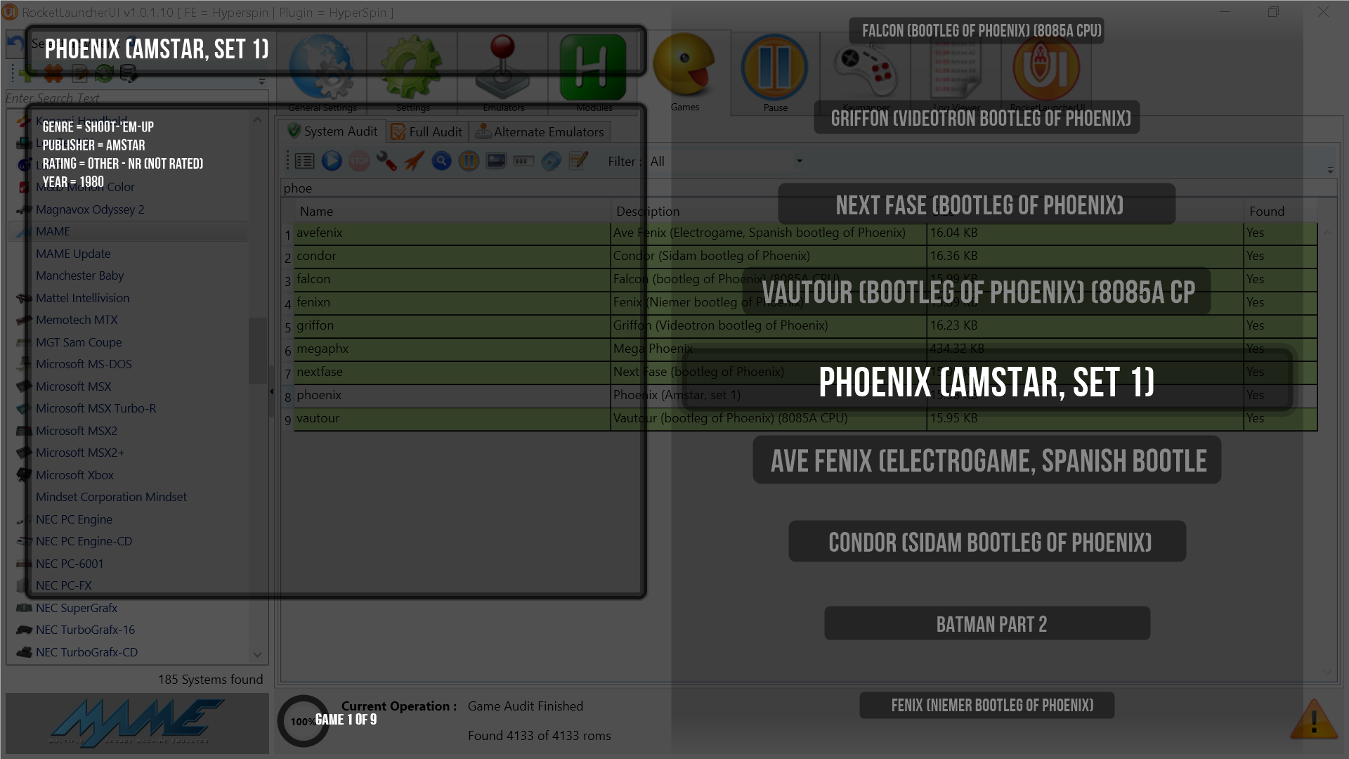

floatingyeti Posted December 15, 2022 Author Posted December 15, 2022 This is weird If I launch directly from RL: from HS: Are my HyperHQ settings wrong?
Creezz67 Posted December 15, 2022 Posted December 15, 2022 2 minutes ago, floatingyeti said: This is weird If I launch directly from RL: from HS: Are my HyperHQ settings wrong? Are you using a merged romset ?
