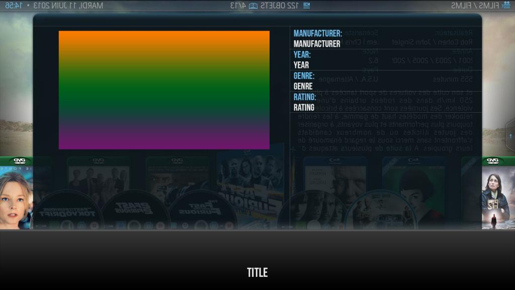

dark13 Posted August 31, 2014 Posted August 31, 2014 Let's admit it: we already have GREAT htpc styled themes BUT all we miss something: INFOs. Hyperspin can show only "title" on one line and year/manufacturer on another line. Having "real" infopanels would be GREAT but it means preparing infopanels rom per roms, right? WRONG. In photoshop you can use VARIABLES to load a .txt or a .csv to batch text changes or/and png changes. You can find an example on the FTP under Upload Here/dark13/Infopanel batch/. It has text variables (roms, title, title jap, title usa, title ue, manufacturer, year, genre, aama rating) and a .png variable (number of players). What's the "real deal"? Once you have .txt/.csv file you can easily change layout and export data set into a new set of images (it seems to export only to .psd so later you have to batch a .psd to .png conversion). Databases can be shared trought themes. All you have to do is create the layout->export data sets->batch .psd to .png conversion. Files will be automatically named accordingly to the first variable (roms). In few words: modify a pre-made layout, take a coffee (results may vary depending on cpu power ) and enjoy your ready-to use infopanel artwork layers More details about how to generate .txt or .csv here: http://www.hyperspin-fe.com/forum/showthread.php?36488-A-question-for-xml-dat-gurus&p=338443#post338443 A quick W.I.P. test for neo-geo infopanel set. Genre wheel is actually a test for main wheel. Consider that everything right now is SO WRONG, still need to find a decent background, tweaks aeon nox style and make a decent layout for infos Ah, it is "stretched" because I'm obviously designing it in 16:9 but my desktop monitor is still 4:3 Automatizing infopanels creation from .csv files for HTPCs themes (look at infopanel tutorial.zip on the ftp in dark13 folder) PNGs to SWFs automatized flash scripts Hyperspin Wheelset automatized template (photoshop's variables + batch) Aeon nox 4.13 W.I.P. hyperspin skin

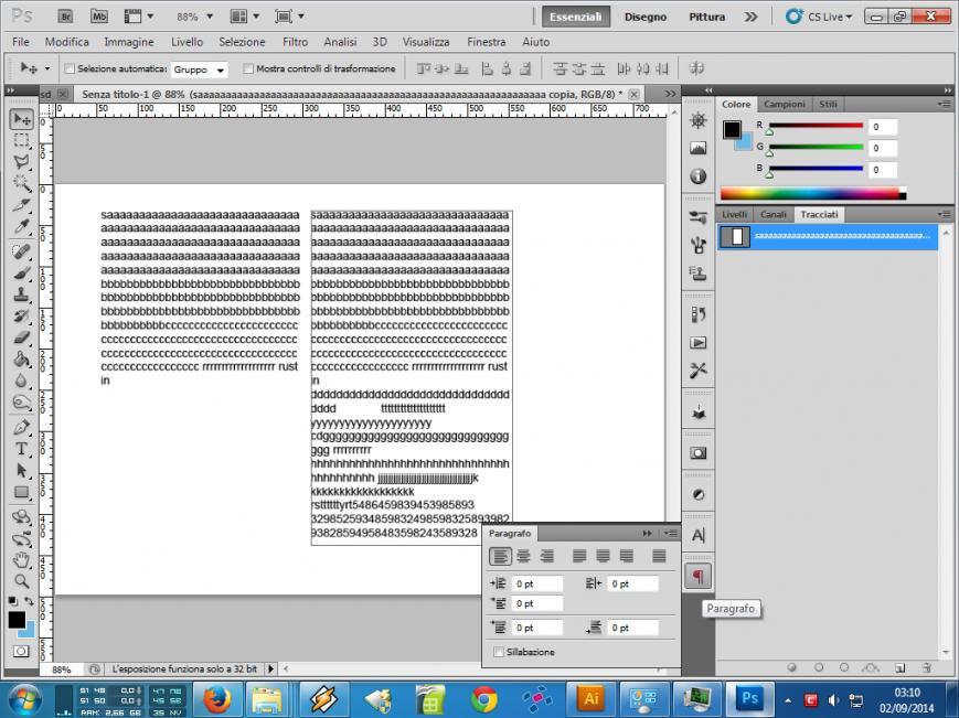

Trnzaddict Posted September 1, 2014 Posted September 1, 2014 Dark, what I think should be focused on is game synopsis, not so much year/manufacturer/rating kinda stuff. After thinking about this last night though, there is a potential problem if game synopsis png's were batch made. What happens if you get a long game synopsis that extends over what could be fit onto the png file? EG, XBMC will start to autoscroll down so users can read a description if it is longer than what could fit in the info pane. HS won't know how to do that, unless Photoshop can resize all the text automatically to fit onto 1 png file. Just a thought. I am......Machine
dark13 Posted September 2, 2014 Author Posted September 2, 2014 Oh, this is not a problem, you'll make scrolling lines for the whole emulation world entirety (btw you should do a tutorial for that, it looks great ) Ok, jokes apart I was already thinking to this issue. Sadly we can't batch scrolling in photoshop. Can we batch scrolling and .swf creation in flash? As far as I know there is no option to resize fonts depending on text's lenght to fit a panel. In photoshop we can only use path/shapes to contain text and avoiding it going outside infopanel borders. Guess we'll have to find the longest synopsys for each database and use it as pre-fixed variable in layout .psd. so everybody can set fonts/infonapanel based on the longest description. Maybe a fake scrolling can be arranged using an artwork layer as mask and layer's moving options but I'm basically a noob with that stuff. Synopsis will probably need some serious manul tweakings in the .csv, this work should be done by someone who natively speak english (a good english: a lot of italian would write a grammar apocalypse in italian, I guess there's the same problems with english/american/australian ) or we can track down a site with good and not too lengthy descriptions. Probably we should start out a project and keep contacts with the guys behind HL .ini and HS .xml for further updates. I think only mame would need a mantainer as other emulators are, more or less, "dead". You get some bread crumbs like gunlord and cheap brazilian rip-off but once batabases are ready I think only mame would need updates (even because sometimes they change rom's name like there's no tomorrow -.-) Automatizing infopanels creation from .csv files for HTPCs themes (look at infopanel tutorial.zip on the ftp in dark13 folder) PNGs to SWFs automatized flash scripts Hyperspin Wheelset automatized template (photoshop's variables + batch) Aeon nox 4.13 W.I.P. hyperspin skin
zero dreams Posted September 3, 2014 Posted September 3, 2014 So I haven't tried this yet but if an automated process can be used to generate this much info from a database and give me 16:9 while giving me the ability to tweak it in Photoshop, then I would turn off the HyperSpin text altogether and render my own text completely. Then HyperSpin and HyperLaunch text could match perfectly in my own choosing. I'm a little slow but I'm definitely gonna give this a shot. Nice one as always!!!!! Edit: Yeah....you've obviously turned the font off in the video HyperLaunch | HyperWiki | HyperSearch | Intro | Evolution | FadeProject | Checker | Steam Wheel

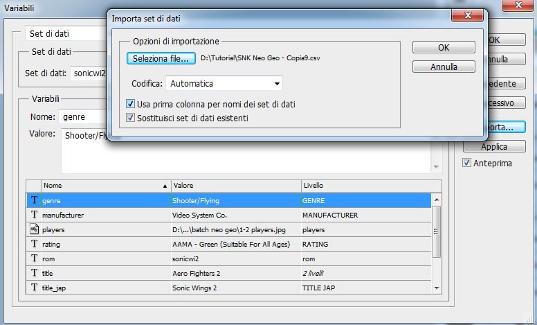

zero dreams Posted September 8, 2014 Posted September 8, 2014 So I took the SNES database and put in Excel, filtered out a few columns, saved it as a text (tab delimited), defined the variables in PS, process the data sets, batched the psd to png, and they look great. Two questions: 1.) How did you process the names genrated from PS back to their title name? 2.) This is what the SNES database gave me but I presume a dat for each system would give me more or is this about right? My little wip with that info. Edit: Yes I do have the other layers turned off in the psd. HyperLaunch | HyperWiki | HyperSearch | Intro | Evolution | FadeProject | Checker | Steam Wheel

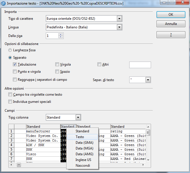

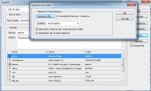

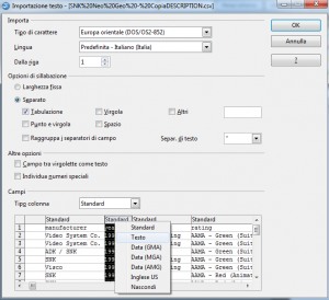

dark13 Posted September 8, 2014 Author Posted September 8, 2014 While opening .csv in openoffice/excel select "text" for the years column. I don't know what happens in excel but if you keep it as "numbers" openoffice will import 1980 instead of "1980". While importing .csv in photoshop tick this option. It is something like "use first colum as data set name". Exported files will be named according to first column in .csv (it will skip .png extension in file's name if you're using image variables for first colum of .csv) Are you using the .csv on the ftp? They has been automatically processed by ghutch92 with a script on hyperlaunch .ini. It is a good starting point but we must tweak it with as many info as we can Honestly I've still not checked each .csv on ftp, still working on my main menu wheel p.s. nice layout Automatizing infopanels creation from .csv files for HTPCs themes (look at infopanel tutorial.zip on the ftp in dark13 folder) PNGs to SWFs automatized flash scripts Hyperspin Wheelset automatized template (photoshop's variables + batch) Aeon nox 4.13 W.I.P. hyperspin skin

dark13 Posted February 5, 2015 Author Posted February 5, 2015 @bartmarley You must have the exact amount of variables in photoshop and on your .csv, and the name MUST be the same (case sensitive). When converting with the java parser you must add an "header" with variables' name. It is better to rename output.txt to output.csv and open it with openoffice (import everything as "text" or you'll have problem with year column). Delete the columns you don't need (es CRC) and add a row at position n1. Create your header on this row. The names used in this row Will be the variable names you need to link in photoshop. Export as .csv using "edit filters" and use (TAB) as separator and tick "quote all cells text". Automatizing infopanels creation from .csv files for HTPCs themes (look at infopanel tutorial.zip on the ftp in dark13 folder) PNGs to SWFs automatized flash scripts Hyperspin Wheelset automatized template (photoshop's variables + batch) Aeon nox 4.13 W.I.P. hyperspin skin

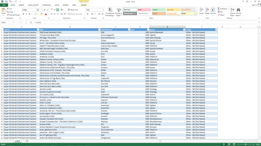

JonahUK Posted August 2, 2016 Posted August 2, 2016 You can open the XML with Excel, it will show each tag as a seperate column which you could then export as a CSV. Not the best way but it works. https://imgur.com/a/BZ6vz3B
