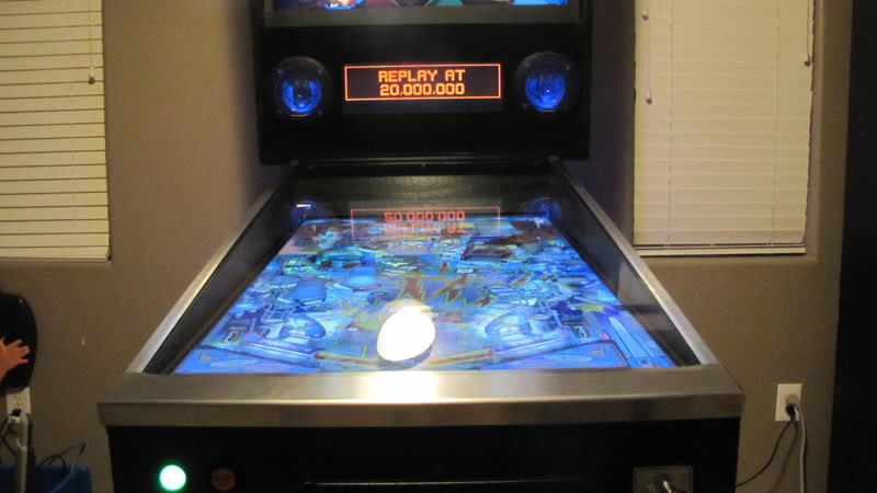

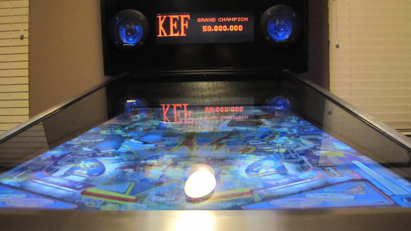

DeeGor Posted October 26, 2011 Author Posted October 26, 2011 Mounted the glass on the cabinet tonight. All that's left is to work out a few software issues and work on the artwork. I'm loving how everything turned out so far.

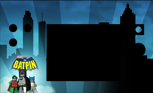

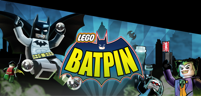

DeeGor Posted December 10, 2011 Author Posted December 10, 2011 Thanks dopdahl. It's been a little while since I updated this thread. I had attempted to get someone local to do the artwork, but I think the job was just a little too complex for them. After several weeks of waiting I decided to find someone else to work on the art, and I'm glad I did. gbeef did a great job! Here are some samples of the artwork he did for the cabinet Front: Side: Backbox: I'll take some pictures of the final product once the artwork gets here and is applied.

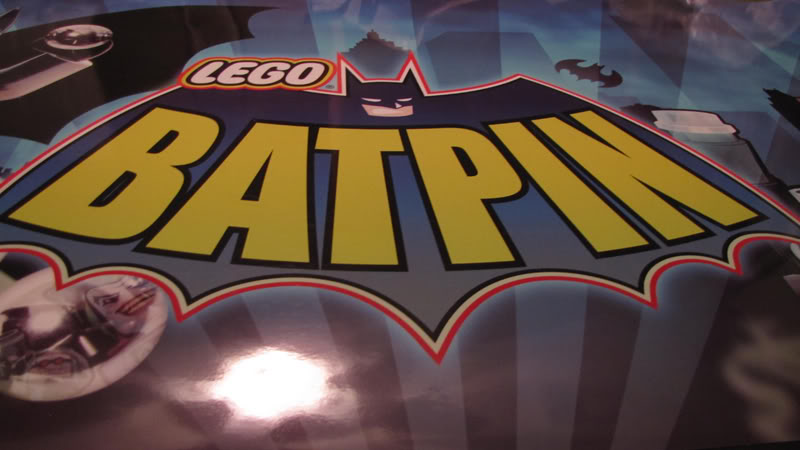

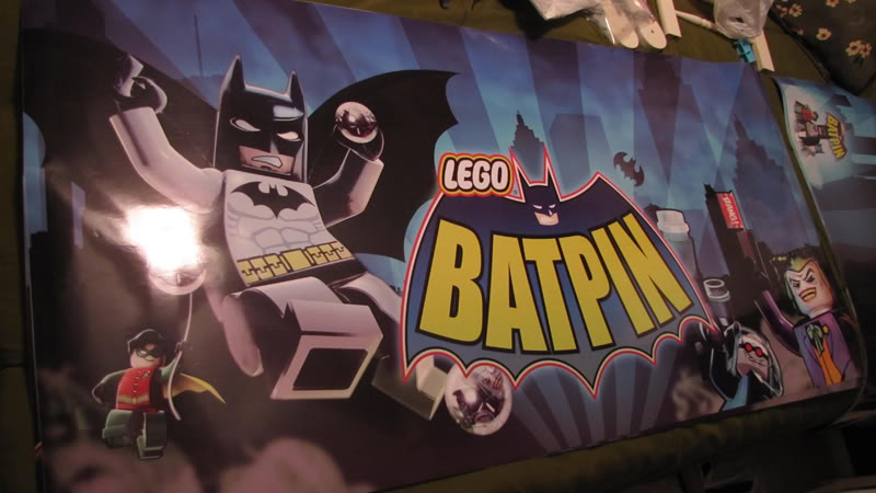

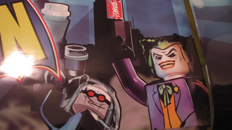

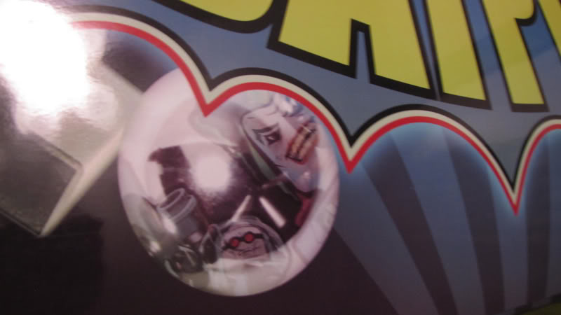

DeeGor Posted December 17, 2011 Author Posted December 17, 2011 Christmas came a little earlier this year. My artwork arrived today and it looks better than I expected. A few quick questions for those who have applied artwork before. Do you typically have any overlap on the corners where the sides and front meet? If so, which piece overlaps? ie: Do I apply the front piece first, fold over a little excess, then apply the sides or do I apply the sides first, then the front? If there is no overlap, is there any worry that the artwork will peel away over time and how do you protect it? Here are a few pictures I took of the artwork.
maxxsinner Posted December 17, 2011 Posted December 17, 2011 Love the results DeeGor! Mamemans advice to me was to wrap the side art over to the coin door face (If I remember right MM?!) and Lucian stated that the sides should be trimmed flush. Mameman also recommended that the corners of my cabinet should be mitered or rebated to help conceal the corners better. The place where I got my cabinet made was not willing/able to miter the corners so in the end I had the ends of the MDF exposed. I trimmed my art flush with the edges as Lucian suggested (as i had already ordered my art to size then got MM's advice) and now the corners of my art lift where my hands sit. If I did it again, mitered corners and sideart wrapped to coin door.... and heed the advice of a guy that has done more than a couple of cabinets before Electropin - Enough lights to land a jet on an aircraft carrierHigh Voltage Pinball - Cause one build just wasn't enough Voltek Arcade - Funglo pedestal style mame cabinet Pinball Electrical Tutorial - Wire All Your Bling With Confidence and Fewer House Fires

mameman Posted December 17, 2011 Posted December 17, 2011 Nice artwork. Killer print job. All comes down to how good the corners are and how well the surface prep is. If you have straight clean corners, and your surface is consistent then flush will be fine. Once that adhesive sticks it ain't coming off easy. Iffy corners or a surface that's not ideal to grip and wrapping slightly is a safer bet. PM me for any custom CNC needs. Find me on Facebook.. Xtreme Pinball or www.xtremepinball.com Ipad pinball cabinet iFlipper Here: See the Doctor Who build Here.... / See the Tron build Here.... / See the BattleStar Galactica build Here.... See the Big Bang Bar build Here.... / See the Twilight Zone build Here.... CNC Work Here.....

Lucian045 Posted December 18, 2011 Posted December 18, 2011 Nice artwork. Killer print job.All comes down to how good the corners are and how well the surface prep is. If you have straight clean corners, and your surface is consistent then flush will be fine. Once that adhesive sticks it ain't coming off easy. Iffy corners or a surface that's not ideal to grip and wrapping slightly is a safer bet. Going to agree with Mameman here, if the box has good sharp corners and you cut the excess away evenly and cleanly, you will have no problems on the ends. This material I sent to you is HIGHLY aggressive. As long as the wood is clean, you will have no problems. I do not recommend lapping the ends as the thickness of this material will definitely be noticable, but if you do not have sharp coners then you might have to. When I applied my decals I started with the sides first and finished with the coindoor. You are more than welcome to call me DeeGor if you have questions about it.

gbeef Posted December 18, 2011 Posted December 18, 2011 Very nice print job... can't wait to see this on the cabinet. There should be some overlap 1/2 on each side.But its up to you to leave or cut it off. My Cabs My Pin Cab Attack of the PINZ cab My Racing Cab OutRun Racing
