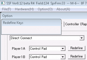

Dogway Posted April 3, 2014 Posted April 3, 2014 Hello, can anyone post his Pad mappings for wired 360Pad? The problem I have is that input mapping fails because my joystick is too sensible and when pushed UP it maps DOWN, LEFT, etc in a row, so key mapping is a nightmare and for the life of me I can't get what the codes means on the settings if I were to edit them: Pad0_0_0="2/30/2/30/2/30/2/30/2/30/2/30/2/30/2/30/2/30/2/30/2/30/2/30/2/30/0/0/0/0/0/0/0/0/0/0/2/30/2/30/2/31/2/31/2/31/2/31/2/31/2/31/2/31/2/31/2/31/2/31/2/31" Thank you!
