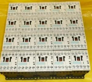

mattdavis Posted April 15, 2012 Posted April 15, 2012 Hello, Hope somebody can make sure of this info. I just purchased a 9 unit lot of 3RH1140-1BB40 relays from this guy on eBay for $125. He had them listed at $304 with a "Make Offer". I thought- what the heck and offered him about 43% of asking price and he took it. $13.88 each +$2 each shipping=$15.88 each. From reading, it sounds like a good deal. Unfortunately, he does not have another 9 lot up, but he does have a 20 lot (maybe 2) for $604. Link below. If he is consistent, doing the math, he should take ~$277 for 20 units. His shipping is almost 50% less per unit in the large lots. Maybe two people can split the order. http://www.ebay.com/itm/Siemens-Serius-3R-Relay-3RH1140-1BB40-Lot-of-20-Working-/170523040259?pt=LH_DefaultDomain_0&hash=item27b3f71a03#ht_2081wt_1396 My Build Log

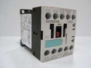

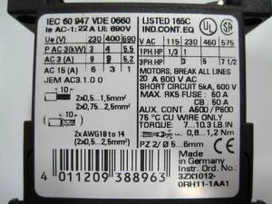

slykittycat Posted April 16, 2012 Posted April 16, 2012 Hi Could someone verify what these are 12v? 24v? are they a good choice? thanks for any input also from usa and i have no clue what to look for no markings in lower right corner of any contactors that i have seen
maxxsinner Posted April 16, 2012 Posted April 16, 2012 That one is a 440V AC coil so no good for our cabinets (unless someone wants to put 3 phase power in thier cabs.... Now that would be braggin rights! ) Electropin - Enough lights to land a jet on an aircraft carrierHigh Voltage Pinball - Cause one build just wasn't enough Voltek Arcade - Funglo pedestal style mame cabinet Pinball Electrical Tutorial - Wire All Your Bling With Confidence and Fewer House Fires
