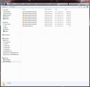

gigapig Posted February 13, 2015 Posted February 13, 2015 I have just tried loading a cue from an extracted game (see screen for which one) and it loads OK. I have the 3 bios files in the system folder. Here's my config file. Sony PlayStation.zipFetching info...

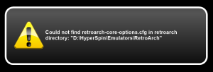

showstopper Posted February 13, 2015 Posted February 13, 2015 I'll try the new bios files when i get home but to me it looks like RA is quitting even before it gets to that stage. It quits literally as soon as I click run on the game. Also these bios files and ROMs all work with ePSX? EDIT - OK so it still quits straight away - is there not a log i can enable for RA? If i try to run a game from HLHQ i get this error: Any ideas? How to update HyperLaunch
guyverjay Posted February 13, 2015 Posted February 13, 2015 showstopper said: I'll try the new bios files when i get home but to me it looks like RA is quitting even before it gets to that stage. It quits literally as soon as I click run on the game.Also these bios files and ROMs all work with ePSX? EDIT - OK so it still quits straight away - is there not a log i can enable for RA? If i try to run a game from HLHQ i get this error: [ATTACH=CONFIG]50529[/ATTACH] Any ideas? Yeah you need a config file with that name in the retroarch folder
gigapig Posted February 13, 2015 Posted February 13, 2015 I've seen that recently with someone else. That file isn't created until you run a game, so if this is the first system you have set up then you may need to set up a different system. Here is the thread.
Fromlostdays Posted February 13, 2015 Author Posted February 13, 2015 RetroArch should automatically generate that configuration file, but different versions put it in different places and different versions of the HL module have slightly different spellings and look for it in different places.... But ultimately, yeah, what guyverjay said. That file is generated either in the retroarch root directory or inside the retroarch/config folder. It's looking for it in the root... which means your module is probably out of date. Either way, it doesn't hurt to make two copies of the file and leave one in config folder and one in root. Unfortunately I doubt this is why RetroArch standalone isn't working for you. The next thing you need to try is a reinstallation of RetroArch, place bios files, and try to launch. (Don't delete your old install, this new install will help troubleshoot weather its your RA version, or configs that's causing your problem.) Walter:beerglass:
showstopper Posted February 13, 2015 Posted February 13, 2015 OK getting somewhere. So I got the games to load in RA now. It was an error with ALL(!) my .cue files. I also have it working from HLHQ now too. This was my 3rd system in RA so not sure why that file wasn't there before?! Anyway some of my games load, well they show the Sony screen then it is just a black screen and I can here the sounds but no pic. So it's either my ROMs or the emulator. (Bomberman - Party Edition is the game that isnt showing video) Thanks for all your help guys! How to update HyperLaunch
