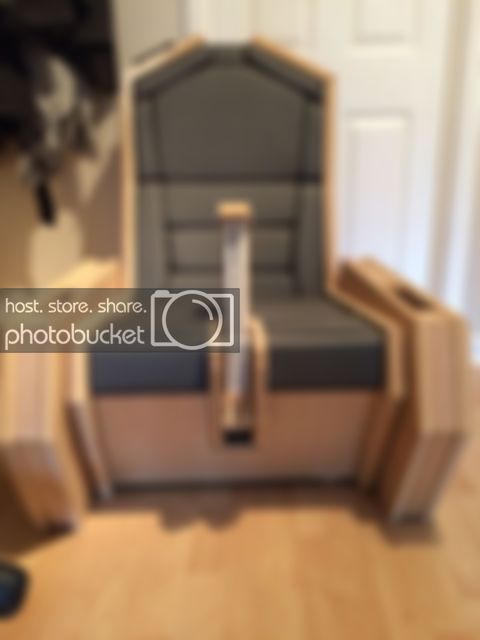

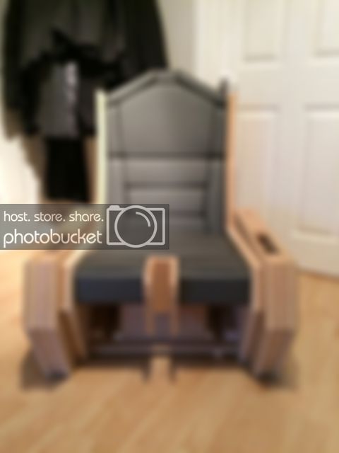

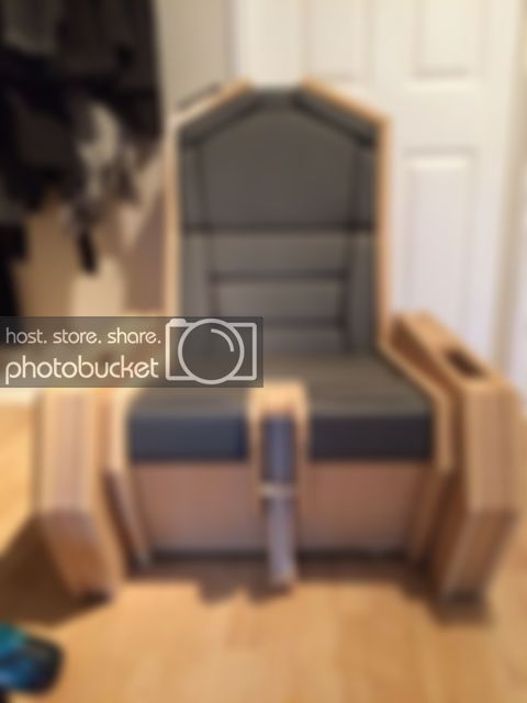

ericleroi Posted December 14, 2014 Author Posted December 14, 2014 The second pad has been fitted along with the centre console:

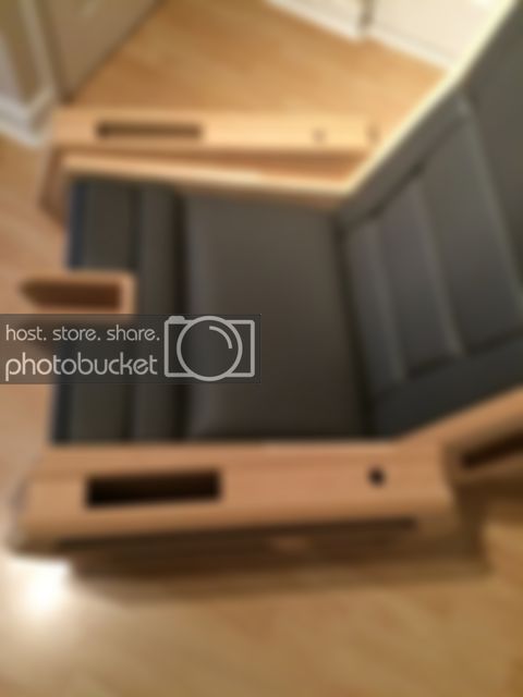

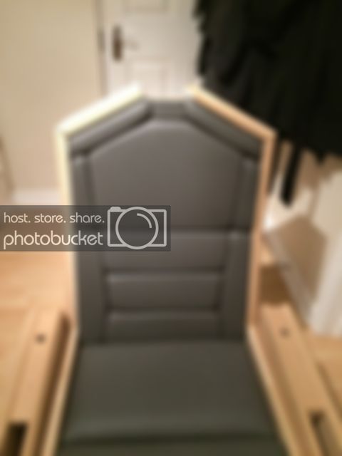

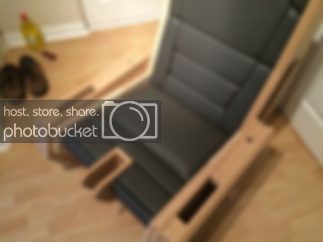

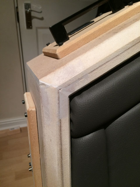

ericleroi Posted December 15, 2014 Author Posted December 15, 2014 I've completed the top shoulder sections for the seat. There's a lot of filling to do here and I've cut some recesses into the tops as the displays I will be fitting to a panel which will be attached are too deep. There's a lot of filling to do once the glue has dried. I will need to sort out the 2 top seat pads as well. The internal and eternal faces of the side pieces have been beveled:

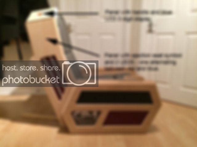

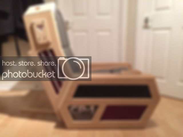

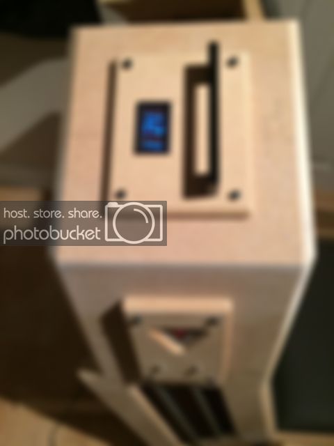

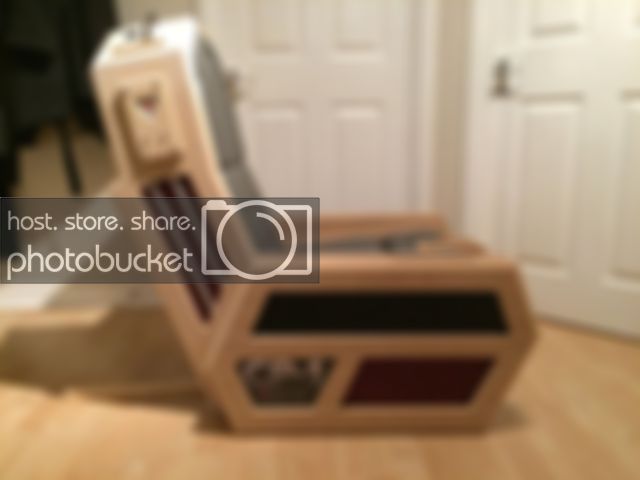

ericleroi Posted December 16, 2014 Author Posted December 16, 2014 I'm winging it Hyperion The LED display is a simple volt meter so just there for a bit of interest rather than anything functional! The side panels have been completed: With LED bezels and cap head bolts (I will be using slightly larger ones when they arrive):
ericleroi Posted December 17, 2014 Author Posted December 17, 2014 I think it would look cooler if you had an inset design up there to flow with the rest of the design. That was the original plan. However, due to the bracing I've made to connect the top shoulder section to the sides, which is essential, it's not possible unfortunately. The structure wouldn't be strong enough.

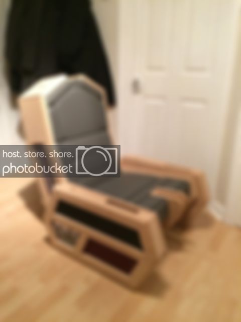

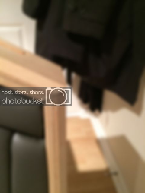

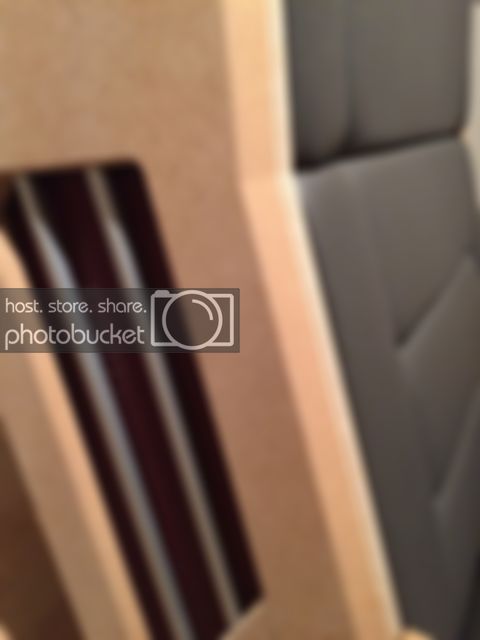

ericleroi Posted December 17, 2014 Author Posted December 17, 2014 I've been keen to fill the sections where the side panels meet the shoulder panels just to ensure that everything lines up correctly. Before: After a first pass of filler: One of the new panels fitted: Powered: The balance of the design will be improved when the headrest is made. These will have the cutouts/windows which will use the ribbed rubber sheeting.

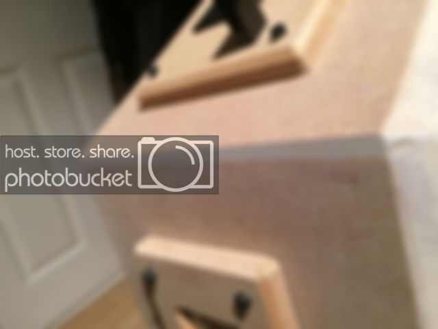

ericleroi Posted December 20, 2014 Author Posted December 20, 2014 I've made the panel for the front of the seat. This will have an additional 6mm panel bolted onto it using threaded inserts so I have those showing rather than screws. It will be covered in blackboard vinyl:

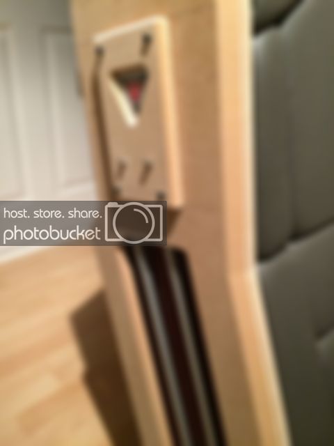

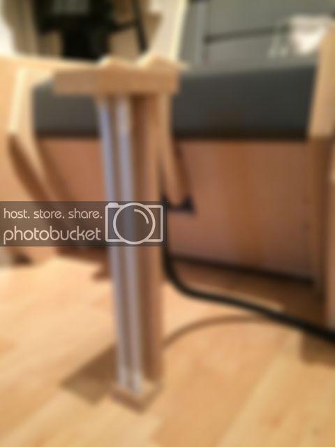

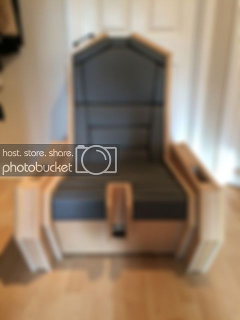

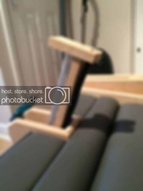

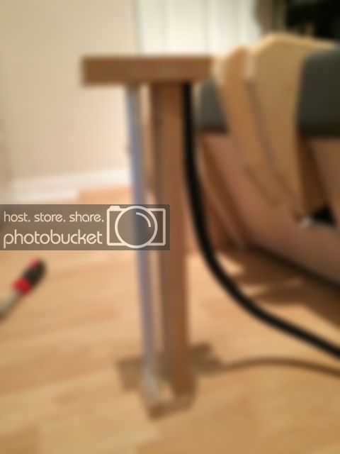

ericleroi Posted December 20, 2014 Author Posted December 20, 2014 I've started working on the stow-able console mechanism. I've been giving the design of this a great deal of thought and wanted to come up with something attractive, simple and stable. The design you see here will have a rod running between the aluminium bars and the long, upright piece - the rod will be embedded in the main centre section towards the top. The bottom will have 2 additional pieces made - small sections will be cut and include a hole which will then be further cut into taking about 90 degrees out of the circle making it open. The idea will be to allow this to rest on another lower, circular rod embedded in the main centre section which will be further forward from the upper rod. To stow, I can then lift the mechanism up, push it forwards and drop it down. Simple. The rear upright will have some convoluted sheathing (which I have split) to accommodate 2 or 3 cables - lightning, USB / mini USB. As these parts are small, I will be filling, shaping and finishing by hand. They're too small to work with a router. The top piece shown in the picture is not attached yet. I will epoxy in place one everything has been prepared. Once dry, I will used thin screws to further secure the pieces together - I don't wand these to split so will drill pilot holed beforehand.

ericleroi Posted December 21, 2014 Author Posted December 21, 2014 Loose fit of the mechanism in action. Lot's of things need to be tightened, painted glued yet. Up: Stowed:
ericleroi Posted December 21, 2014 Author Posted December 21, 2014 The nutcracker Could well be if I don't retract first Just to give an idea of using the mount with an iPad mini: I've ordered some aluminium for use as a top plate for the mechanism.
