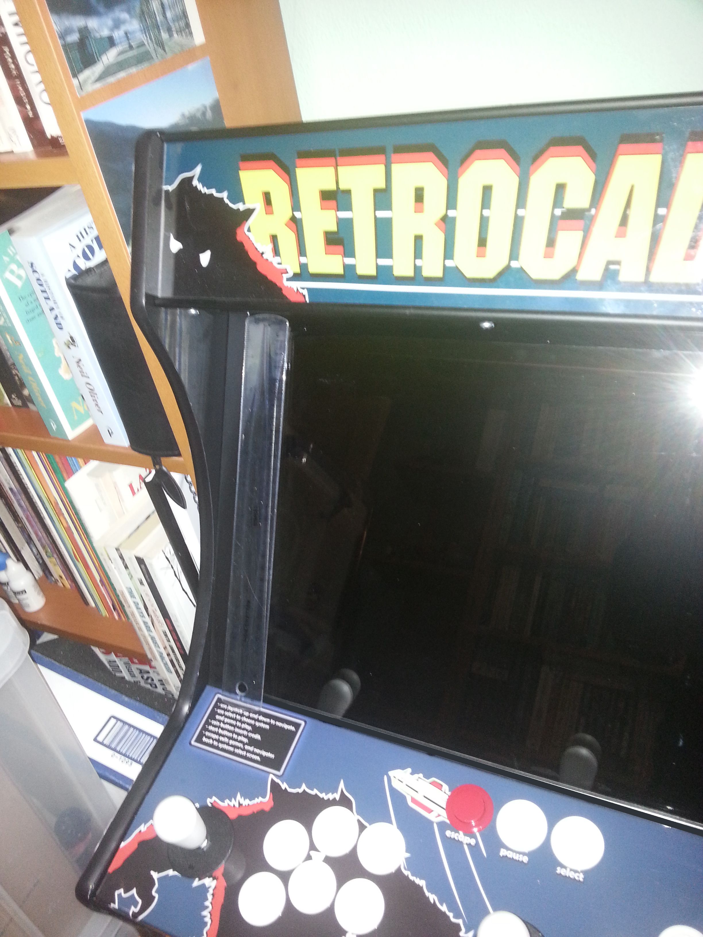

mikekim Posted December 23, 2012 Author Posted December 23, 2012 JogZter, here is a shot of the front of the cab. i have placed 12" (30cm) ruler on the front for comparison. A 19" screen will fit in this cab, as I'm using one (a Sony x-black - de-cased). there is about a 1cm bezel at the top of the glass - you cab see the sliver edging of the screen at the bottom on the picture

mikekim Posted January 1, 2013 Author Posted January 1, 2013 Has you put PVC U Molding in the edge of your BarTop Cabinet ??I thought you had spray painted Can you tell me what PVC use ? yes i did use t-molding i got some from 10mm t-mold (cant remember where from though). closest to it i have seen recently is 1/2" black t-mold

Frosty Posted January 21, 2013 Posted January 21, 2013 yes i did use t-molding i got some from 10mm t-mold (cant remember where from though). closest to it i have seen recently is 1/2" black t-mold As far as using t molding what did you use to notch the edges? (Trying to avoid finding a slot cutter...)
mikekim Posted January 21, 2013 Author Posted January 21, 2013 As far as using t molding what did you use to notch the edges? (Trying to avoid finding a slot cutter...) I used the dremel 565 cutting kit with a 1mm cutting disk 426, set to the centre line of the sides. Sent from my Samsung Galaxy Note II.
richie_jones Posted January 23, 2013 Posted January 23, 2013 Not much to sit on the wood there mike, was it easy to keep level..
mikekim Posted January 23, 2013 Author Posted January 23, 2013 It was quite easy really, as the dremel is very light. Just a case of taking time to ensure the cut was central. Sent from my Samsung Galaxy Note II.
