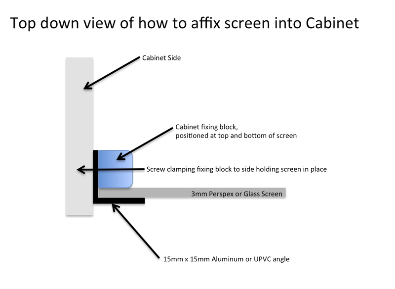

ruffmeister Posted April 25, 2013 Posted April 25, 2013 how do you afix the perspex? i have it cut to size but how to fix? Also what do you use for the black border to hide the monitor?
richie_jones Posted April 25, 2013 Author Posted April 25, 2013 I used some angle iron sprayed black, and siliconed the glass onto from the inside. Black border is spray paint. Just mask off your monitor area and spray the rest black . Obviously the painted side goes at the back..
Lucian045 Posted April 25, 2013 Posted April 25, 2013 Nice, mine was done on a solvent printer on vinyl which is meant for car wrapping. You'd think the stuff would last. Yardley, If the CP is fading from your hands on it, it sounds like they did not laminate the print. If they did, they used crappy print media and laminate. Solvent ink is not the cause. @MikeKim and RichieJones...Thanks for the testimony you guys !
mikekim Posted April 26, 2013 Posted April 26, 2013 how do you afix the perspex? i have it cut to size but how to fix? hope this diagram clarifies how to affix the screen in the cab..
