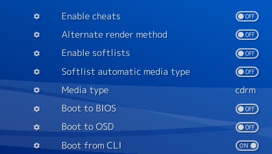

Aorin Posted February 1, 2017 Share Posted February 1, 2017 OK, I managed to run CD-i in Retroarch (MAME core [includes MESS inside]). This is really easy, I`m not sure if it works with bin+cue, I tested with a CHD CD-i game. In short you need: Retroarch 1.4.0 and a MAME core A CD-i game in CHD cdimono1.7z or cdimono1.zip (proper for MESS, now MAME) this file should be inside the same folder where the CHDs are, no other location will make games load and RA will crash. Maybe you'll need to open a normal MAME game using retroarch first to change three options, they are: Enable softlists (OFF) Media type (cdrm) Boot from CLI (ON) Now load the game, it should run without problems. In this game, the mouse sensitivity was too high and I had to configure all inputs in my gamepad inside MAME OSD config, it's not TAB in Retroarch it's dash "/" it seems to be working fine now. I'm going to put this guide in Libretro Forums as well, there are a lot of people looking for this kind of guide, I'll add NEO GEO CD as well. I'm going to try FM Towns Marty soon. Link to comment Share on other sites More sharing options...
badboo Posted February 1, 2017 Share Posted February 1, 2017 Oh wow man, that is great. I even like how it looks with the filter you have on. I will try tonight now that I know retroarch runs this system now. And since I updated retroarch to 1.4, I will even try the other systems like atari CD ad neo geo CD to see if those work as well. Link to comment Share on other sites More sharing options...
Aorin Posted February 1, 2017 Share Posted February 1, 2017 1 minute ago, badboo said: Oh wow man, that is great. I even like how it looks with the filter you have on. I will try tonight now that I know retroarch runs this system now. And since I updated retroarch to 1.4, I will even try the other systems like atari CD ad neo geo CD to see if those work as well. OK, I can also try Jaguar CD later. In case you want to try the shader I use, it's this one: Link to comment Share on other sites More sharing options...
