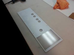

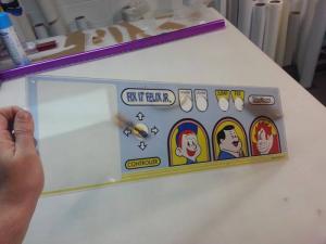

RidicRick Posted November 7, 2013 Author Posted November 7, 2013 Had a custom cut plexi control panel overlay made to put over my control panel graphic. Turned out pretty nice and much more professional looking. If anyone wants one let me know.. taking preorders. $55 plus shipping for each plexi overlay (graphic not included, its just the plexi overlay). Works with Fix it Felix only. If you need some made for Donkey Kong or other Nintendo cabs let me know. Once I get enough preorders I will have them made and shipped out ASAP. thanks..
tjpietro Posted November 7, 2013 Posted November 7, 2013 Rick, For install, do we just drill in the holes and apply? Tim
RidicRick Posted November 8, 2013 Author Posted November 8, 2013 The holes are already in the plexi so if you can use those as templates for the holes in the wood. Screw holes, button holes, and joystick hole.

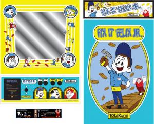

pinballsmith Posted February 2, 2014 Posted February 2, 2014 I manged to pick up a real Disney-made machine and I'm having a friend help in recreating the artwork true to the original. Here's a sample of the artwork package he did, but he's still tweaking a few things.
SORHP Posted February 2, 2014 Posted February 2, 2014 Those look great! When you are finished, can you upload the files to the FTP? I'm sure many here would thank you My Arcade Machines...
RidicRick Posted February 2, 2014 Author Posted February 2, 2014 Looks like the only difference is the color change and maybe a few vector lines am I corret? And the little bezel instruction decal I made needs to be updated, its not really correct on how the game plays. I made it before we really started playing the game and didnt know much about the controls and rules yet. And for everyone who wants the files via dropbox sorry I am no longer sharing them, not because I don't want to but because I am staying away from any troubles from Disney.

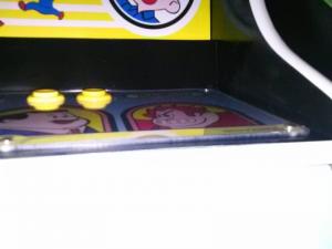

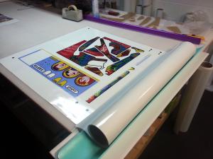

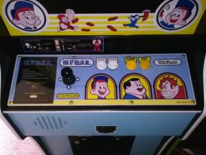

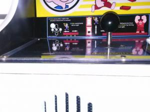

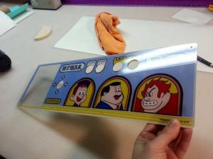

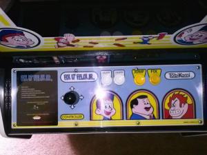

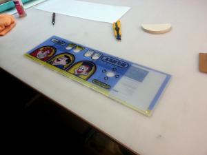

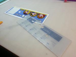

RidicRick Posted February 6, 2014 Author Posted February 6, 2014 Check out my latest work I did today. I had a acrylic control panel overlay made and I didnt want the decal on the outside but I wanted it to appear screen printed like the original (if there was one) would have been. So here is what I did. Enjoy. Also, I will be doing my marquee and bezel this same way. First I printed the control panel overlay on CLEAR vinyl. My printer does NOT print white so everything white will be transparent. Here is the printed overlay next to the acrylic panel I had someone CNC for me. The overlay print is printed in reverse. Since the overlay is printed in reverse I install the print on the back side of the acrylic overlay. Here is what the print looks like installed. Pretty cool! and translucent! It needs the white for the background yet. I now used my translucent white vinyl and cut out a template (reversed) to install on the backside over the print. This makes it white and makes it almost look screen printed. I didnt have to use translucent vinyl (used for marquees) but its the only vinyl I have that has a white adhesive side. Here is the finished product. Amazing! Looks just like it really would have back in the early 80s when it was brand new.
