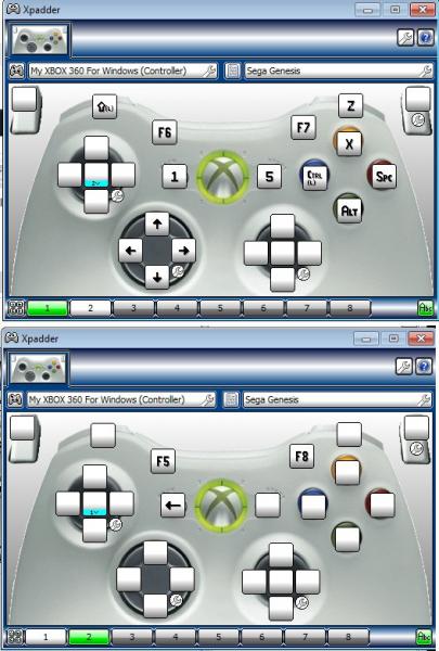

You do not need a blank profile for every system, I have 1 setup for the SSF emulator and most of my controller mapping is done in the emulator not xpadder, I only use it as a last resort.
I also play Dark Souls and all manner of other Steam games without ever having problems with xpadder being in the systray.
So you should be able to set up the Hyperspin profile and forget it, you must be missing something.

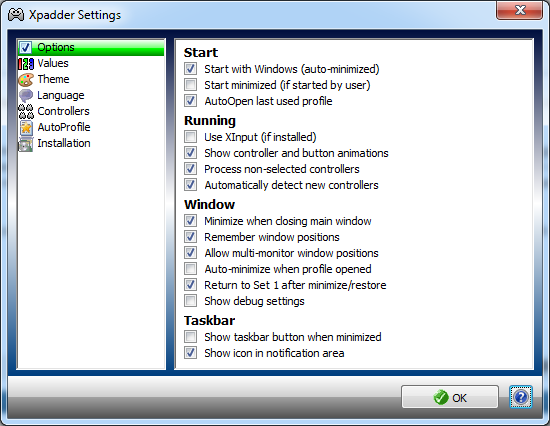

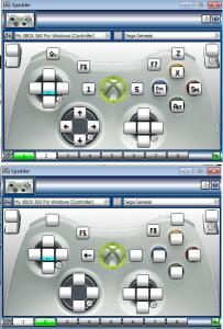

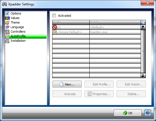

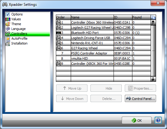

Here are some screens of my xpadder settings, I also use ghutch's Hyperspin Startup Script.
