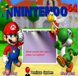

dirkthedaring83 Posted September 8, 2013 Posted September 8, 2013 I just got a Dell Latitude E6430 with Intel 4000 graphics and I have the same issue with mp4 files in HS, garbled video. I've upgraded to the latest intel drivers from their site and still have the same issues. The files themselves play in VLC and Window Media player just fine. I also believe that its a HS issue and not an issue with the drivers. Is it possible to submit a bug to have this fixed?
sandman7793 Posted September 9, 2013 Posted September 9, 2013 This will not be fixed anytime soon. Only work around is to convert the videos back to flash. A boy stuck in a mans body

Deadly Posted December 27, 2013 Posted December 27, 2013 I spent 8 years working at Intel. The video driver software devs "which I actually worked with for a couple years" generally only care that the package installs correctly and doesn't cause windows to crash. Outside of that, I think you HD users are shit out of luck. Believe me, I wish they would fix this, but let's look at this the way they will. Do Intel drivers allow MP4's play fine in Windows 7 and 8? |___(Yes) | |__ (Goto end) Why should they fix something that is being caused by a 3rd party app? This issue is worse than trying to run a GMA chipset driver to play Minecraft. You had to revert to an old driver (try to find the one that actually works) and tell windows to ignore video driver updates. Intel has yet to prove they can actually do anything video related worth a damn IMHO.
cass Posted February 4, 2014 Posted February 4, 2014 Confirmed here also. Screen garbled. Toshiba Satellite Laptop Core i3 Intel® HD Graphics 4000 Has anyone been updated with regards to a solution yet? Edit: I've tried updating Drivers - No Dice I've disabled hyper-threading on the core i3 - No Dice

gigapig Posted February 6, 2014 Posted February 6, 2014 Sorry, I can't remember, but for those using HD4000 does this effect flv vids as well? If its just mp4, then just convert them with the emumovies conversion tool.
bleasby Posted February 6, 2014 Posted February 6, 2014 just use flv instead of mp4 and they should wor. Emumovies has a video converter for that, and the only bad thing about it is that you spend a little bit more of drive space. Edit: I posted at the same time as giga. When asking for help for RocketLauncher, POST ON THE RLAUNCHER.NET FORUMS! Also, please post your RocketLauncher.log with logging level set to troubleshooting in pastebin (set the log level in RocketLauncherUI, global system > General Settings -> RocketLauncher). Ass. Bleasby - RocketLauncher Development Team.

teowind Posted February 13, 2014 Posted February 13, 2014 I just bought a PC to use in my arcade I built and this was quite the bummer. However, the videos still work if they are in .flv format, as previously stated, in the latest version of Hyperspin.

momentarydogma Posted February 14, 2014 Posted February 14, 2014 It's a lost cause, Intel's gfx chipset sucks. Save yourself time and a headache and buy the card I referenced earlier in this thread. Problem solved and you will enjoy Hyperspin 1.3 to its fullest potential This isn't really a solution for a lot of people who are adopting the miniPC format, which is ideal for plenty of HS builds. You can't just add a dedicated graphics card to these systems. The built in graphics chipsets on Intel's processors don't "suck". Sure, they're nowhere near as good as dedicated GPUs, but there's no reason why you would need one of those for playing preview videos on a front end. People keep speculating that this is a HyperSpin issue, but I don't think that's the case either-- there's something off with whatever codec that EmuMovies is using for their mp4s that, when played inside of HS, is causing an issue. As someone else stated before, if you convert them to mp4s with ffmpeg, they work just fine, and I've also converted them to mp4 using other video conversion software and they play perfectly within HS, but there's no way I'm going to sit here and convert 1,000+ bum video files individually. For now, the solution seems to be to use EM's batch flv converter, but this is also not ideal because they take up so much unnecessary (and precious) HD space. Obviously, Intel doesn't give a crap about whether or not EM's mp4 files play properly within HS, but I can tell you for sure that you can convert them to a more standard mp4 format that doesn't take up any more space than the originals and they work perfectly, so this isn't an Intel issue. Simply saying that Intel sucks isn't particularly helpful.
