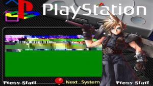

showstopper Posted February 14, 2014 Posted February 14, 2014 momentarydogma said: This isn't really a solution for a lot of people who are adopting the miniPC format, which is ideal for plenty of HS builds. You can't just add a dedicated graphics card to these systems. The built in graphics chipsets on Intel's processors don't "suck". Sure, they're nowhere near as good as dedicated GPUs, but there's no reason why you would need one of those for playing preview videos on a front end. People keep speculating that this is a HyperSpin issue, but I don't think that's the case either-- there's something off with whatever codec that EmuMovies is using for their mp4s that, when played inside of HS, is causing an issue. As someone else stated before, if you convert them to mp4s with ffmpeg, they work just fine, and I've also converted them to mp4 using other video conversion software and they play perfectly within HS, but there's no way I'm going to sit here and convert 1,000+ bum video files individually. For now, the solution seems to be to use EM's batch flv converter, but this is also not ideal because they take up so much unnecessary (and precious) HD space. Obviously, Intel doesn't give a crap about whether or not EM's mp4 files play properly within HS, but I can tell you for sure that you can convert them to a more standard mp4 format that doesn't take up any more space than the originals and they work perfectly, so this isn't an Intel issue. Simply saying that Intel sucks isn't particularly helpful. It cant be the codec as the same emumovie file plays fine outside of hyperspin. Simple troubleshooting always points to hyperspin in this case. Does the mp4 file play in windows in all your media players = Yes Does the same file play in HS = No How to update HyperLaunch
Monyet Posted February 17, 2014 Posted February 17, 2014 I'm not a driver creator, but since AMD and nVidia don't have a problem playing those same files outside and inside of Hyperspin, it makes me think that the intel driver is the problem. I just bumped my thread over at the intel forums, I'm starting to get on the guys nerves, his responses are getting shorter, but still the same response - "When I get any feedback from the engineering department I will post it here." Has anyone else put in request for a fix over there yet?

momentarydogma Posted February 19, 2014 Posted February 19, 2014 showstopper said: It cant be the codec as the same emumovie file plays fine outside of hyperspin. Simple troubleshooting always points to hyperspin in this case.Does the mp4 file play in windows in all your media players = Yes Does the same file play in HS = No I really think it's a combination of the two... a fix on either side would probably do the trick. Just because I can play it in another media player doesn't necessarily mean that HS is broken. The fact that the issue is limited to those specific Intel GFX chips says something about the way the Intel drivers are handling them within HS. Standalone media players all have different ways of handling specific codecs, so the fact that it plays on VLC or WMP doesn't really mean a whole lot. In any event, HS isn't handling the codec properly on HD2500 and HD4000 chips, and Intel's drivers are also not handling it properly within HS. I guess the burden is more on the HS team to ensure that different codecs play within their software on a variety of GFX chips, but Intel has done something non-standard that is preventing this specific codec from playing with HS as well. I moved back to the .flvs and I guess that's just fine for the time being.
