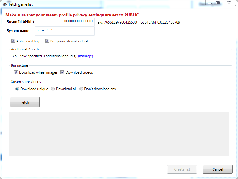

gigapig Posted November 30, 2013 Posted November 30, 2013 Yeah, that's what I did (after backing up my database) and it seemed to have created it's own Pc Games database with only my Steam games lol. Maybe I missed something. Don't you just add that here in System name, whether yours is called PC Games or Steam or "Whatever my existing DB is called"
Pyramid_Head Posted November 30, 2013 Posted November 30, 2013 Yeah, but it just overwrites everything in the database. (lmfao at the name you used ) But yeah I ended up copying the text from the Steam DB and pasted it in my existing DB and it worked. Though I'm always get games off Steam (when they're cheap/on sale) so I'd rather not have to keep copying and pasting. Are you saying that worked for you?
pietie Posted November 30, 2013 Author Posted November 30, 2013 I can't remember whether I do a case-sensitive match or not but that might be it. If the System name matching an existing one in your Main Menu it's supposed to bring up the merge screen.... My tools Steam wheel creator - Generate xml list from Steam profile with artwork and videos HyperSearch - Integrates search functionality with HyperSpin
mameshane Posted November 30, 2013 Posted November 30, 2013 I have definitely used the same system name and it's merged the steam games in with the existing pc games db. A screen comes up saying what's already in there and the changes it's going to make. My Cab.. 1-UP ARCADE new hyperspin irc details.. come hang out!
