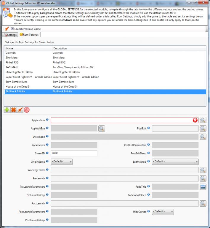

sycdan Posted December 17, 2013 Posted December 17, 2013 Here is an entry from the generated xml.In a future version of Hyperlaunch HQ, could Hyperlaunch HQ pull the SteamID directly into the SteamID field when setting up PCLauncher? Is Brolly already working on that, if it can be done? Thanks gigapig: I'm a bit late to the party here, I know, and maybe someone's already working on this, but I made some tweaks to v2.0.7 of PCLauncher regarding loading Steam App Ids without adding a [section] for each game to an ini file. 1. PCLauncher will look for HyperSpin's xml database of the system name that was passed to HyperLaunch and attempt to load the SteamAppId attribute of the game from there. In the database's game tags, "SteamAppId" is case-sensitive, so bear that in mind if you add any Steam games manually. 2. If your system name is "Steam" or "Steam Big Picture", regardless what frontend you use, PCLauncher will look up the game in SteamMap.ini to get its ID, if no SteamID was given in your PCLauncher.ini or System.ini. Files: (to be placed in HyperLaunch\Modules\PCLauncher) PCLauncher.ahk -- http://pastebin.com/yvgJXegW (of course, keep a backup copy of the original, just in case) SteamMap.ini -- http://pastebin.com/LiWcTue9 (this is different than SteamIDs.ini, which is untouched) djvj: I hope I don't cause any offence by modifying your (awesome!) PCLauncher module. I did send you a PM about it already. Anyway, if this is a problem, let me know and I'll take down the pastes.
gigapig Posted December 17, 2013 Posted December 17, 2013 gigapig:I'm a bit late to the party here, I know, and maybe someone's already working on this. Thanks for what you've done, but yes I got my wish. It was worked on, brolly added the ability to read the steamid from the xml in version 1.0.1.2 of HLHQ. Thanks Unless I misunderstood your post of course.
sycdan Posted December 17, 2013 Posted December 17, 2013 Thanks for what you've done, but yes I got my wish. It was worked on, brolly added the ability to read the steamid from the xml in version 1.0.1.2 of HLHQ.Thanks Ah, right, cool. That requires adding a section for each game to the ini file though, right? I was looking for a way around that, so that all I had to do to make new games work was to add them to the Steam database. Anyway, glad you're all set!
gigapig Posted December 17, 2013 Posted December 17, 2013 Ah, right, cool. That requires adding a section for each game to the ini file though, right? I was looking for a way around that, so that all I had to do to make new games work was to add them to the Steam database. Anyway, glad you're all set! It does add an entry into the PCLauncher ini but it doesn't require the user to open the ini, it can all be done in HLHQ and obviously only once. All that is required is adding the game.

Sledge Posted December 28, 2013 Posted December 28, 2013 But for the life of me i can't get any of the steam games to start... Followed Gigapig's guide, but when i click PCLauncher on the left and then go to choose default emulator, the box is empty so i can't pick anything.. Then if i try to add a game, the games don't show the SteamID in the box like he says.. and nothing saves SOO Frustrated! Seems i had to update HyperlaunchHQ from .09 to .12 Finally done I hope........................

djvj Posted January 3, 2014 Posted January 3, 2014 pietie, Can your tool be made to insert the PCLauncher sections and set the SteamID key automatically so users do not have to setup PCLauncher after using your app? It would need to scan for a section named after the game name in the xml first. If one exists, just check for a SteamID key and update it or add if missing. If a section name did not exist, create it and add the SteamID key in and set it. Reason I ask is because a user recently sent me a modified PCLauncher that you don't have to setup steam games at all, but if I were to make those changes, it would break everyone's existing setup that use Steam games with PCLauncher. This I cannot do. "Computer games don't affect kids; I mean if Pac-Man affected us as kids, we'd all be running around in darkened rooms, munching magic pills and listening to repetitive electronic music."RocketLauncher's Official Home If you appreciate my work:My Apps:Window LoggerIdle Volume AdjusterExplorerRestorerRom Folder CleanerModule UpdaterMy Guides:How To Mod Guncons with Aimtrak

pietie Posted January 6, 2014 Author Posted January 6, 2014 pietie,Can your tool be made to insert the PCLauncher sections and set the SteamID key automatically so users do not have to setup PCLauncher after using your app? It would need to scan for a section named after the game name in the xml first. If one exists, just check for a SteamID key and update it or add if missing. If a section name did not exist, create it and add the SteamID key in and set it. Reason I ask is because a user recently sent me a modified PCLauncher that you don't have to setup steam games at all, but if I were to make those changes, it would break everyone's existing setup that use Steam games with PCLauncher. This I cannot do. I'm sure it can be added if it makes sense. I'm not familiar with PCLauncher though. I found an ini file in ...\HyperLaunch\Modules\PCLauncher with a bunch of Steam Ids in - I think this was created when I played around with HyperLaunchHQ a while back. Is this the file you are referring to? Incidentally, another user suggested I use steamdb.info to retrieve the executable names for all the games. Would this be useful to write into the AppWaitExe key? My tools Steam wheel creator - Generate xml list from Steam profile with artwork and videos HyperSearch - Integrates search functionality with HyperSpin
