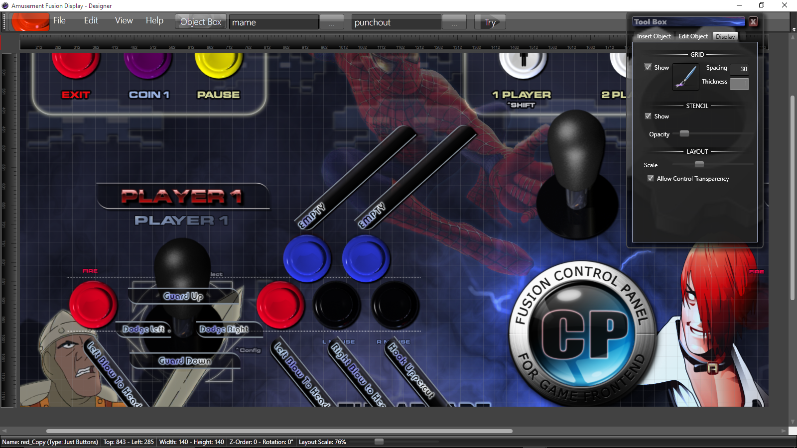

spotUP Posted March 15, 2016 Posted March 15, 2016 AFD.png WHAT... THE... HELL....???? THIS IS SOOOOOO COOOOOOOOOOOOOOOOL!!!! So this is what you guys hinted at in the PM!!!
sevenseal Posted March 15, 2016 Posted March 15, 2016 WHAT... THE... HELL....???? THIS IS SOOOOOO COOOOOOOOOOOOOOOOL!!!! So this is what you guys hinted at in the PM!!!i didnt hint anything i swear...

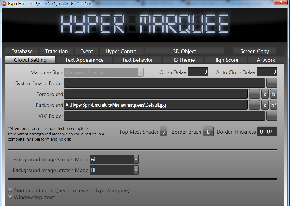

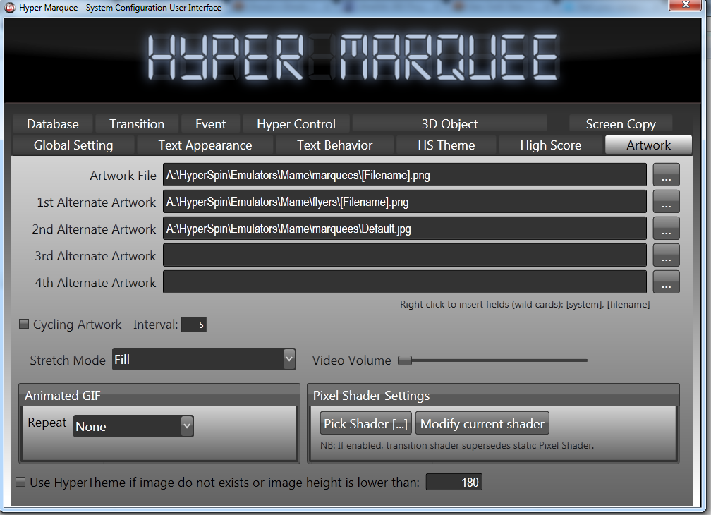

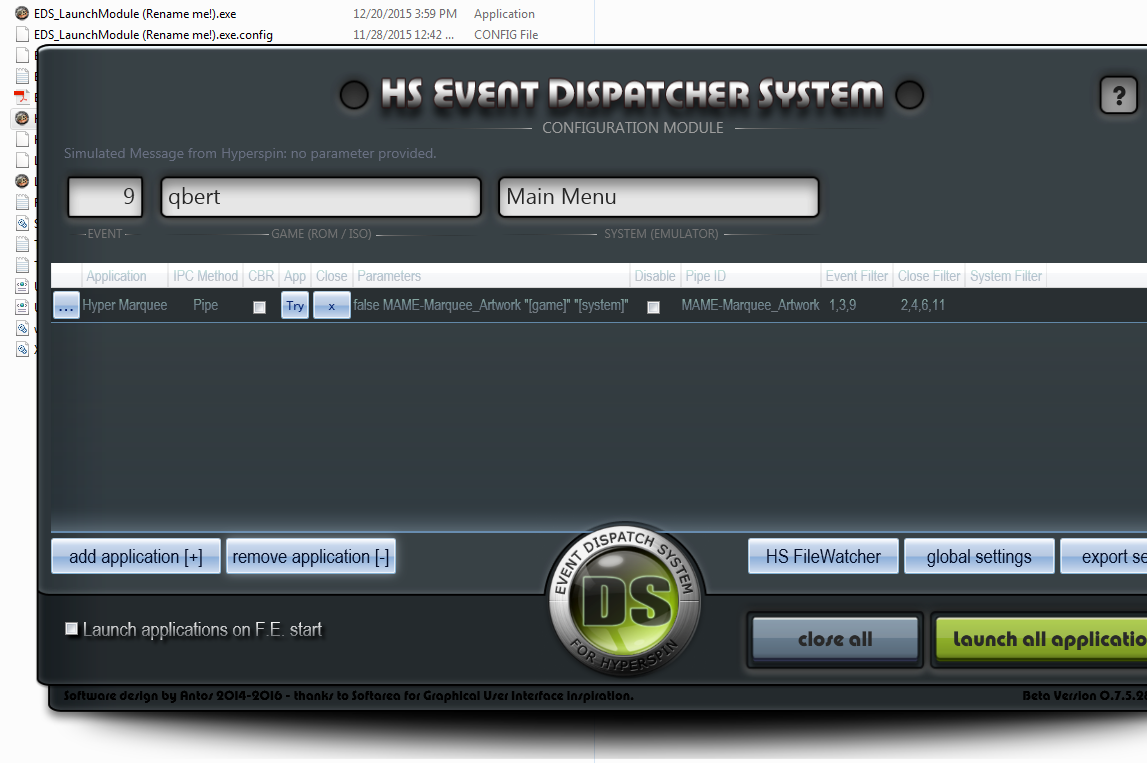

sevenseal Posted March 19, 2016 Posted March 19, 2016 There is only one HM instance. All I am doing is displaying marquee images on a smaller secondary monitor, nothing else. Just for mame right now. I'm attaching captures of the interfaces. Thanks for your help! EDS.pngHMglobal1.pngHMartwork.png we actually need the files... there are other elements that are not visible in your picture. 1. i can tell off the start it is something relating to your eds setting. which can be discussed in the eds thread. 2. it will help to turn off edit mode while in actual use. HM function differently depend what mode you place it in. 3. if you want it to function smoother, faster, better.... you will need to follow what antos had point you do by reading over the guides., knowing about events triggers majorly help with how things come out. not knowing them leaves much things to be not desired.
Antos Posted March 20, 2016 Author Posted March 20, 2016 Thank for posting some images. Like sevenseal's is saying the files may help better. From what I can see, there is nothing wrong obvious with your setup. Quick questions; - Is your issue occurs on every image change? - A:\? Is this drive is a network one? Is it quick? - For EDS, can you click the checkbox on bottom left? (Lauch application on FE Starts) - Do you use any transition? HyperMarquee & Event Dispatch System
