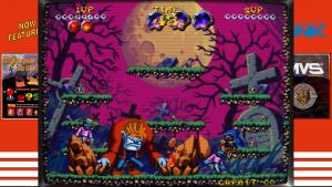

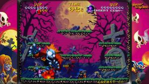

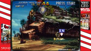

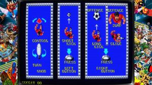

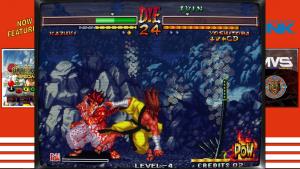

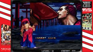

Metalzoic Posted January 12, 2016 Posted January 12, 2016 UPDATED: 1/18/161.Overhauled. Fixed black levels/color. Updated pics to show new version.2. Bit more fine tuning. These settings were built by comparing my HyperSpin cabinet directly, side-by-side, with my real arcade machines. For direct comparison I used my Mario Bros machine and my Neo-Geo running Samurai Shodown 5 Special, Nightmare in the dark, Metal Slug and Twinkle Star Sprites. I tried to match these settings to look close to the real machines, but with a bit more ideal color and sharpness.These were set with Contrast, Brightness & Gamma at 1.00. However games vary a lot so I tried to set it saturated and bright enough that it displays darker games well, and brighter games can be adjusted by lowering the brightness, contrast and/or gamma. Still tinkering to find the best middle ground.Hopefully some of you find they work on your setup. Gigapig mentions this below, but make sure you're using the latest Artwork & HLSL folders (If you've updated MAME, but not the folders this won't display correctly). This uses the slot-mask.png mask. HLSL # # DIRECT3D POST-PROCESSING OPTIONS # hlsl_enable 1 hlslpath hlsl hlsl_prescale_x 6 hlsl_prescale_y 6 hlsl_write 1 hlsl_snap_width 2048 hlsl_snap_height 1536 shadow_mask_tile_mode 0 shadow_mask_alpha 0.14 shadow_mask_texture slot-mask.png shadow_mask_x_count 6 shadow_mask_y_count 4 shadow_mask_usize 0.1875 shadow_mask_vsize 0.1875 shadow_mask_uoffset 0.0 shadow_mask_voffset 0.0 curvature 0.10 round_corner 0.10 smooth_border 0.03 reflection 0.05 vignetting 0.20 scanline_alpha 0.92 scanline_size 1.00 scanline_height 0.95 scanline_bright_scale 1.20 scanline_bright_offset 0.55 scanline_jitter 0.05 defocus 0.50,0.0 converge_x 0.2,0.0,-0.1 converge_y 0.0,0.0,0.0 radial_converge_x 0.2,0.0,-0.2 radial_converge_y 0.0,0.0,0.0 red_ratio 0.80,0.10,0.10 grn_ratio 0.10,0.80,0.10 blu_ratio 0.10,0.10,0.80 saturation 1.40 offset -0.03,-0.01,0.03 scale 0.97,0.99,1.0 power 1.30,1.35,1.30 floor 0.00,0.00,0.00 phosphor_life 0.45,0.35,0.40 BLOOM # # BLOOM POST-PROCESSING OPTIONS # bloom_blend_mode 0 bloom_scale 0.175 bloom_overdrive 1.0,1.0,1.0 bloom_lvl0_weight 1.0 bloom_lvl1_weight 0.21 bloom_lvl2_weight 0.19 bloom_lvl3_weight 0.17 bloom_lvl4_weight 0.15 bloom_lvl5_weight 0.14 bloom_lvl6_weight 0.13 bloom_lvl7_weight 0.12 bloom_lvl8_weight 0.11 bloom_lvl9_weight 0.10 bloom_lvl10_weight 0.09

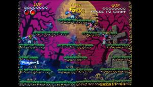

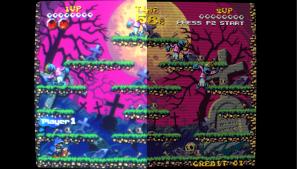

gigapig Posted January 12, 2016 Posted January 12, 2016 Here is a side by side on my machine from the settings in the OP. Looks quite different to the screen shots that Metal posted. HLSL left. GLSL right.
AshuraX Posted January 12, 2016 Posted January 12, 2016 hlsl is blurry and shiny! My WIP Projects :Bezel Project Mame Horizontal : https://imageshack.com/a/auM4/1 Mame Vertical : https://imageshack.com/a/jEM4/1 Cave full pack : https://imageshack.com/a/7eJ4/1 Capcom : https://imageshack.com/a/eIM4/1 Themes Neo Geo Full Theme Pack : https://imageshack.com/a/oeJ4/1Mega CD Boxart : new thread will come....My First Cab Build : http://www.hyperspin-fe.com/topic/1221-ashurax-mon-projet-ghouls-ghost-arcade-cab/
gigapig Posted January 12, 2016 Posted January 12, 2016 Hang about. I thought the difference was to great and there must be something a miss. So I grabbed the latest hlsl folder from the Mameuifx site and this is the new result. These look closer to the OP screen shots. HLSL Left. GLSL Right. Looks to me that HLSL loses some detail and has weird fringing around the Moon. GLSL seems slightly darker but not as washed out. EDIT:The fringing is only on the left side of the moon anyway, so ignore the above.

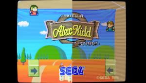

gigapig Posted January 12, 2016 Posted January 12, 2016 Here's another. I usually test Alex Kidd as it's quite a bright game to start with instead of games with black backgrounds.
AlexDC22 Posted January 13, 2016 Posted January 13, 2016 ahh fuck that lol i dont see it being better at all... the details and colors are way better on the glsl no offence to anyone... everyone gots theyr favorite, ill stick with glsl for now

Metalzoic Posted January 17, 2016 Author Posted January 17, 2016 OK here's a new one. The one above very closely mimics a real arcade machine that has been sitting in an arcade, powered on for years with thousands of plays on it. This new one is more of an ideal fresh-off-the-assembly-line build. Still very true to the real machines I use, but tightened up with less bleed and a bit sharper convergence. Slightly less wash and color corrected so there's less fade across red. Give it a shot and let me know what you think. Gigapig mentioned this above, but make sure you're using the latest Artwork & HLSL folders (If you've updated MAME, but not the folders this won't display correctly). This uses the slot-mask.png mask. EDIT: Made some minor color corrections. EDIT AGAIN: Few more fine tunes. EDIT FINAL: Settings redone to fix color issues. Updated in the first post.
