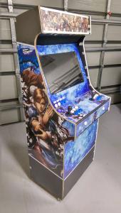

meancun Posted July 17, 2015 Posted July 17, 2015 Hi all, Though of popping 2 cherries at once here. Posting in a forum for the first time, and also my first arcade cabinet! Progress pics so far, not completed. So let me know what you think and any feedback. Thanks all
HazzardActual Posted July 17, 2015 Posted July 17, 2015 awesome dude, are you going to continue that same color scheme? Not too far away from finishing it looks like, just some tmolding a marquee and a bezel
meancun Posted July 18, 2015 Author Posted July 18, 2015 Yep, that theme will cover the whole cabinet. ive got white t-mould, which ill add once the sides are on. then add the bezel to finish it off. I've got the plexi glass for the bezel, just need to think of some art for that, then install the light. Alsomt there!!!

Metalzoic Posted July 18, 2015 Posted July 18, 2015 On 7/17/2015 at 3:28 AM, meancun said: Hi all, Though of popping 2 cherries at once here. Posting in a forum for the first time, and also my first arcade cabinet! Progress pics so far, not completed. So let me know what you think and any feedback. Thanks all Looking pretty good. Looks like you might be able to go bigger on the monitor. How wide is the interior width? Instead of Plexiglass to cover the screen have you considered tinted, tempered glass instead to give it a more authentic arcade cab look? The tinted glass really helps to hide the monitor glass.
meancun Posted July 19, 2015 Author Posted July 19, 2015 Thanks guys for the positive reinforcement. First off: On 7/18/2015 at 8:10 PM, Metalzoic said: It's so weird to me that both you and Giga, 2 of the most helpful people here, don't have cabs. I totally agree! If you too spent more helping yourselves instead of others hahaha. Love your work Austin, thanks Yeh plexi glass is just so much easier to work with and its free for me So i will be covering it with a bezel around the monitor screen (23" widescreen - also free, so cant be choosy) to match the theme i have. The overall width is 700. The original plans were 600, but i felt it was too tight for 2 players. So less the 32mm of MDF side panels, the interior width is 668mm. Im disappointed because the week after i put it together, i found a 32" tv on the side of the road in council clean up that i can recover. Just too small! I just need to have patience, i dont think this will be my last cabinet build Thanks guys

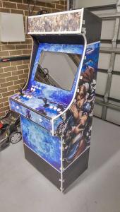

meancun Posted August 13, 2015 Author Posted August 13, 2015 Ok guys, so i've progressed a little further with the cabinet. It's looking more complete, and it's almost there. I've uploaded a few new images. Let me know what you think.
chrisvond Posted August 14, 2015 Posted August 14, 2015 Sorry for the Noob question, but what do you use to stick the t-mould down with, I see you have tape, are you waiting for something to set?
sucramjd Posted August 14, 2015 Posted August 14, 2015 did you use the wrong router bit? t moulding is tricky to get right, use some hot glue that stuff works very well so I'm told, god I'm itching to redo my cab, but my house needs sorting out first, cab looks great matey [sIGPIC][/sIGPIC]
pacooka Posted August 14, 2015 Posted August 14, 2015 looks great, what is the resolution for the image you used ? (mm & dpi for the side art) Sent from my iPhone using Tapatalk
meancun Posted August 24, 2015 Author Posted August 24, 2015 Yeah i needed a 3mm straight router bit. I already had a 4mm, and didnt want to rely on it just squeezing in, and unless i ordered from overseas, was finding it hard to get a 3mm. Also, would have cost me $40!!!! The whole cabinet cost me $300 to build, so i couldnt justify $40 for a router bit, so i used Heavy Duty strength Liquid Nails (construction adhesive). It was very fiddley around the tight corners and kept popping out. So i taped it down and let it set overnight and it's not going anywhere! The image was just from Google images, so luckily it was fairly high res already. You can see some pixelation up close, but not fussed about that. I'd say it was 300dpi, but i had to stretch it about 300%. Thanks for the compliments everyone.
