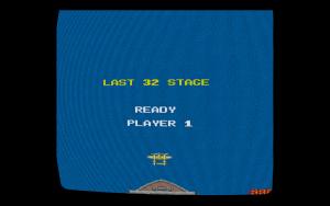

pacooka Posted September 28, 2015 Posted September 28, 2015 Is it possible to fix the glsl on the edges (right & left) snap attached,
gigapig Posted September 28, 2015 Posted September 28, 2015 Pacooka that looks bloody terrible, how did you get it to look so bad? Lol

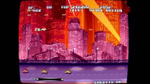

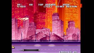

tuirennder Posted September 28, 2015 Posted September 28, 2015 I have the same issue, actually: assymetric edges, and I think it has always been like this with some games: (mame165, hlsl, brightness boosted to see the edges)
gigapig Posted September 28, 2015 Posted September 28, 2015 Is this a resolution issue? Has everyone downloaded the latest 0.165 GLSL files not just swapped out the exe. If you want to attach your mame ini's here I'd like to have a look. tuirennder, what game is that?
tuirennder Posted September 29, 2015 Posted September 29, 2015 The game is Last Resort, but now I see that for me it's not even HLSL specific, I still have a truncated right edge with HLSL completely off. I have the same problem in Metal Slug 1 too, but not all the neo geo games ... perhaps I have a bad bios ... But the roms should be OK, I passed them through clrmamepro.

pacooka Posted September 29, 2015 Posted September 29, 2015 Pacooka that looks bloody terrible, how did you get it to look so bad? LolCan't tell why... will try to find a different glsl, i'm using CRT-geom.vsh
D1RT33B1RD Posted September 29, 2015 Posted September 29, 2015 Change it to Lottes for vertical games and see if that's better. I had a simliar problem that I couldn't solve, even though I think Geom is the better shader.
pacooka Posted September 29, 2015 Posted September 29, 2015 Change it to Lottes for vertical games and see if that's better. I had a simliar problem that I couldn't solve, even though I think Geom is the better shader. Lottes works very slow with my GT 730 VGA card (core 2 duo 2.4Gh CPU...), maybe my CRT-geom.vsh was modified by someone on the internet, don't know, will try to find a better one. Can't register on http://mame32fx.altervista.org/ somehow , still waiting for the administrator approval
pacooka Posted September 29, 2015 Posted September 29, 2015 OK, just got the access to http://mame32fx.altervista.org/ , GLSL works ok for ver & Hor now... i'm happy :-) But I decided to try and upgrade my 0.162 to 0.165, any input/known issue regard latest version - 0.165 ?
