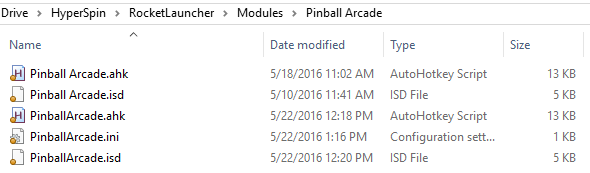

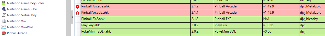

DJQuad Posted May 22, 2016 Posted May 22, 2016 I made a boo-boo somewhere. I followed the directions, naming the files PinballArcade.AHK and the other PinballArcade.isd - The error for the one with a space is "Module has a duplicate ID" The error for the one without a space is "Module has a duplicate ID" and Bad CRC. I tried deleting the one without the space but I still get the CRC error and can't use it.

Metalzoic Posted May 23, 2016 Author Posted May 23, 2016 I made a boo-boo somewhere. I followed the directions, naming the files PinballArcade.AHK and the other PinballArcade.isd - The error for the one with a space is "Module has a duplicate ID" The error for the one without a space is "Module has a duplicate ID" and Bad CRC. I tried deleting the one without the space but I still get the CRC error and can't use it. It can't have a space, that one will never work. Duplicate I'd isn't an error, just RL telling you you have 2 versions of a module. Normal if you keep multiple or custom versions. Not sure about the CRC thing. Never seen or had anyone else have that before. Sent from my SM-G935V Edit: that's using the module and isd from the first post here? Also if you have the latest version of RL it seems to cause some issues.

DJQuad Posted May 23, 2016 Posted May 23, 2016 It can't have a space, that one will never work. Oh ok. Your original post said to name it without spaces and to leave the rest alone. Duplicate I'd isn't an error, just RL telling you you have 2 versions of a module. Right, but when that happens neither can be used. They both get disabled. Also if you have the latest version of RL it seems to cause some issues. I am. Is that the problem? I'm building an arcade cab that does have pinball buttons on the sides. Is Pinball FX a better solution?
Metalzoic Posted May 24, 2016 Author Posted May 24, 2016 Oh ok. Your original post said to name it without spaces and to leave the rest alone. Right, but when that happens neither can be used. They both get disabled. I am. Is that the problem? I'm building an arcade cab that does have pinball buttons on the sides. Is Pinball FX a better solution? Sorry, I confused the issue with my earlier post. When you rename the .exe you use no space (PinballArcade.exe) capital P & A. The module, isd, ini and database are named normally with a space. Pinball Arcade. You should be able to have a bunch of different modules that are nearly the same and have them work right (I have 6 or 7 red modules in mine), but they do have to be named differently. So whichever of those 2 is the wrong one maybe re-name to "Pinball Arcade - RL version" or something to see if that fixes it. The latest version of RL could simply be the issue, the new official module doesn't navigate correctly and the newest version of RL seems to have a lot of issues. Not just with TPA, but several systems. I had to completely revert to the prior version to get my cab working again. Not saying that's it, but it could be.
