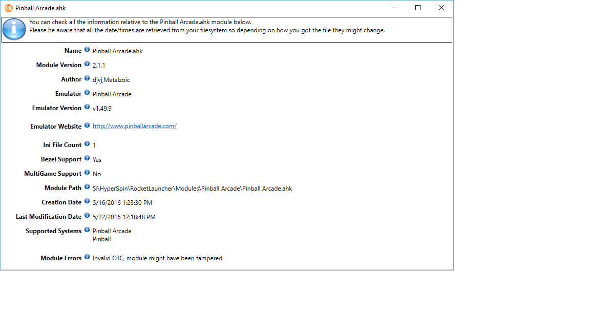

DJQuad Posted May 24, 2016 Posted May 24, 2016 The module, isd, ini and database are named normally with a space. Pinball Arcade. I now have only 3 files in the modules directory, all have spaces. Pinball Arcade.ahk, Pinball Arcade.ini, and Pinball Arcade.isd. Here's the CRC error - Launching it in HyperSpin says cannot find Pinball Arcade.ini
Metalzoic Posted May 24, 2016 Author Posted May 24, 2016 I now have only 3 files in the modules directory, all have spaces. Pinball Arcade.ahk, Pinball Arcade.ini, and Pinball Arcade.isd. Here's the CRC error - Launching it in HyperSpin says cannot find Pinball Arcade.ini This is using the module & isd from the first post in this topic?
Metalzoic Posted May 24, 2016 Author Posted May 24, 2016 I decided to double check for you so I deleted my current module and isd. Then I re-made them using the links in the first post here. It all works perfectly, fired up in both RL and HS first try, navigated as it should etc... So the module and isd are good. The problem may simply be that the module isn't compatible with the newest RL update. You may have to use the module that downloads with the update instead. Problem with that is that that module doesn't seem to navigate the tables properly. Or maybe you just need to delete one of the modules you have that has an identical CRC? Not sure as I've never had anyone have that problem before.

Metalzoic Posted May 25, 2016 Author Posted May 25, 2016 Wait. Earlier I thought you meant RL was throwing an error screen saying "crc error" when you tried to launch a table. The normal black screen with error dialogue box. Is that right? Or are you just talking about how it says "Invalid CRC" on the module info screen... because like I said earlier that's normal. All 6 of my TPA modules say that. If it's saying can't find Pinball Arcade.ini maybe it's borked. You should be able to delete it and just re-do your module settings to create a new one. That should fix that. Here's the module. This is a copy of the one in the tutorial post. Pinball Arcade.ahk You can't attach isd files, so here it is as a TXT file, just change the extension from .txt to .isd and it should work fine. This is also exactly the same as the one in the tutorial link. Pinball Arcade.txt
DJQuad Posted May 25, 2016 Posted May 25, 2016 Or are you just talking about how it says "Invalid CRC" on the module info screen... because like I said earlier that's normal. All 6 of my TPA modules say that. If it's saying can't find Pinball Arcade.ini maybe it's borked. You should be able to delete it and just re-do your module settings to create a new one. That should fix that. Yeah I thought the CRC error was causing some sort of issue rather than it just be a warning. I'm still getting the ini error even after deleting and recreating it. If it matters - [settings] Pinball_Version=DX11 All_Tables=false My_Tables=Tales of the Arabian Nights (Williams) Start_Game=false
Metalzoic Posted May 25, 2016 Author Posted May 25, 2016 Strange. It says can't find ini? So you deleted it completely so there was no .ini in your modules/pinball arcade folder, then went into the RL module settings and re-set your settings, which made RocketLauncher auto-create a new one for you, but it still can't find it? That's really weird since RocketLauncher creates it and names it itself. You only have the Arabian Nights table, that must mean that you are trying to set this up with just the demo version/free table right? I also noticed that your settings are in a bit different order than mine... not that I necessarily think that matters. Here's mine. [settings] Fullscreen=true Start_Game=false Pinball_Version=DX11 All_Tables=true

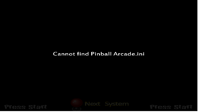

DJQuad Posted May 25, 2016 Posted May 25, 2016 Correct on all 3 questions. I'm pretty sure the order written to the ini is just the order that you change them in RLUI Is there any way to see what specific path it's looking for when that error happens? S:\HyperSpin\RocketLauncher\Modules\Pinball Arcade>dir Volume in drive S is HyperSpin Directory of S:\HyperSpin\RocketLauncher\Modules\Pinball Arcade 05/25/2016 02:14 PM <DIR> . 05/25/2016 02:14 PM <DIR> .. 05/25/2016 02:06 PM 120 Pinball Arcade - Copy.ini 05/25/2016 01:31 PM 12,447 Pinball Arcade.ahk 05/25/2016 02:15 PM 120 Pinball Arcade.ini 05/25/2016 01:31 PM 4,298 Pinball Arcade.isd 4 File(s) 16,985 bytes
Metalzoic Posted May 25, 2016 Author Posted May 25, 2016 Crazy... Sure, just set your RLUI logging to troubleshoot, then search through the huge logfile for arcade.ini to see what in the world it's doing. Maybe it will show the path it's checking. Since RL created, named and placed the ini itself yet can't find it, it seems like it must be some weirdness/glitch caused by the new version of RL. There were other systems that had similar issues of RL looking in the wrong spot for stuff. There's a post on the front page right now with SNES not seeing a file even though it's there. I don't know man... Sucks.
Metalzoic Posted May 25, 2016 Author Posted May 25, 2016 If I'm not mistaken, that's an HS error not an RL error. So HyperSpin can't find the HyperSpin/Settings/Pinball Arcade.ini to populate the wheel and whatnot. Ah, like it isn't setup in HyperHQ yet then. I should have noticed it wasn't the RL dialogue error box in that pic. That should be an easy fix.
DJQuad Posted May 25, 2016 Posted May 25, 2016 What should I do? Just copy the ini to HyperSpin/Settings/Pinball Arcade.ini? Sorry for moving slow about this, I treat stuff like this like a crime scene, not touching a thing. I did notice there's no Pinball Arcade.ini in HyperSpin/Settings

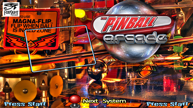

DJQuad Posted May 26, 2016 Posted May 26, 2016 Almost there! The wheel loads in HyperSpin but doesn't actually launch the game. Nothing happens. Is this right?

DJQuad Posted May 28, 2016 Posted May 28, 2016 I'm trying to use as the main menu video but it's not showing - It's named Pinball Arcade.mp4 and plays fine outside of HyperSpin. I can upload if needed.
Metalzoic Posted May 29, 2016 Author Posted May 29, 2016 If it is an MP4 and you have it in the right folder (and named/capitalized right) it should work. Even if the video is bad you should have something show in the video frame. Make sure you have it in hyperspin/media/main menu/video and not in hyperspin/media/pinball arcade/video Sent from my SM-G935V
DJQuad Posted May 29, 2016 Posted May 29, 2016 Yeah that's where it is. I uploaded it to https://mega.nz/#!vVUnTADJ!DBUnAwjpAKRLi2YP5uuq2XOokcdPmyIDajkfvjEKUdk
