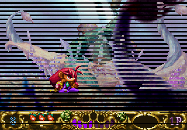

cowbells Posted September 22, 2015 Posted September 22, 2015 I've always had problems with Astal. I can load the game, but I get this: Anybody have an idea of what this is? I've tried multiple SSF versions, multiple disc images. This problem is with 0.12 Beta R4
cowbells Posted September 22, 2015 Posted September 22, 2015 Ok, I got it. SSF v0.12 Beta R1 is making this game run flawless for me now. First time I've been able to get it. I thought I tried that one before, but I must not have. Whooop! Edit: Man, now I can't get it to load in Rocket Launcher. This game has always given me problems. Oh well, at least I can play outside of HS now.

JoeC3109 Posted September 22, 2015 Posted September 22, 2015 You have to have "SH1 Cache" enabled from what I remember regarding Astal. Looks like you at least got it starting though, so I doubt thats the problem
Styphelus Posted September 22, 2015 Posted September 22, 2015 Thanks for this list. Went to try out SSF and got a black screen. It was working fine last time I tried it. Man oh man. Why do these things happen???
cowbells Posted September 22, 2015 Posted September 22, 2015 On 9/22/2015 at 10:21 AM, JoeC3109 said: You have to have "SH1 Cache" enabled from what I remember regarding Astal. Looks like you at least got it starting though, so I doubt thats the problem Yep! The setting is actually SH2 Cache The problem I'm having is that the game launches and plays fine outside of Rocket Launcher. When I launch with RL, I get a black screen. This is the weirdest thing, if I mount the game and open that same version of ssf, I can see that RL has messed with the settings (for example, after launch I can't uncheck SH2 Cache anymore) and it still doesn't work, but if I open the settings, close them, close the emulator and relaunch it, it works every time. Rocket Launcher is doing something in the module to screw up me playing Astal as far as I can tell. Does anyone have this game launching fine using Rocket Launcher? Btw, I'm going through all my Saturn games to see if they launch. Most games appear to work, but some are giving me problems. For the problematic games, I'm simply checking this compatibility list: http://www.segasaturn.org/ and using the recommended emulator version. So far, everything I've tried has worked fine once I make an alternate emulator. I'll post a guide on how to make every game work when I'm done. So far, everything has been hunky dory except Astal. Best I can get is the messed up screen launching from RL. I've known this was a problematic game for awhile now. If someone can help me with that one, I'd really appreciate it.

cowbells Posted September 22, 2015 Posted September 22, 2015 On 9/22/2015 at 9:00 PM, gigapig said: Cowbells. I don't get those graphics issues, I can play the game briefly but it does crash for some reason. Some thing else to figure out. Hmm... wonder if it's because I'm on Windows 7. I'm going to come back to this issue later. I read on another forum though that you can enable SH2 Cache, load Astal, create a savestate, then disable SH2 Cache. Next time you load, you can load the savestate and the game will work without crashing. I found this works for me too, outside of RL at least. With Beta R1, I've had zero problems with the game at all though. My only issue is launching the game from Rocket Launcher, but I'll look at it later.
