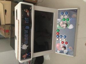

eezetee Posted October 26, 2015 Posted October 26, 2015 I built an i7 into this bartop. Then I swapped it out for a Dell 3043 touch screen which works perfect (although less of a performer than the i7)
