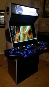

scoodidabop Posted November 14, 2015 Posted November 14, 2015 Love me some NASA! See if you can spot all the movie references. Full build log here: http://imgur.com/a/jWjTR
Goodboyparker Posted November 14, 2015 Posted November 14, 2015 Really a great job. You mentioned cutting the multiple layers of the control panel by hand - I would suggest looking for a water jet cutter near you. They can quickly and precisely cut through materials. It probably isn't cheaper, but it would save some time. Your cabinets look like they are more than a hobby for you... FYI - Mike
scoodidabop Posted November 17, 2015 Author Posted November 17, 2015 Really a great job. You mentioned cutting the multiple layers of the control panel by hand - I would suggest looking for a water jet cutter near you. They can quickly and precisely cut through materials. It probably isn't cheaper, but it would save some time. Your cabinets look like they are more than a hobby for you... FYI - Mike Haven't looked into water jet cutters around here. I'll keep that in mind!
shitoken Posted November 18, 2015 Posted November 18, 2015 Great build very good job.But why do we need so many credit button for each player ?
Metalzoic Posted November 18, 2015 Posted November 18, 2015 Damn. That is a really nice, clean build.
scoodidabop Posted November 20, 2015 Author Posted November 20, 2015 Great build very good job. But why do we need so many credit button for each player ? Credit/Red, Start/White. The 4 colors buttons on the far right of the control panel play NASA archive sounds Damn. That is a really nice, clean build. Thanks!
albert_c Posted November 21, 2015 Posted November 21, 2015 Windows can bee seen in such a beautiful cab!! In all seriousness, beautiful job. That CP is amazing. When you find great deals on Craigslist for CRT based cabs, exuberance can be a bad thing! Current status of cabs: 0/5 working as desired :wallbash:
scoodidabop Posted November 23, 2015 Author Posted November 23, 2015 Windows can bee seen in such a beautiful cab!! In all seriousness, beautiful job. That CP is amazing. Oops! I think this is the only pic I took with HS actually running;

Kellogs Posted December 3, 2015 Posted December 3, 2015 Hi Scoodidabop what an amazing Job, love the green lighted Controllboard :-) I am planing to build a cab too and I am wondering about the parts like Trackball and Spinner. Are these USB connected items? If not, what kind of controller do you use for that ? I allready have an IPAC 4, hope it will work with this one too. Greetings for Germany Kellogs
scoodidabop Posted December 3, 2015 Author Posted December 3, 2015 Hey Kellogs. Hi Scoodidabop what an amazing Job, love the green lighted Controllboard :-) I am planing to build a cab too and I am wondering about the parts like Trackball and Spinner. Are these USB connected items? If not, what kind of controller do you use for that ? I allready have an IPAC 4, hope it will work with this one too. Greetings for Germany Kellogs Head right back to the site that sells the IPAC4! I use Ultimarc trackball and spinners which are indeed USB. http://ultimarc.com/trackball.html
