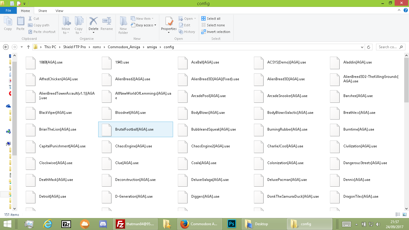

thatman84 Posted September 24, 2017 Posted September 24, 2017 this is all I use in hyperspin Commodore Amiga AGA.ini Hyperspin 2.0 Latest Download Hyperspin 2.0 Documentation -------Pre Hyperspin 2.0 Below---------- HS Android Overview & Install HS Android Base Pack Download My Tutorials

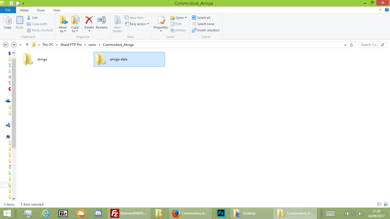

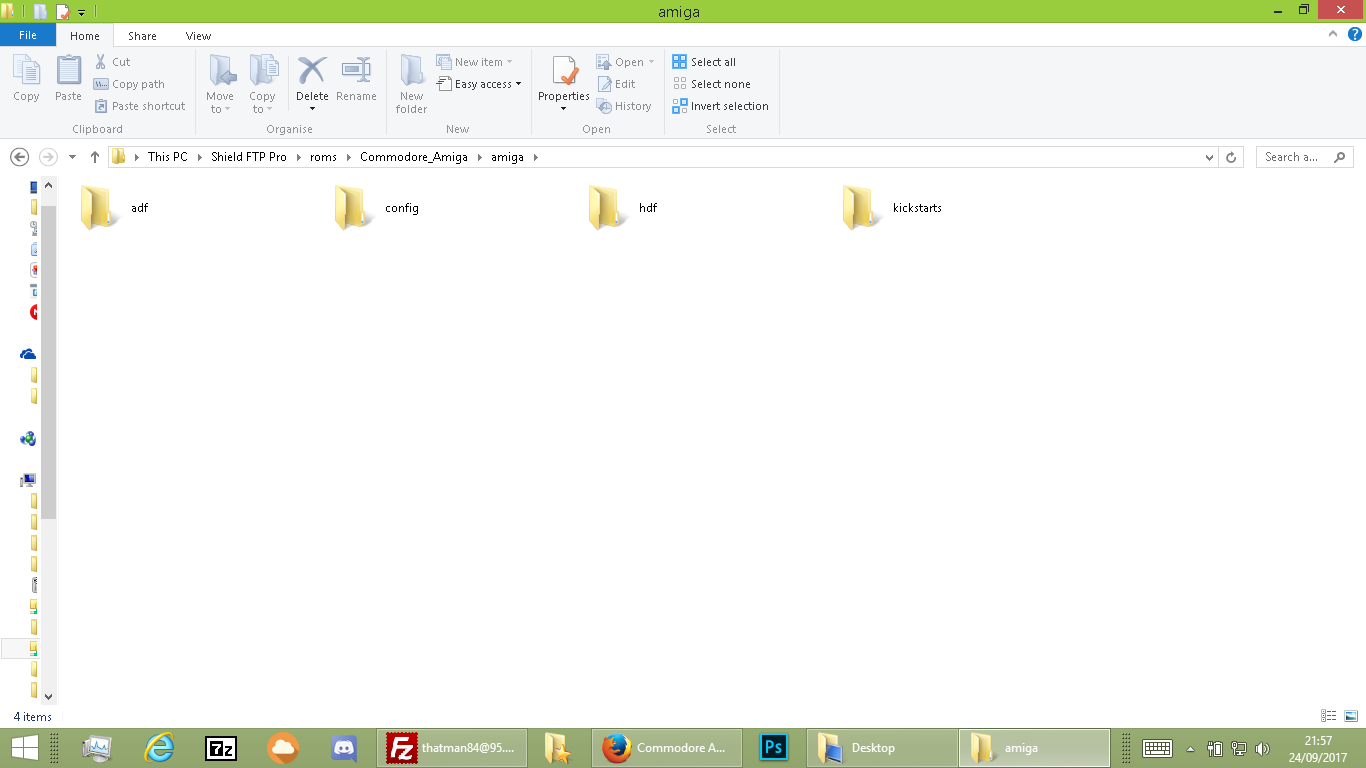

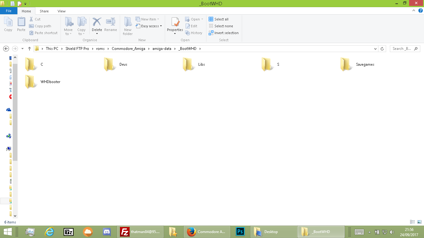

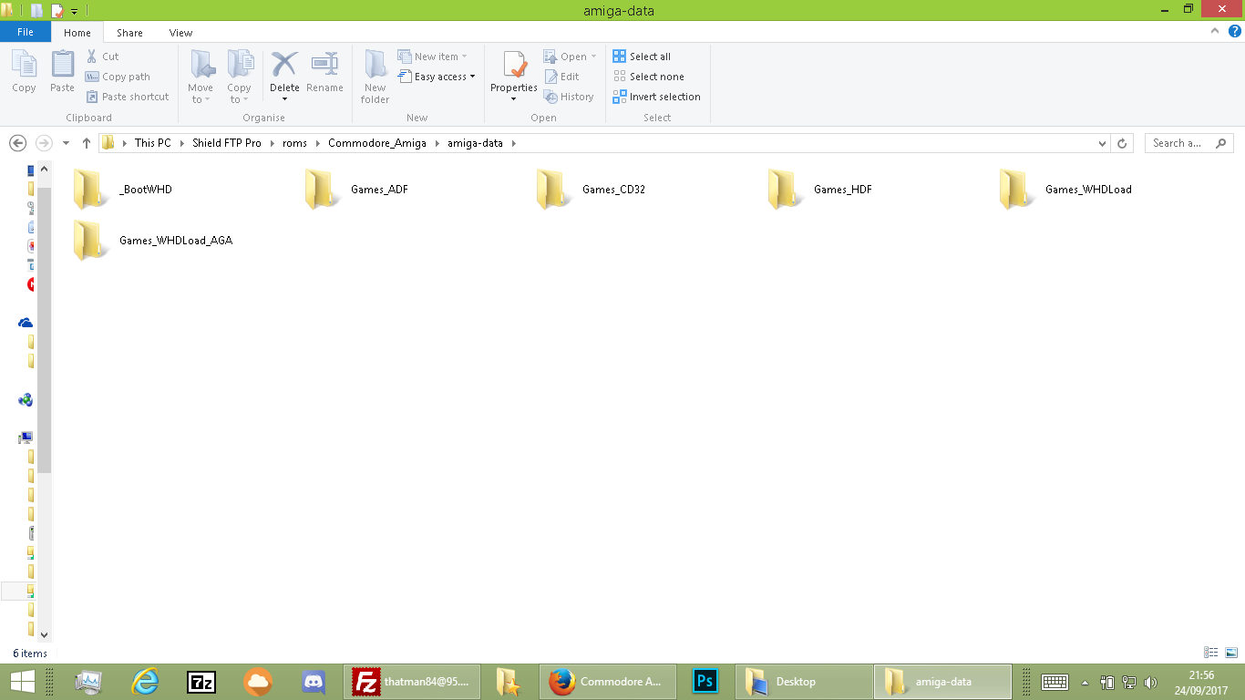

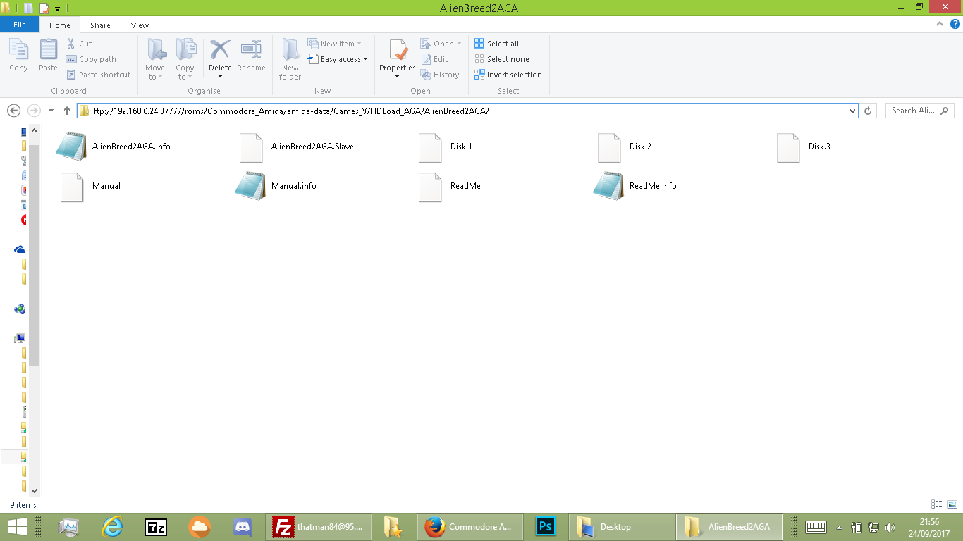

thatman84 Posted September 24, 2017 Posted September 24, 2017 this is all my folder layouts for reference. I never properly sorted all my kickstarts but most games launch fine Config file 1943.uae Hyperspin 2.0 Latest Download Hyperspin 2.0 Documentation -------Pre Hyperspin 2.0 Below---------- HS Android Overview & Install HS Android Base Pack Download My Tutorials

thatman84 Posted October 4, 2017 Posted October 4, 2017 Thanks for the info/files I will take a look tonight. as for the issue I noticed I have my uae4arm config file path set to the default. Maybe you could point Hyperspin to that folder instead of copying them out. also I believe spaces and special characters are not supported for .uae file names to launch with uae4arm. Hyperspin 2.0 Latest Download Hyperspin 2.0 Documentation -------Pre Hyperspin 2.0 Below---------- HS Android Overview & Install HS Android Base Pack Download My Tutorials
Honosuseri Posted October 4, 2017 Posted October 4, 2017 59 minutes ago, thatman84 said: Thanks for the info/files I will take a look tonight. as for the issue I noticed I have my uae4arm config file path set to the default. Maybe you could point Hyperspin to that folder instead of copying them out. also I believe spaces and special characters are not supported for .uae file names to launch with uae4arm. I went one better and just set the UAE4ARM conf folder to where HyperSpin is looking. Any configs I make are then stored there but still need to be renamed as I can't capitalise letters when saving in UAE4ARM...it's seriously annoying. I do realise the config maker is supposed to be "tracking" games and making adjustments for each game to make them fit the screen better etc. BUT I don't have an RPI anymore. I spent some time making up .uae's for the more popular games last night. I found it odd that I have better success with Workbench and WHDload than I do with the WHDbootloader. I enabled the Amiga DOS screen when loading now to see the errors...I'm getting "out of variable space" WHDbooter/messagedisplay.exe failed returncode 28" on the games that were "black screening". I'm now trying with a different WHDload folder set (i.e exactly what you have) and seem to be having more luck (makes sense as they are part of the "package" I suppose). The fact "my original set" are loading just fine in Workbench had thrown me off a bit. These "new WHDload folders" appear to work well in Workbench too which is a bonus so I can utilise both methods of loading the games. Once I have a decent selection I'll upload another video. Thanks again for all your insights. "There is so much more and beckons me. To look through to these, infinite possibilities..."
