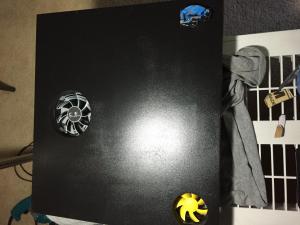

Pacodelucia Posted March 24, 2016 Posted March 24, 2016 It's best to have an intake and an exhaust setup. You are getting rid of the heat building up in the cabinet but are not supplying cool air to circulate in the cabinet. I'm almost finished building my first Bartop finishing the rear panel. As you can see, your intake doesn't need to be as large as your exhaust. You want to get rid of more air than what you have going in. More towards negative air flow than positive. Hope this helps.
