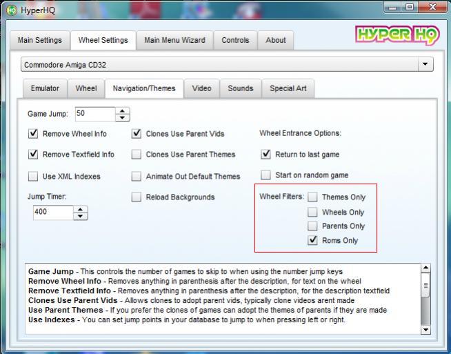

32assassin Posted September 11, 2013 Posted September 11, 2013 you can do this two ways, as mentioned all 2 player games are clones of 4 player games filter out all clone games, ONLY PARENT ROMS WILL SHOW UP IN YOUR WHEEL removed the rom name inside the line <cloneof>simpsons</cloneof> and then add the 2 player name to the 4 player entries your 4 player line should look like this:<cloneof>simpsons2p2</cloneof> filter by themes, ONLY GAMES WITH THEMES WILL SHOW IN YOUR WHEEL rename your themes to match the 2 player rom names simpsons 4 player name: simpsons simpsons 2 player name: simpsons2p2

32assassin Posted April 3, 2015 Posted April 3, 2015 sorry cowbells but that is not a good idea This is only an option if you only want a selective number of games (most popular). You can't use the Themes or Wheel Only filter because many games are still missing their media (themes or wheels). if you don't have the theme you will not have the game listed in your Hyperspin wheel. I wouldn't recommend messing with the database. The reason is this. Let's say you edit these two games, then later, you want to update your MAME romset and database. Now, you have to go back and edit the xml again. And you'd have to do this every time you update. If you end up doing this to 20 games, well, then it's going to suck updating. With the method I described, you leave the xml alone and just have Hyperspin filter the data for us. This way, you don't have to worry about editing anything every time you update. Yay computers! this is exactly what I do. I wish their was a program to automatically edit your XML based on certain criterias. Until then I will do it manually; given that MAME is only updated once every other month its not such a bad task. I actually have a cheat sheet to help me update my XML. it started as a list of 4 player games up its been expanded to add pauline and fix it felix I also added more clone to parent games such as speed hacks for Ms. Pac-man, Galaga and Ikari Warriors 4 way joystick hack. when a new version of MAME is released, I updated my roms, update my exe. when Brolly releases the new XML, I open my cheat sheet file and go down the list and make all this changes. <game image="" index="" name="FixitFelixJr"> <description>Fix it Felix Jr</description> <cloneof></cloneof> <crc/> <manufacturer>TobiKomi</manufacturer> <year>1985</year> <genre>Platform</genre> <rating>AAMA - Green (Suitable For All Ages)</rating> <enabled>Yes</enabled> </game> <game image="" index="" name="dkongpne"> <description>Donkey Kong Pauline Edition</description> <cloneof></cloneof> <crc/> <manufacturer>Hack</manufacturer> <year>2013</year> <genre>Platform</genre> <rating>AAMA - Green (Suitable For All Ages)</rating> <enabled>Yes</enabled> </game> (NO NEED TO CHANGE) 2 player parent, 4 player clone Atari Football Captain America: The Avengers Passing Shot Super Offroad Super Sprint Tank Force WWF Wrestlefest Crime Fighters 4P US parent = crimfght 2P USA clone = crimfght2 Demolition Derby 4P US parent = demoderb 2P USA clone cocktail = demoderbc Desert Assault clone of thunder Zone 4P US parent = thndzone4 --> clone of 4 player Thunder Zone 2P USA clone = dassault Eliminator 2P parent = elim2 2p cocktail = elim2c Galaga (Midway set 1 with fast shoot hack) clone = galagamf Gauntlet 4P US parent = gauntlet 2P USA clone = gauntlet2p Gauntlet 2 4P US parent = gaunt2 2P USA clone = gaunt22p Ikari Warriors (joystick hack) Parent = ikari joystick hack clone = ikarijpb Ms. Pac-Man (speedup hack) parent = mspacman clone = mspacmnf Pac-Man (Galaxian hardware, set 2) parent = puckman clone = pacmanbla Pac-Man (Midway, speedup hack) clone = pacmanf Punk Shot 4P US parent = punkshot 2P USA clone = punkshot2 Stone Ball 4P US parent = stonebal 2P USA clone = stonebal2 Sunset Riders 4P parent = ssriders 2P USA clone = ssridersubc Teenage Mutant Ninja Turtles 4P parent = tmnt 2P USA clone = tmnt2po Teenage Mutant Ninja Turtles - Turtles in Time 4P parent = tmnt2 2P USA clone = tmnt22pu The Main Event 4P US parent = mainevt 2P USA clone = mainevt2p The Simpsons 4P parent = simpsons 2P USA clone = simpsons2p3 Vendetta 4P parent = vendetta 2P USA clone = vendetta2pu Xmen 4P parent = xmen 2P USA clone = xmen2pe

32assassin Posted April 3, 2015 Posted April 3, 2015 they are not conflicting ideas, they are multiple ways of doing what you want to do. each example given has its pros and its cons. Its up to you to decide what best fits your needs. as I posted in the earlier post find the 4 player Parent in the XML TMNT for example <game name="tmnt" index="" image=""> <description>Teenage Mutant Ninja Turtles (World 4 Players)</description> <cloneof></cloneof> -----> change this to hide game <cloneof>tmht2p</cloneof> <crc></crc> <manufacturer>Konami</manufacturer> <rating>AAMA - Green (Suitable For All Ages)</rating> <year>1989</year> <genre>Beat-'Em-Up</genre> <enabled>Yes</enabled> find the 2 player clone <game name="tmht2p" index="" image=""> <description>Teenage Mutant Hero Turtles (UK 2 Players, set 1)</description> <cloneof>tmnt</cloneof> change this to make it a parent rom:<cloneof></cloneof> <crc></crc> <manufacturer>Konami</manufacturer> <rating>AAMA - Green (Suitable For All Ages)</rating> <year>1989</year> <genre>Beat-'Em-Up</genre> <enabled>Yes</enabled> </game> finally go to HyperHQ and click on the "Parents Only" filter.
