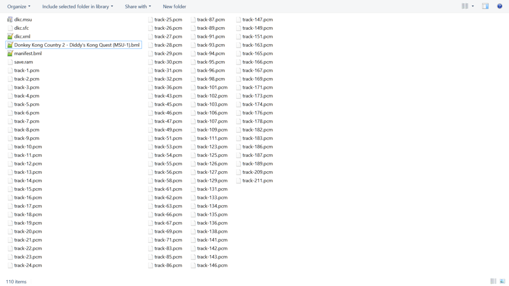

kylecp1979 Posted October 9, 2016 Posted October 9, 2016 As soon as I read your post I tried running some, I remember some games had to be edited, actually I edited some BML files in notepad++. Open your Donkey Kong Country 2 bml file with any note editor and check its contents Mine looks like this cartridge region=NTSC rom name=dkc.sfc size=0x400000 ram name=save.ram size=0x800 map id=rom address=00-3f,80-bf:8000-ffff map id=rom address=40-7f,c0-ff:0000-ffff map id=ram address=20-3f,a0-bf:6000-7fff mask=0xe000 msu1 rom name=dkc.msu size=0x0000 map id=io address=00-3f,80-bf:2000-2007 information title: Donkey Kong Country 2 - Diddy's Kong Quest (USA) (En,Fr) (MSU-1) You need the bml file to have the database name entry, in this case I have Donkey Kong Country 2 - Diddy's Kong Quest (MSU-1).bml. Rocket Launcher will load this file which is a kind of cue file. Also, I'm posting a screenshot of my DK2 folder, check if you have the same contents as I do. I dont have any of those files in my folder Where would I find the rest of the files? All I have is the bml file
Aorin Posted October 9, 2016 Author Posted October 9, 2016 I dont have any of those files in my folder Where would I find the rest of the files? All I have is the bml file All you have is the bml file? It's just an index file, like a cue or xml, the MSU-1 games are big, something like 600+ mb per game. Aorin
