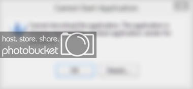

craiganderson Posted December 17, 2014 Posted December 17, 2014 Ok I have imagemagick and net installed inside the "simple wheel" folder when i click on the .exe file...nothing happens at all when i click on the .application file i get this any help is appreciated http://craigandersonthemes.weebly.com/

Trnzaddict Posted December 18, 2014 Posted December 18, 2014 Anybody? I really want to get this working.Thanks in advance. You are running the wrong exe Craig. Run the other one in the folder and it should boot. I am......Machine

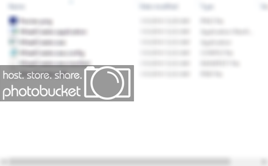

craiganderson Posted December 18, 2014 Posted December 18, 2014 thanks for the response here is what my folder has in it i have tried them all...and get nothing .... except what i posted above after i installed the "net" and the "imagemagick" programs...do i need to do anything with them? i didnt do anything other than install them. http://craigandersonthemes.weebly.com/
