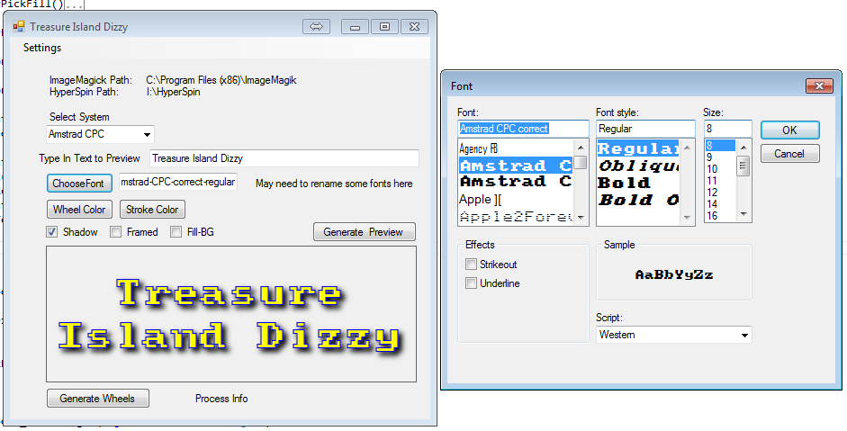

horseyhorsey Posted December 4, 2013 Author Posted December 4, 2013 Nah. I didn't bother Quick & dirty way of updating my wheels without asking people to do them for me. http://www.imagemagick.org/Usage/text/ It may just be easier to add a text edit so you can manually put in your command line and hit the preview to see result then batch them off. Weed Me! HS App: HLM-Check Beta: PinXCheckTunes: http://soundcloud.com/vade/mistys-mind-horse-mix HyperSpin Multiplayer - Take Your Cab online

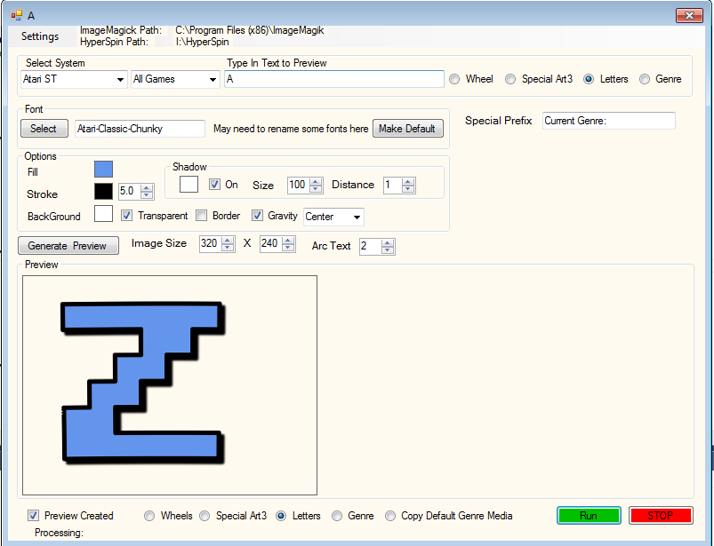

horseyhorsey Posted December 7, 2013 Author Posted December 7, 2013 Just upped a new version. Can batch off your special Art 3 genres , which is the " Current Gene: Horse Racing Games". Remove or add prefix. Run/Stop Background Worker Buttons Batch off the letters. Added a few more options: Strokes, arc text, shadowing I'm pretty sure I have the new ftp so hopefully you can find it. One note: Make sure you have the font text in the edit box before you click preview or run. Imagemagick will hang otherwise. This is only really for the first run. ToDO: Tidy it up a bit Add option to copy a base image genre & wheel folder to a Hyperspin = Spent enough time manualy doing this in the past Implement genre wheel batch. User Presets More fancier image options Weed Me! HS App: HLM-Check Beta: PinXCheckTunes: http://soundcloud.com/vade/mistys-mind-horse-mix HyperSpin Multiplayer - Take Your Cab online
brolly Posted December 7, 2013 Posted December 7, 2013 horsey I think it would be nice if you could add an option to show the actual command line being sent to IM. This way you can use that as a starting point if you want to tweak some extra settings by yourself.
horseyhorsey Posted December 7, 2013 Author Posted December 7, 2013 horsey I think it would be nice if you could add an option to show the actual command line being sent to IM. This way you can use that as a starting point if you want to tweak some extra settings by yourself. I did have a text box for this but removed it. Will find some room for a new one or window. Cheers. Weed Me! HS App: HLM-Check Beta: PinXCheckTunes: http://soundcloud.com/vade/mistys-mind-horse-mix HyperSpin Multiplayer - Take Your Cab online
