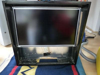

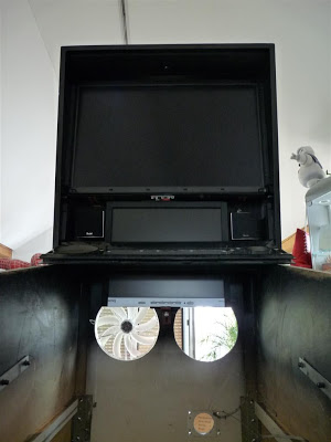

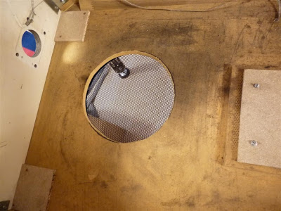

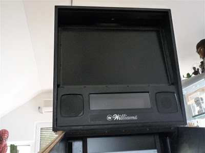

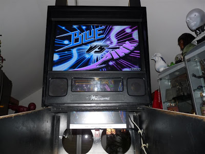

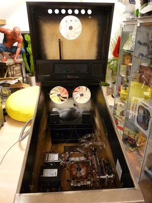

chriz99 Posted October 15, 2009 Author Posted October 15, 2009 next steps: mounted the 30" lcd screen today. it fits perfectly to the backbox. i made a hole for the subwoofer (covered with mesh) subwoofer, pc-board and wpc95 speakerpanel greets chris cheers chris [sIGPIC][/sIGPIC] * taito egret 29 candy cabs * indy & star wars pachinkos 17" bartop with ledwiz rgbleds * 10" bubble bobble & galaga bartop * arm champs 2 check out hi-res backglasses * best vpin performance * ledwiz config and software
brodzowski Posted October 15, 2009 Posted October 15, 2009 Love that backglass monitor! I wanted to fill up as much of the backbox as I could and that looks great!

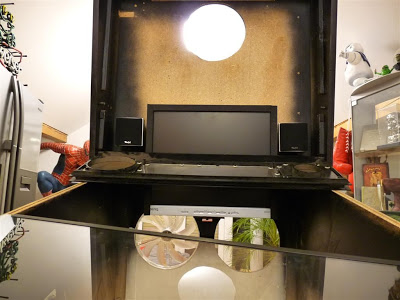

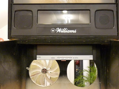

chriz99 Posted October 16, 2009 Author Posted October 16, 2009 mounted the 19" lcd screen... greets chris cheers chris [sIGPIC][/sIGPIC] * taito egret 29 candy cabs * indy & star wars pachinkos 17" bartop with ledwiz rgbleds * 10" bubble bobble & galaga bartop * arm champs 2 check out hi-res backglasses * best vpin performance * ledwiz config and software
brodzowski Posted October 16, 2009 Posted October 16, 2009 It's like you're reading my mind. Where did you come up with the William's bezel? Like it. I've got parts ordered. Looking forward to getting some of them next week. EDIT Bah! Disregard my stupidness plz. I keep forgetting that you're fitting to an existing cab. I don't have that luxury, but I sure am enjoying your post!
Rawd Posted October 16, 2009 Posted October 16, 2009 That's looking really nice man. I also like your Williams bezel, did you make that yourself? It will be sweet with that huge backglass and third screen.
chriz99 Posted October 17, 2009 Author Posted October 17, 2009 the "blank" williams bezel comes from wpc95-generation pinballs. i bought it at a pinball-forum. greets chris cheers chris [sIGPIC][/sIGPIC] * taito egret 29 candy cabs * indy & star wars pachinkos 17" bartop with ledwiz rgbleds * 10" bubble bobble & galaga bartop * arm champs 2 check out hi-res backglasses * best vpin performance * ledwiz config and software

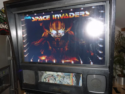

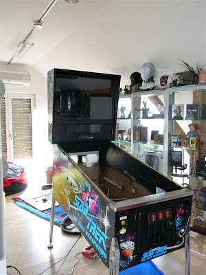

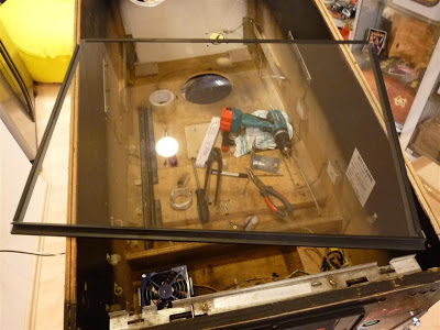

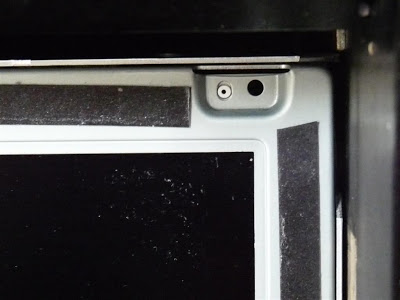

chriz99 Posted October 18, 2009 Author Posted October 18, 2009 painted the metalframe of the 30" lcd screen. the screen is invisible now... without glass: with glass: greets chris cheers chris [sIGPIC][/sIGPIC] * taito egret 29 candy cabs * indy & star wars pachinkos 17" bartop with ledwiz rgbleds * 10" bubble bobble & galaga bartop * arm champs 2 check out hi-res backglasses * best vpin performance * ledwiz config and software

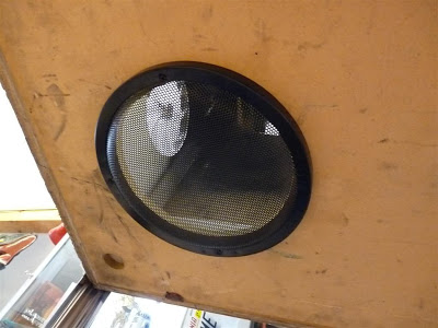

lagwag0n Posted October 19, 2009 Posted October 19, 2009 chriz99, good work man. I have a few questions of you if you don't mind: 1. Where did you get that mesh speaker insert? I like those 2. Do you mind sharing your back box dimensions. I am going with the same exact setup. 19" monitor for DMD and 30" for the backglass. 3. What did you use to mount the 19" lcd? THanks in advance.
chriz99 Posted October 19, 2009 Author Posted October 19, 2009 no probs, look for "speaker mesh grills" on ebay. there are several sizes available. the backbox has standard measurements of 27" by 27" (inside) and the 19" lcd is mounted via 3 adjustable mounting angles/brackets. greets chris chriz99, good work man. I have a few questions of you if you don't mind:1. Where did you get that mesh speaker insert? I like those 2. Do you mind sharing your back box dimensions. I am going with the same exact setup. 19" monitor for DMD and 30" for the backglass. 3. What did you use to mount the 19" lcd? THanks in advance. cheers chris [sIGPIC][/sIGPIC] * taito egret 29 candy cabs * indy & star wars pachinkos 17" bartop with ledwiz rgbleds * 10" bubble bobble & galaga bartop * arm champs 2 check out hi-res backglasses * best vpin performance * ledwiz config and software

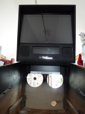

chriz99 Posted October 19, 2009 Author Posted October 19, 2009 first test setup (19" + 30") greets chris cheers chris [sIGPIC][/sIGPIC] * taito egret 29 candy cabs * indy & star wars pachinkos 17" bartop with ledwiz rgbleds * 10" bubble bobble & galaga bartop * arm champs 2 check out hi-res backglasses * best vpin performance * ledwiz config and software
lagwag0n Posted October 19, 2009 Posted October 19, 2009 the 19" lcd is mounted via 3 adjustable mounting angles/brackets. Thanks for the info. Do you have a picture of one of these or a link to a shop that has them.

lagwag0n Posted October 20, 2009 Posted October 20, 2009 Thanks again. One more question, how tall is your Williams bezel section? I am trying to figure out how high to go on mine, although it will be all wood.
chriz99 Posted October 20, 2009 Author Posted October 20, 2009 the bezel is 8.5" tall Thanks again. One more question, how tall is your Williams bezel section? I am trying to figure out how high to go on mine, although it will be all wood. cheers chris [sIGPIC][/sIGPIC] * taito egret 29 candy cabs * indy & star wars pachinkos 17" bartop with ledwiz rgbleds * 10" bubble bobble & galaga bartop * arm champs 2 check out hi-res backglasses * best vpin performance * ledwiz config and software

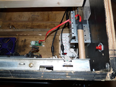

chriz99 Posted October 20, 2009 Author Posted October 20, 2009 nanotech plunger mounted: greets chris cheers chris [sIGPIC][/sIGPIC] * taito egret 29 candy cabs * indy & star wars pachinkos 17" bartop with ledwiz rgbleds * 10" bubble bobble & galaga bartop * arm champs 2 check out hi-res backglasses * best vpin performance * ledwiz config and software

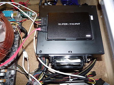

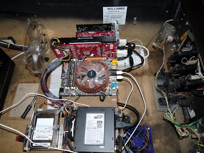

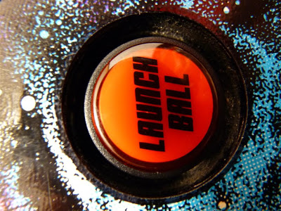

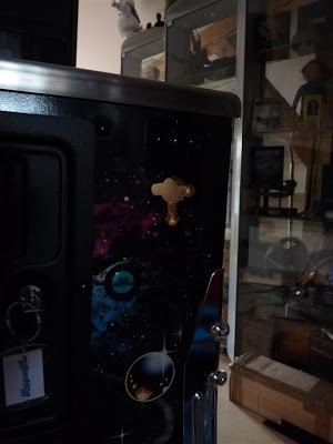

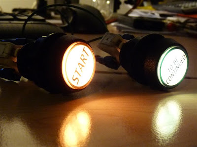

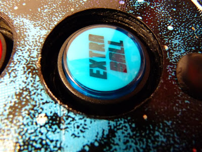

chriz99 Posted October 28, 2009 Author Posted October 28, 2009 small update: hyperpin buttons, first test with photoshop --> plunger protection: installed a solid state disk, everything is fast and silent. nudging should be no problem now greets chris cheers chris [sIGPIC][/sIGPIC] * taito egret 29 candy cabs * indy & star wars pachinkos 17" bartop with ledwiz rgbleds * 10" bubble bobble & galaga bartop * arm champs 2 check out hi-res backglasses * best vpin performance * ledwiz config and software

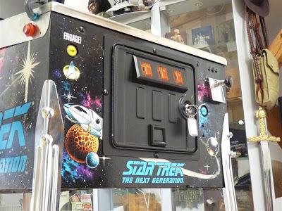

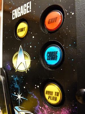

chriz99 Posted October 29, 2009 Author Posted October 29, 2009 today I received the buttons and plotted the inlays (on self adhesive foil) greets chris cheers chris [sIGPIC][/sIGPIC] * taito egret 29 candy cabs * indy & star wars pachinkos 17" bartop with ledwiz rgbleds * 10" bubble bobble & galaga bartop * arm champs 2 check out hi-res backglasses * best vpin performance * ledwiz config and software
tagi3d Posted October 30, 2009 Posted October 30, 2009 looking good man! you're so close to being finished! how much was that SSD? ---- Follow along my Visual Pinball project here: http://pinacolada.danielpotter.com
chriz99 Posted October 30, 2009 Author Posted October 30, 2009 thanks tagi3d, the ssd comes from super talent and costs about 100 bucks. its the 32gb version (should be enough space for everything if you use winXP) bootup time, table loading, hyperpin browsing... everything is just awesome. no noise and ready for nudging. i would never go back to a normal hdd. looking good man! you're so close to being finished! how much was that SSD? cheers chris [sIGPIC][/sIGPIC] * taito egret 29 candy cabs * indy & star wars pachinkos 17" bartop with ledwiz rgbleds * 10" bubble bobble & galaga bartop * arm champs 2 check out hi-res backglasses * best vpin performance * ledwiz config and software

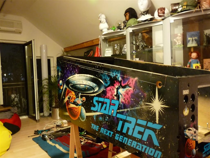

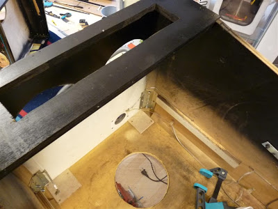

chriz99 Posted November 1, 2009 Author Posted November 1, 2009 ready to transport for milling, hope everything will fit... greets chris cheers chris [sIGPIC][/sIGPIC] * taito egret 29 candy cabs * indy & star wars pachinkos 17" bartop with ledwiz rgbleds * 10" bubble bobble & galaga bartop * arm champs 2 check out hi-res backglasses * best vpin performance * ledwiz config and software
