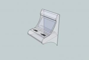

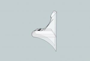

haimbilia Posted July 31, 2016 Posted July 31, 2016 finally gonna have time this month to get back to hyperspin and doing a project i have been planning for years now. the plan is to have the cabinet wall mounted to save space something like this: only with less sharp edges. i made a sketchup model of roughly what i want: also i ordered this kit, a trackball, and some extra buttons. i know it's a cheap chinese crap but im on a tight budget. the pc is an old i3 first gen with an r9 290 i have. i also ordered this amp so i can hook up some nice speakers. i will try to update as i go... also gonna get back to helping xALPHAxOMEGAx with he's project and im about 80% finished with the WSC cartridges. so good things are coming.

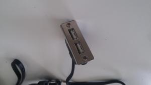

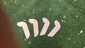

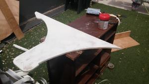

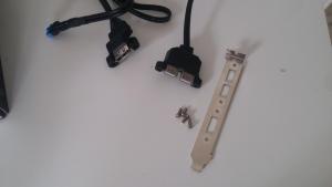

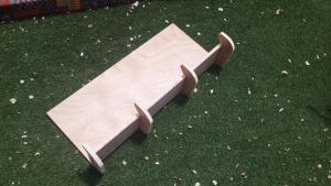

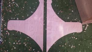

haimbilia Posted August 1, 2016 Author Posted August 1, 2016 here are the side panels: with wood filler: i also want to have a couple usb ports on the side so i modified this internal esata-usb thingy i had laying around: the front of the controls will be the hardest thing to as i want it to be curved, i still don't know if i will use a thin sheet of plywood soak it in water and then try to bend it or maybe just go with soft pvc plastic. anyway here are the ribs that will form the curvature: and here it is with the control panel (its upside down): i cut it all with a jigsaw cuz thats what i have so i have a lot of sanding to do.

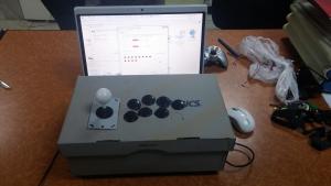

haimbilia Posted August 4, 2016 Author Posted August 4, 2016 i got the joystick and buttons, they work as expected, didn't have any problems setting this up, the feel and quality is ok, i tried on a shoe box to get a feel for the array.
richie_jones Posted August 4, 2016 Posted August 4, 2016 Nice..how do you rate the joysticks?.. Sent from my SM-N910F using Tapatalk

madhatter3339 Posted August 5, 2016 Posted August 5, 2016 if you want to bend the wood you have to use a steamer! Look it up its a lot of work to setup for larger pieces but you can make a steamer fairly cheap but you also need a form you can clamp it onto to hold the form you want!!
haimbilia Posted August 5, 2016 Author Posted August 5, 2016 Nice..how do you rate the joysticks?.. Sent from my SM-N910F using Tapatalk well i have nothing to compare it to, so you shouldn't take my word but it works fairly well, no noticeable lag and the diagonals are fairly easy to reach. i would say the travel distance is a bit to short for my taste but it's something many people like. madhatter3339 - yes i been researching about it and its seem straight forward i still haven't got to that part, i will update my success/failure when i get to it. there is also the method of soaking the wood in warm water and it should work fine on thin plywood i guess i will have to try and learn.
