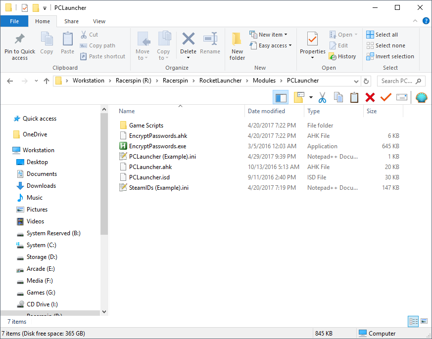

Now Navigate to your Rocketlauncher Folder, then modules and finally PC Launcher.

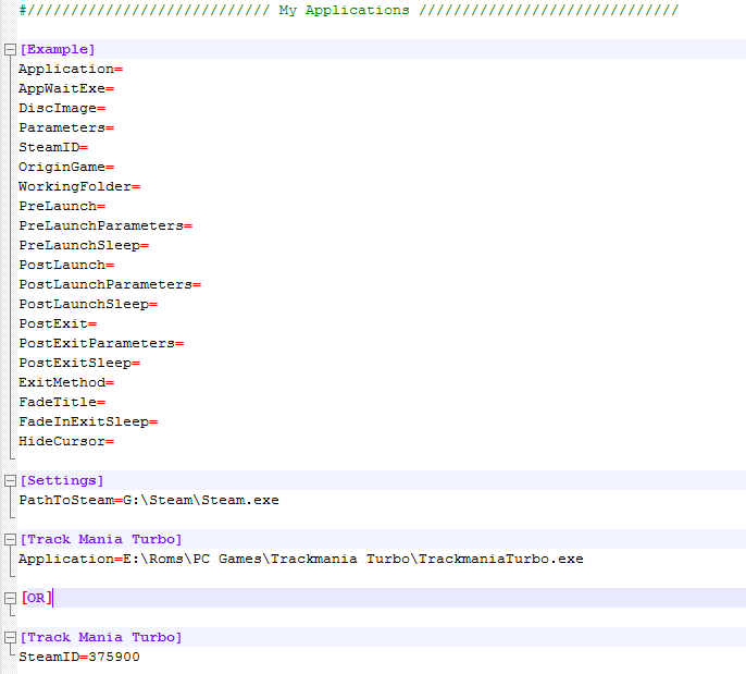

Rename the PCLauncher (Example).ini file to just PCLauncher.ini removing the (Example).
Then Open it.
You can choose now to remove all the current information in there like the below example or just leave it and start adding more.
As you can see in the above there are some different ways you can launch your games.
You can either add the full path to the exe or bat file or you can use the SteamID if you have your game installed via steam.

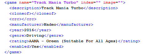

Just be sure to set the correct paths above and also the same name (Case Sensitive) as the games name in your Hyperspin Database XML.

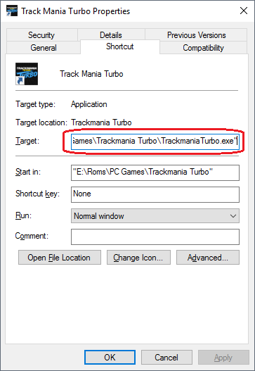

Hint: To get the path of your games easily you can copy the path from Desktop Shortcuts or Start Menu shortcuts if you properties and copy the path. Be sure however to remove the "".
