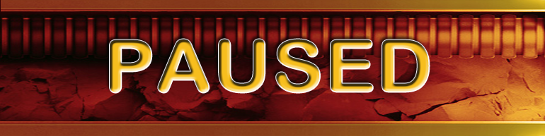

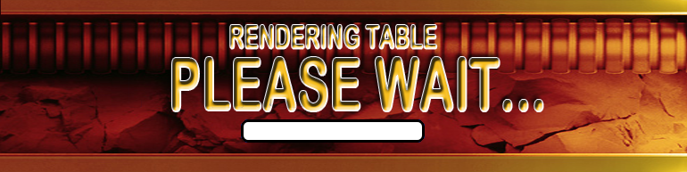

zebulon Posted August 10, 2011 Posted August 10, 2011 Hey Blur, quick question for you. I've modified my loading screen with a newer graphic and wondered if there is a way to change the progress bar color to Maroon (80000) I've been through the progress bar part of the script a batch of times and can't seem to find the current reference to blue (current color). Thanks I know so much about so little that I could teach you everything there is to know about nothing....
samwyze Posted August 10, 2011 Author Posted August 10, 2011 (edited) Hey Blur, quick question for you.I've modified my loading screen with a newer graphic and wondered if there is a way to change the progress bar color to Maroon (80000) I've been through the progress bar part of the script a batch of times and can't seem to find the current reference to blue (current color). Thanks In 1.295wip3 it's line 575: Gui, Add, Progress, x%xLoadProgress% y%yLoadProgress% w%wLoadProgress% h%hLoadProgress% -smooth 0x8 c0C32A5 vLoading vertical BackgroundFFFFFF change to: Gui, Add, Progress, x%xLoadProgress% y%yLoadProgress% w%wLoadProgress% h%hLoadProgress% -smooth 0x8 c80000 vLoading vertical BackgroundFFFFFF and recompile. Also if you want to change background colour you can (you can see it's currently white(FFFFFF) Any chance you can post gfx here? Had a thought it might be good to collect them - perhaps start a new thread for custom fplaunch gfx but not sure who uses them. Edited August 10, 2011 by samwyze
zebulon Posted August 11, 2011 Posted August 11, 2011 In 1.295wip3 it's line 575:Gui, Add, Progress, x%xLoadProgress% y%yLoadProgress% w%wLoadProgress% h%hLoadProgress% -smooth 0x8 c0C32A5 vLoading vertical BackgroundFFFFFF change to: Gui, Add, Progress, x%xLoadProgress% y%yLoadProgress% w%wLoadProgress% h%hLoadProgress% -smooth 0x8 c80000 vLoading vertical BackgroundFFFFFF and recompile. Also if you want to change background colour you can (you can see it's currently white(FFFFFF) Any chance you can post gfx here? Had a thought it might be good to collect them - perhaps start a new thread for custom fplaunch gfx but not sure who uses them. Awesome, thanks Sam. I looked at that line but the color code didn't match any of the reference codes I had so I thought it best to leave that alone. Here's those pics..... I know so much about so little that I could teach you everything there is to know about nothing....

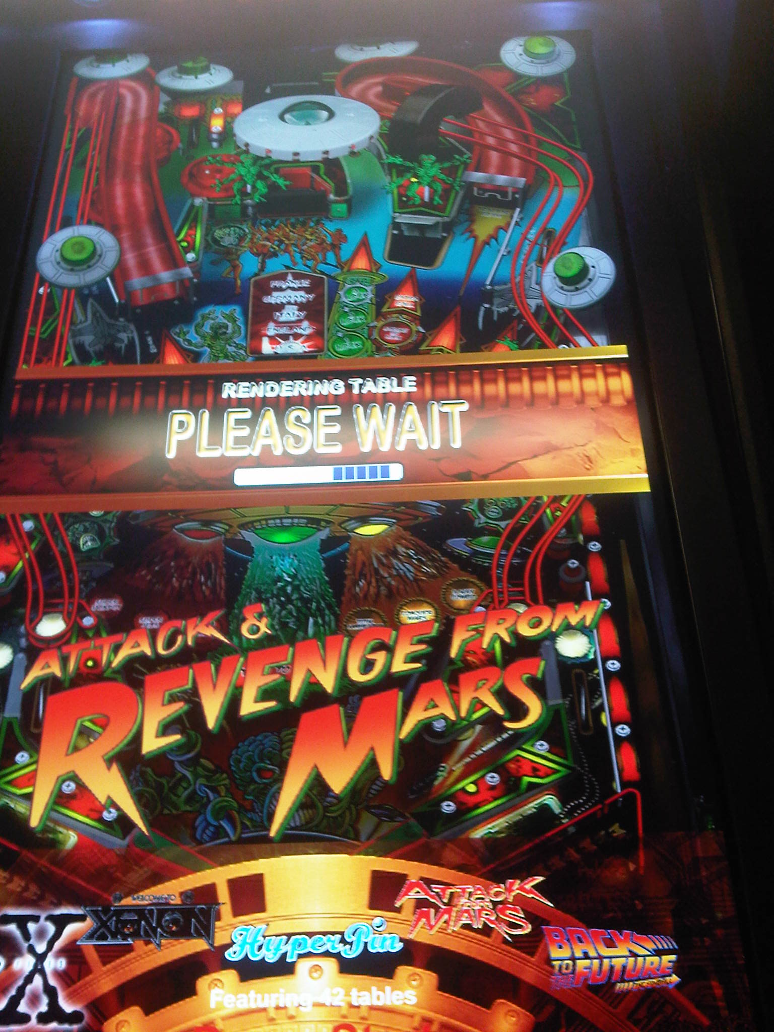

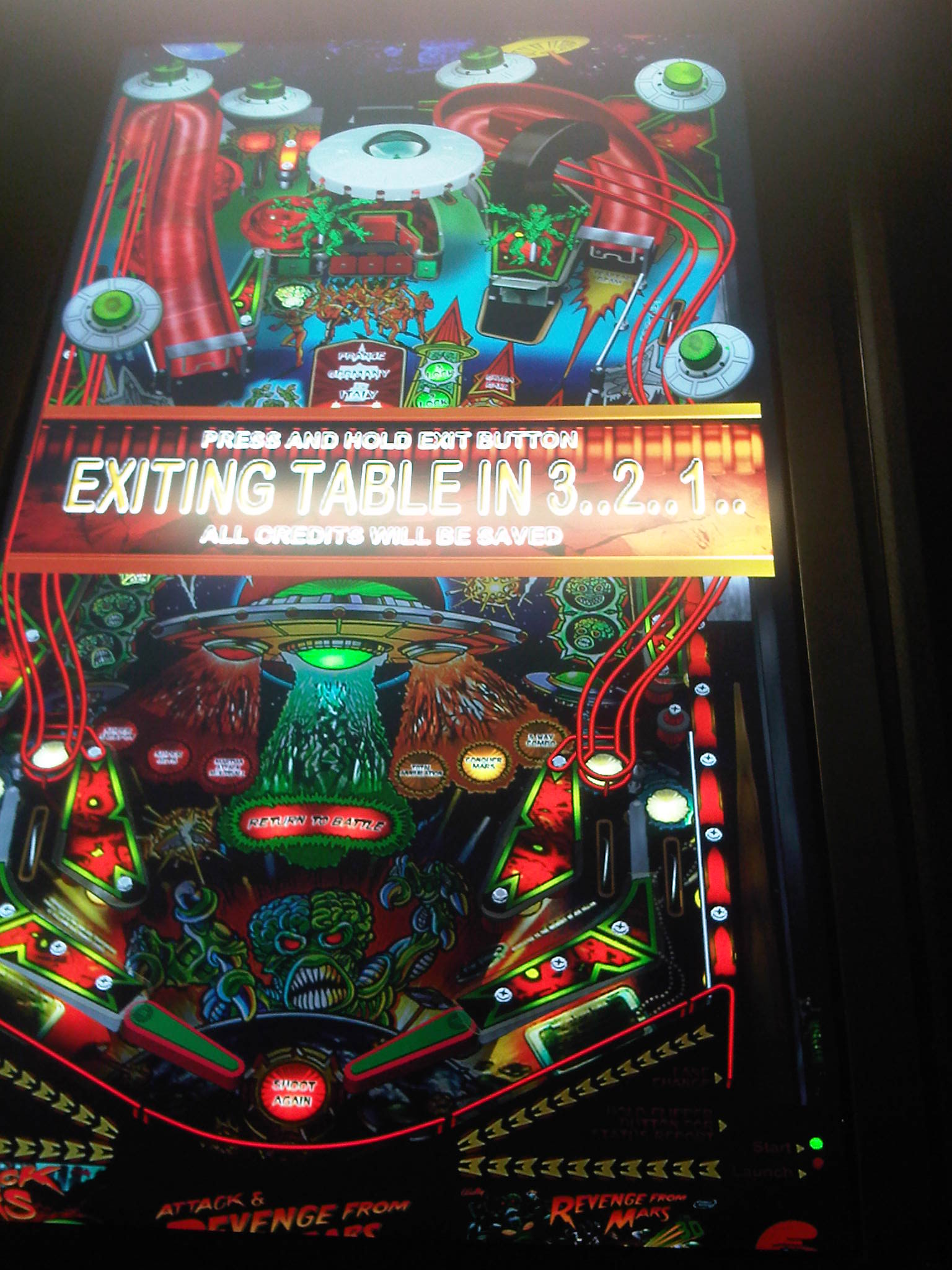

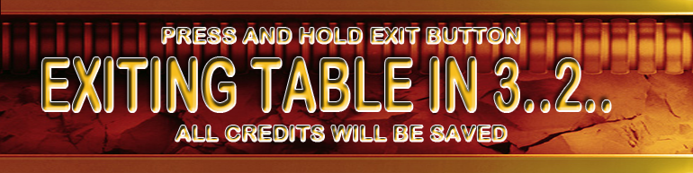

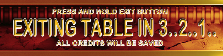

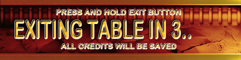

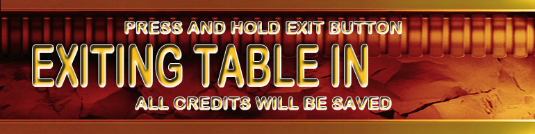

zebulon Posted August 11, 2011 Posted August 11, 2011 Not to derail the thread, but here's some pics of the end result...well until I modify the .ahk I know so much about so little that I could teach you everything there is to know about nothing....
Darkfall Posted August 11, 2011 Posted August 11, 2011 That looks awesome, Zeb! ...Paul Check out Wildfire Pinball's build details here: Project Wildfire
Numiah Posted August 11, 2011 Posted August 11, 2011 Pretty neat ! Makes me wonder all of a sudden if the Hyperpin menu's can be modded as well... Hmmm.. **Each pinball machine is a tiny universe... that we control** My Build Overview My Computer Specifications
samwyze Posted August 11, 2011 Author Posted August 11, 2011 Very nice lets get a bunch posted so we can release them as options...if you don't mind of course! Any other gfx peeps out there wana share? Sent from my Ideos using Tapatalk
zebulon Posted August 11, 2011 Posted August 11, 2011 Thanks Guys, Sam, I tried the modification you gave me for the progress bar but the color remained blue. Is it possible that it's being overwritten by the default color of the hyperpin menu?(speaking of which, anyone know if it's possible to change that? I think it's called screen.bmp) I know so much about so little that I could teach you everything there is to know about nothing....
samwyze Posted August 11, 2011 Author Posted August 11, 2011 Did you recompile the ahk script? I remember playing with it before I decided to mimic hyperpin gfx, so it should work.
zebulon Posted August 12, 2011 Posted August 12, 2011 I made a copy, edited and recompiled it and it looks the same (blue progress bar). It's not a big deal, so I haven't put any further attempt into it. I'll try it again tomorrow. For all I know, I may not have renamed it properly (although I'd expect an error in launching). I know so much about so little that I could teach you everything there is to know about nothing....
samwyze Posted August 12, 2011 Author Posted August 12, 2011 Gui, Add, Progress, x%xLoadProgress% y%yLoadProgress% w%wLoadProgress% h%hLoadProgress% [color="Red"]-smooth[/color] 0x8 c80000 vLoading vertical BackgroundFFFFFF Just had another look at it - when you force it to use segments it defaults to xp classic theme colours. Get rid of the minus smooth option and you should be ok
zebulon Posted August 12, 2011 Posted August 12, 2011 Will give it a try, thanks Sam! I know so much about so little that I could teach you everything there is to know about nothing....
zebulon Posted August 13, 2011 Posted August 13, 2011 Nope, any modification to the script, recompile and replacement of the .ahk and .exe causes it to lock into a loop and freeze until I bring up the task manager and bring the focus back to hyperpin.exe. It's fine as it is, I'm just getting picky is all. Thanks for the assistance Sam!! I know so much about so little that I could teach you everything there is to know about nothing....
samwyze Posted August 13, 2011 Author Posted August 13, 2011 Nope, any modification to the script, recompile and replacement of the .ahk and .exe causes it to lock into a loop and freeze until I bring up the task manager and bring the focus back to hyperpin.exe.It's fine as it is, I'm just getting picky is all. Thanks for the assistance Sam!! Thats very odd - only thing I can think of is that it's not recompiling properly. Are you using ahk standard (older version) or ahk L (newer version) I think the script is using ahk standard (although blur will need to confirm) which could cause the issue.
zebulon Posted August 13, 2011 Posted August 13, 2011 Autohotkey_L...upgraded to the latest version. Tried with the standard version !st. Process: - edited (changed color value only) wip3, recompiled, forgot about copying over the .exe, worked with no change (obviously) -edited wip3 (changed color value only), recompiled, moved over .exe and .ahk, worked with no change -edited wip3 (removed -smooth), recompiled, moved over .exe and .ahk, looped -edited wip4 (changed color value only), recompiled, moved over .exe and .ahk, looped -edited wip4 (removed -smooth), recompiled, moved over .exe and .ahk, looped -edited wip4 (replaced both vales), recompiled, moved over .exe and .ahk, looped -updated autohotkey to latest version, tried again, looped If I even recompile without editing, it loops. Dunno, obviously there's a problem with my autohotkey installation or a conflict in the output. I know so much about so little that I could teach you everything there is to know about nothing....
