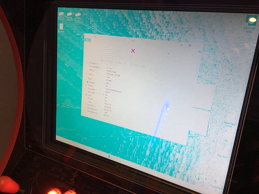

gunit Posted July 7, 2019 Author Posted July 7, 2019 This is what happens in Hyperspin when playing or in windows when testing the Emulator.
Spawk Posted July 7, 2019 Posted July 7, 2019 Do you use esc as your exit key? I just had a quick look at the module settings. There is not a spot to choose resolution but there is a spot to choose "windowed fullscreen". Also the exit mode can be changed which may or may not help. To get there go to the Modules tab in RLUI, highlight AAE, and then click the "edit global module settings" button along the top. There are not a lot of options for this particular system but other systems have a lot of useful settings in here.
Spawk Posted July 7, 2019 Posted July 7, 2019 10 minutes ago, gunit said: This is what happens in Hyperspin when playing or in windows when testing the Emulator. Yes I've seen this type of thing before. Usually colour bit change or it doesn't like to switch between certain resolutions. Maybe it doesn't like to be windowed??? The AAE module notes that true fullscreen is not compatible with pause so...
gunit Posted July 7, 2019 Author Posted July 7, 2019 5 minutes ago, Spawk said: Do you use esc as your exit key? I just had a quick look at the module settings. There is not a spot to choose resolution but there is a spot to choose "windowed fullscreen". Also the exit mode can be changed which may or may not help. To get there go to the Modules tab in RLUI, highlight AAE, and then click the "edit global module settings" button along the top. There are not a lot of options for this particular system but other systems have a lot of useful settings in here. no good, did look at this. I reckon its something to do with Windows 10
