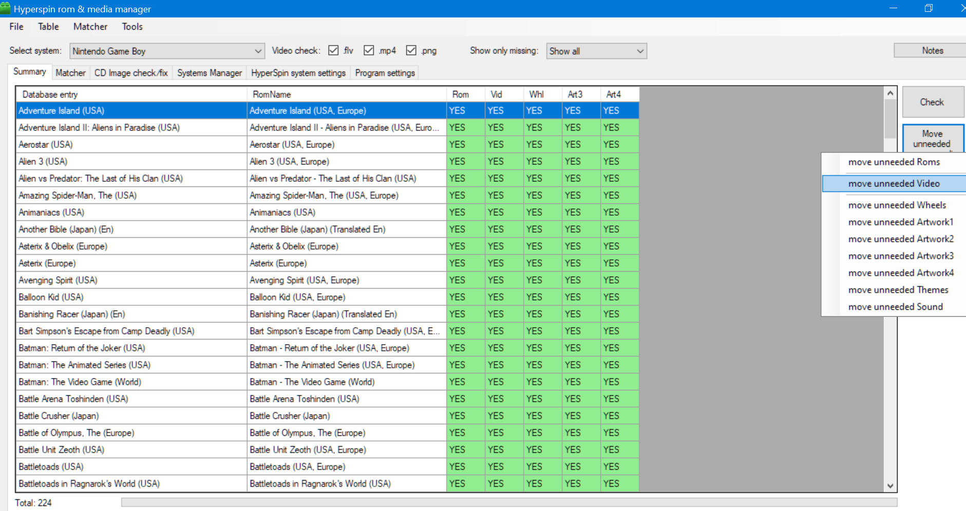

32assassin Posted January 2, 2021 Posted January 2, 2021 I used this method 1. Use Dons tools to create an XML that only contains the games you have 2. use this https://emumovies.com/files/file/1174-hyperspin-asset-xml-audit/ it will move any file not found in your XML to a sub folder ( this is why step 1 is important)
thatman84 Posted January 2, 2021 Posted January 2, 2021 I believe HyperTools or Hyperspin Checker in the 3rd Party apps section has a feature to move unneeded files out. its been a year since I audited a download pack and forget exactly which one of those apps does it but it is very easy in one of those tools Hyperspin 2.0 Latest Download Hyperspin 2.0 Documentation -------Pre Hyperspin 2.0 Below---------- HS Android Overview & Install HS Android Base Pack Download My Tutorials
Aorin Posted January 3, 2021 Posted January 3, 2021 Yes, HyperspinChecker is what I use for that and other stuff, really simple. Aorin
