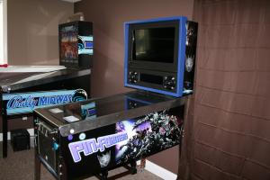

Showing off some custom artwork I created for a member on the forum for his upcoming build. The yellow line in the drawing is his Ginormous 3" siderails!!! This is designed for an old Playboy Machine he gutted. Gave me free reign on the design based on the movie Transformers. Hard to see but Optimus is firing a pinball :)

Looks great!!! Oh wait, those are mine! Seriously though, Brad does fantastic work and I CANNOT WAIT to get these on the machine. I think I'm more excited to have a cool looking cab then to actually play the game!!
Again big props to Brad!
-Lyle

Nice. Can't wait to see the final build. Is there backbox art as well? Nice touch with Optimus firing a pinball. Too bad it's not G1 with Megatron blasting one out of his arm cannon....
The side pieces showing Optimus and Megatron are the sides fo the back box. He had a unique backbox because of the age of the original machine.
Thanks Numiah for the compliment! Still working on my Photoshop skills but for 2-3 hours worth of work I think it's pretty decent. I have mastered Illustrator, but some things are easier to accomplish in Photoshop. :)

My artwork was delivered today and it looks great. Many thanks to Lucian, he did a great job with the printing. I would really recommend him to anyone else looking to get their artwork printed. :top:
Thanks DeeGor, your artwork design was top notch, files were perfect. Looking forward to seeing the final build.
