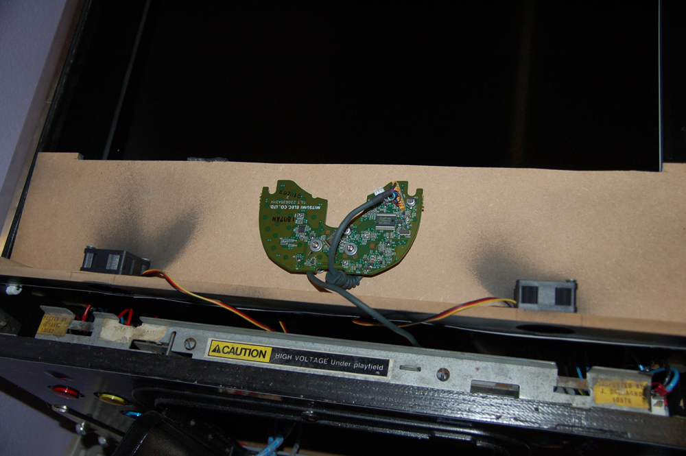

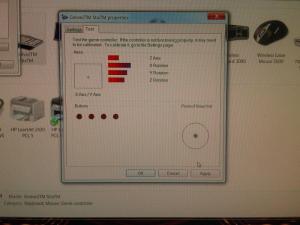

pixelmagic Posted October 28, 2011 Posted October 28, 2011 I put mine in yesterday after talking with gustav, but i wanted the analog withoud xpadder. I ended up mounting it like this under my apron: The calibrating was a bit of a problem, but after reading and exactly doing this it works like a charm !! [TABLE=width: 500] [TR] [TD][/TD] [TD=align: center]New project homepage: http://blog.pixelmagic.nl/[/TD] [TD][/TD] [/TR] [TR] [TD][/TD] [TD=align: center]LED-Wiz utility: http://pinball.pixelmagic.nl/ledwiz/[/TD] [TD][/TD] [/TR] [TR] [TD][/TD] [TD=align: center]Anyone want to buy my LEDwiz ?? [/TD] [TD][/TD] [/TR] [/TABLE]
wierdo Posted October 28, 2011 Posted October 28, 2011 The calibrating was a bit of a problem, but after reading and exactly doing this it works like a charm !! For some reason, when I do it that way, mine ends up drifting back out of calibration pretty quickly. I picked up a GPS mount earlier. Hopefully that will make it easier to get it centered properly.
DeeGor Posted October 29, 2011 Posted October 29, 2011 Here is how I mounted my gamepad. No calibration was really needed. I just launched xpadder, centered the pad, tightened the GPS holder, set my deadzone to 9% and I was done. It works perfectly for me.

pinballlooking Posted November 3, 2011 Posted November 3, 2011 I put mine in yesterday after talking with gustav, but i wanted the analog withoud xpadder.I ended up mounting it like this under my apron: The calibrating was a bit of a problem, but after reading and exactly doing this it works like a charm !! What do you need to do to make it work analog? I would like to give that a try. My Pinball Cabinet:http://www.hyperspin-fe.com/forum/showthread.php?t=15290
wierdo Posted November 7, 2011 Posted November 7, 2011 What do you need to do to make it work analog?I would like to give that a try. Just make sure the PBW Accelerometer checkbox is ticked in the table options (on each and every table) if you're using the Microsoft pad with the latest VP9. Also, you'll want to disable Xpadder or similar so they don't send keypress events.

Usul Posted November 13, 2011 Posted November 13, 2011 I put mine in yesterday after talking with gustav, but i wanted the analog withoud xpadder.I ended up mounting it like this under my apron: The calibrating was a bit of a problem, but after reading and exactly doing this it works like a charm !! Erwin, apart from activating PBW Acc. did you change any of your vp physics settings like jolt, dead zone etc.? I keep playing around with those, following what was posted on vp forums, calibrated x times, but just can't get my sidewinder working correctly.... Thanks!

pixelmagic Posted November 14, 2011 Posted November 14, 2011 Erwin,apart from activating PBW Acc. did you change any of your vp physics settings like jolt, dead zone etc.? I keep playing around with those, following what was posted on vp forums, calibrated x times, but just can't get my sidewinder working correctly.... Thanks! I only have checked the 2 boxes in VP, nothing more. At the moment i have no real time to dig in it more, but the thing i know is that it looks like you have to recalibrate from time to time. Out of the blue it will start nudging when you launch a table. I am at the point where i disconnected the pad at the moment and will look in it later when i am done with some other stuff. [TABLE=width: 500] [TR] [TD][/TD] [TD=align: center]New project homepage: http://blog.pixelmagic.nl/[/TD] [TD][/TD] [/TR] [TR] [TD][/TD] [TD=align: center]LED-Wiz utility: http://pinball.pixelmagic.nl/ledwiz/[/TD] [TD][/TD] [/TR] [TR] [TD][/TD] [TD=align: center]Anyone want to buy my LEDwiz ?? [/TD] [TD][/TD] [/TR] [/TABLE]
