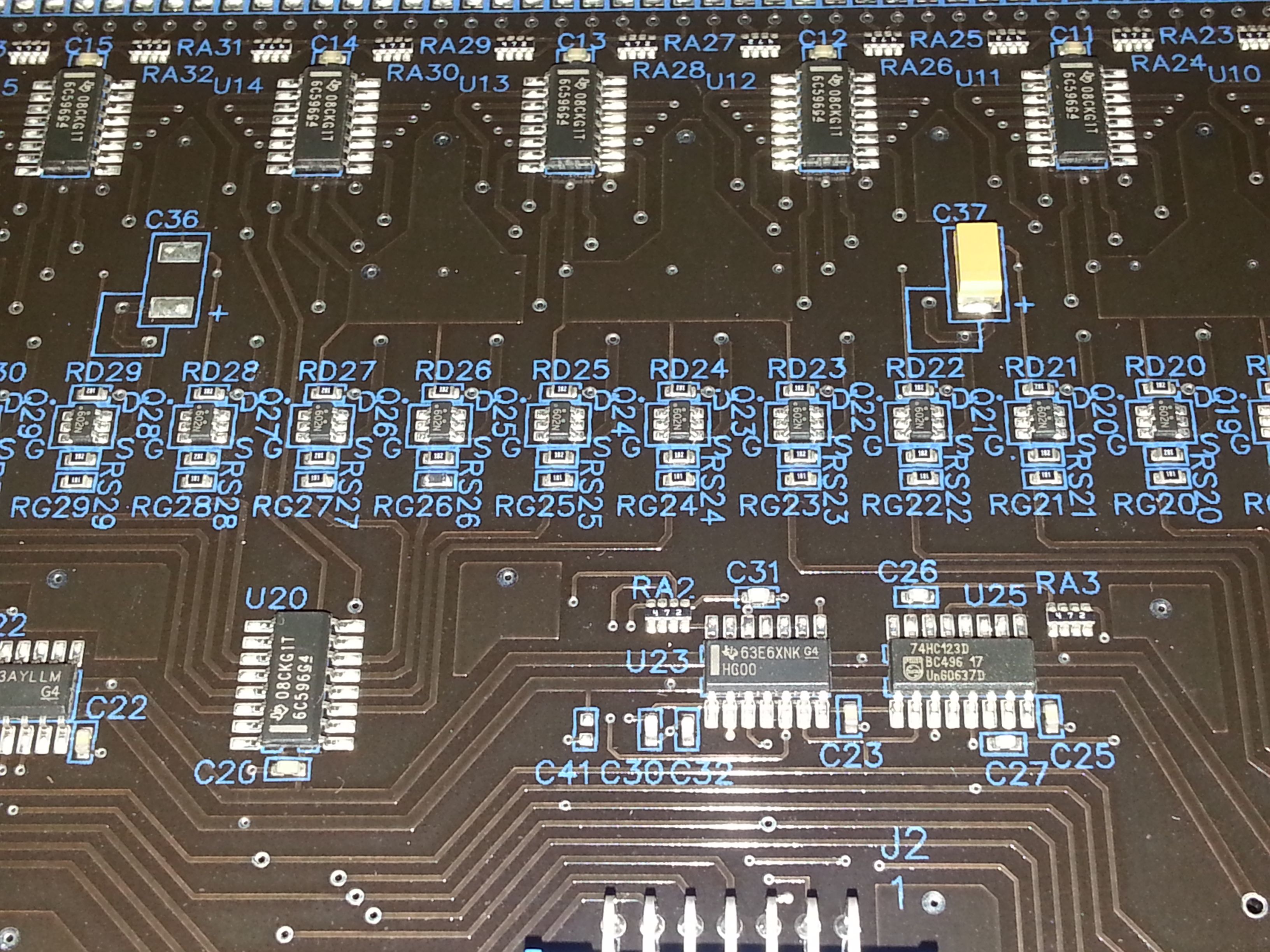

mikekim Posted April 18, 2013 Share Posted April 18, 2013 can anyone with a LEE-128G032-1 take a picture of the u23 chip on the back. I sent my dmd off to vishay in January for a rma and just got it back yesterday and its doing the same thing. After inspecting the board in looks as though a couple of pins are bridged and i wanted to compare to someone else's. Link to comment Share on other sites More sharing options...
russdx Posted April 18, 2013 Share Posted April 18, 2013 if no video is coming out id say its fried you really need an oscilloscope to check the io lines see if they are still working. Link to comment Share on other sites More sharing options...
